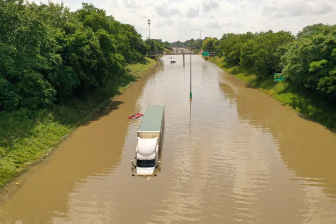

I-94 is still closed in Detroit. I guess building sunken highways that depend on having multiple functional electric pumps is a risky move in a city prone to vandalism and neglect.

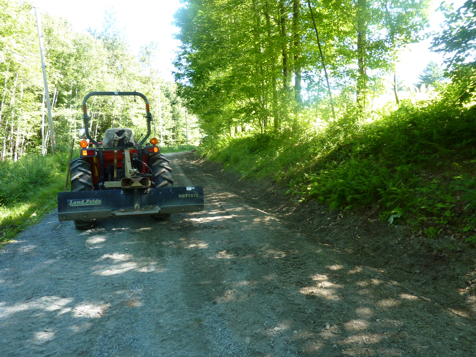

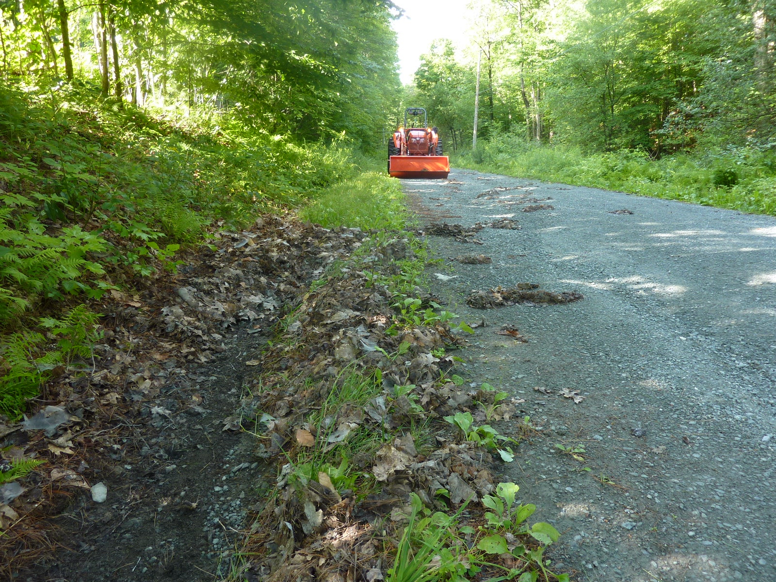

Did some roadwork on my one mile gravel road the last couple of weeks. Unfortunately, I don't have any "Before" pics, sorry. :(
Here are the "Before the Rock" pics showing how I widened the road, increased the natural slope from right to left and dug a small "ditch" down the left side. I couldn't dig the "ditch" any deeper due to hitting a rock shelf. :(
Here's a pic from further down, looking up. All those rocks on the right side? All were put there by me - by hand!

NICE! I hope you have enough drainage to avoid losing that rock when the next 6-10" rain hits. BTW how many tons/yards of rock did you have to buy, and what are prices like down there? Is that all clean stone, or some fines? (looks pretty clean).
A good dump truck driver (tailgate spreader) is worth their weight in gold.
When you "widened" the road, did you do it by cutting down? Kinda looks like a bathtub, hence my worry about drainage. But pics are hard to judge by sometimes.
   / 6" of Rain - Gravel Driveway Catastrophe #33
I probably will lose most of that rock, but that's ok, it's still better than a) running over it in the road or b) working to put it somewhere else.
I bought two tamdem dump truck loads, one for the hill and one for MH#3, with about 20% of load #2 going to a neighbor's driveway to fix their mud hole (no, it wasn't for Mr. Dick). Each load was 16-17 tons of fairly clear #67 and each cost $400.
Agree about a good dump truck driver. i won't hire anyone else for gravel or dirt work than Steve. Anyone in the north AL area need his expertise, PM me.
I widened the road by using my LMC box blade with a special scarifier on the right outside to break up the hard pan. Then I used my EA grader blade to move the loose dirt and rock from the left to the right, looking down the hill (or the first pic). It is a bathtub with very high sides, especially on the uphill side and both have lots of mature trees. Read $$$$$$ to "Fix". The only real way to drain water is to help it move the way it wants and that's going left and down and out.
