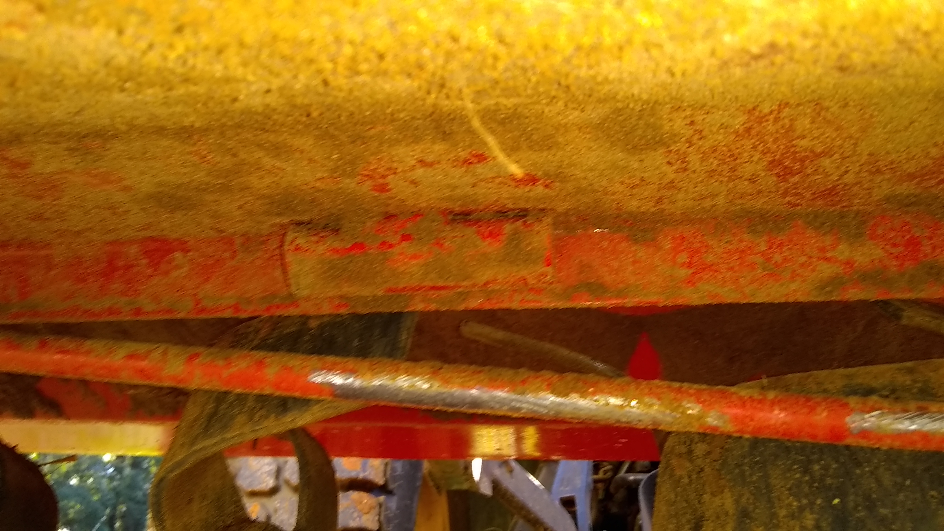

I ran into one other miscue on their part. They somehow manged to miss one of the loops when threading the rear flap hinge rod. I pulled up a root that caught in it and bent the rod. One of the tines was catching as it turned but luckily didn't grab it and wrap it around the shaft. I was actually able to straighten it enough to get the rod out, straighten it in the vise, and thread it back through properly.
Other than needing special attention to sort it out it has worked great. The last time I ran it I pulled up a pile of lighter knots and no damage occurred to the tiller.
