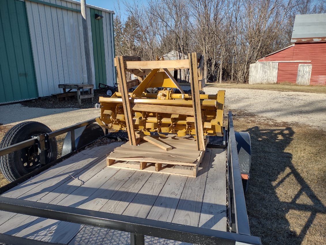

I couldn't find "a deal", or one that was close enough. I picked this King Kutter gear drive 5 footer up at Fleet Farm yesterday. The Deere will be running it. $2,499. Used ones online were $2k and/or they were 600 miles away. Came with a PTO shaft manual, but not one for the unit. I forgot to ask when I picked it up, so I printed one at home. Getting ahead of myself maybe, but the SIL said he was tired of renting - we needed one...

Nice tiller, I notice you wanted a 6' and got a 5', if it doesn't cover your rear wheels make sure it cover at least one of them and always do the laps on the opposite side so you have full tilling coverage... in order words, have the tiller to the left covering the left wheel and you next pass always do it to the right, or vise versa.

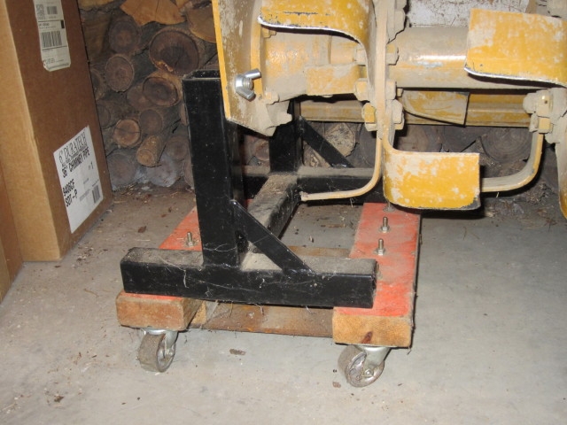

That is the tiller I have owned for many years. I took the skid shoes off as I didn't see a reason to have them. I fabbed up stands that bolt where the shoes bolted to so it sits nice in the shed.
Thanks. I got a quote from the local tractor implement place for a reverse tilling, chain drive Land Pride 66" unit - $3,900! I changed my mind on which tractor to use. My JD 855 is much newer, diesel, and probably better suited, and the 5 footer will cover the tracks. The D-17 has a Cat 2 hitch and I couldn't find a Cat 2 tiller or resolve that issued cheaply. I have a 9 foot chisel plow that I want to try with the D-17, for fun if nothing else. I'll get the SIL to take videos.
I did consider the Countyline brand from TSC, but they were not in stock and I saw too many "warning" videos about water in the new unit gear boxes.
