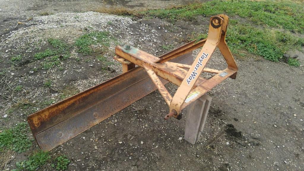

Hey all, just wanted to get your take... I bought a 6' Taylor-Way back blade off CL today. Paid $200. Paints peeled and it's got the usual outdoor kept surface rust... Besides wondering if the price was decent, is the 1720 able to push snow with that size blade? I was looking for a 60" when I found this. With yet another snow coming this weekend, I jumped. I have a 100' of asphalt drive, and a quarter mile of gravel to clear a path in.
decent price
looks fine
should work ok I have used one on my little B2150 without much trouble and your tractor has a teeny bit more power than that.
I do a 1/4 mile gravel driveway but pull forward with it angled as other reader said.
Anyway you already have it. Try it out and see how you like it.
Good luck you should be fine. If you are worried don't let much snow build up before you start dealing with it.
Depending on the type of snow you can turn the blade around and pull it forward and it won't hold as much snow.

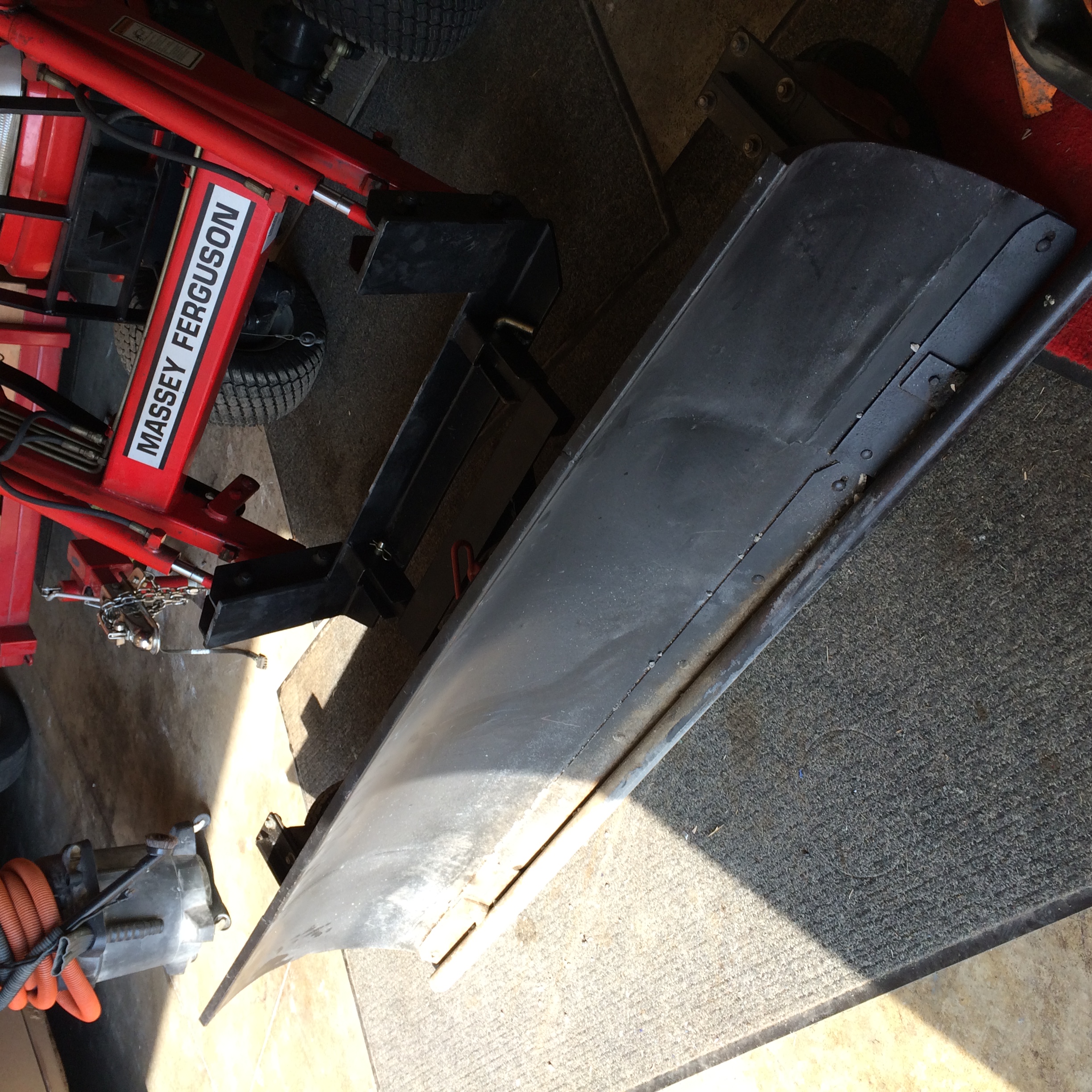

In my post prior to the one you highlighted, I indicated that I have a loader mounted plow.
   / 6' blade on my GC1720 ok? #16
Oh sorry
now it makes sense and the hoe should add a fair amount of weight for traction
looks like a good setup

Used the blade today! It worked amazingly well. Never felt underpowered. Pushed a couple neighbors drives too. I pushed backwards on the asphalt and drives. I pulled it on the gravel. Very impressed with the GC’s ability to control it! Most of all it was fun ��
