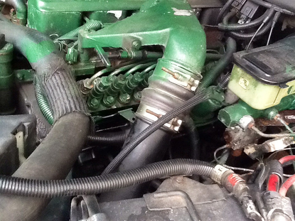

Couple of pictures under hood on my truck. Seem's like quite a bit of room. They may be upside down

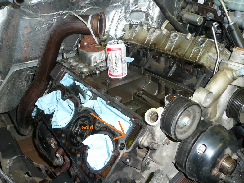

And btw, to FTG-05, and anyone else regarding anti-freeze. In your pic it looks like possibly dexcool? Or maybe just the camera or something changing its appearance? You never want to stray from the Ford Gold antifreeze. Allot of people skimp and put green or orange to save a few bucks. I'm sure there are some other formulations that may be the same, I'm no chemist. Like maybe the Dodge equivalent (Hoat G05), but I'm not sure, I just always use Ford Gold. If you would like, I can explain why. Or I can mind my own business, lol. Just an observation, but it CAN cause major damage over time
/ 6.0 Power Stroke Questions #32
I say explain away...
/ 6.0 Power Stroke Questions #34
Ok, I'll try not to ramble. On an old vehicle, you can put pretty much whatever you want in it. As long as you flush it out. You have a 98 chevy pickup, you want to put green in it to save a few bucks? Fine, but flush it good first. If you mix it with the factory dexcool, in a few months you will have what looks like chocolate pudding, and reduced coolant flow. Newer cars, not a good idea. If your new lexus calls for something specific, put it in there, even if its $100 a gallon. Because that $100 a gallon is probably the only thing that doesn't act like acid to a $1000 nasa space age metal alloy radiator or intake. It may look like plain ole aluminum, but don't bet on it.
So for that reason, you don't do it in a diesel either. 6.4's for example, have a habit of cavitating and eating out the front timing cover and dumping the coolant into the oil if the wrong coolant is used. Bad deal.
But on a diesel, the main reason is far more destructive. A diesel is a high compression motor. If you look at the last picture in FTG's post, you can see the rings around the tops of the cylinders. There are sleeves that go down through the block forming the cylinders, and surrounding the cylinders is the coolant. When the piston goes down, the turbo fills the cylinder full of air, the piston comes up, it compresses it as tight as it can. If its tight enough to stretch the headbolts (which is why you get blown head gaskets), its tight enough to "bulge" these sleeves. When the sleeves bulge out, it pushes the coolant out with it. When the piston goes back down and the valve opens, the sleeve relaxes. The problem that was occurring was the aftermarket coolant couldn't keep up. It was forming tiny bubbles, if you will. When the next cycle came around, the bubbles would pop, and the coolant would implode back against the sleeve. Over time this pressure washing effect would eat its way all the way through the sleeves and into the cylinders. Game over. The manufacturer specific antifreezes are formulated to "stick" to the sides of the cylinders to prevent this from happening.
I'm sure scientifically there are many other reasons, but these are the main, real world reasons for not doing so. Its just not worth the few pennies you save. I know that people do it all the time, and most of the time, it goes unnoticed. But all it takes is once. And if your the unlucky one, all of a sudden, its *$#&@ FORD! And its not necessarily Ford's fault
/ 6.0 Power Stroke Questions #35
I don't know how you could come to any conclusions about what antifreeze I use from my three pics, but whatever.
I replaced the Ford coolant at 40K miles when I found out that I had the wrong coolant in it: it had the Ford Green coolant from the factory/dealer (I ordered it and got it with less than 4 miles on the odometer). I replaced it all with CAT EC-1 spec'd coolant (Shell Rotella IRC).
Do what you want with your vehicle but I would never use Ford Gold coolant in a 6.0 diesel, period. The Ford Gold is a pretty good universal coolant but not for applacations where it is subjected to high temps, like in an EGR cooler. It contains silicates, these silicates come out of precipitation at high temps and will plug up the 6.0 oil cooler coolant passages.
Case in point: a friend of mine that had a 2004 with around 90k miles. EGR coolant leak diagnosed by the local Ford dealer. Even though my friend had the extended warranty, it would not cover it due to it being caused (they said) by "contaminated coolant) even though both the local dealer and his original dealer in VA both went to bat for him (warranty was through a third party, not Ford).
Since it wasn't covered by warranty and he had to pay for it himself, he got to keep the old parts, including the oil cooler, which he gave to me to cut up for research purposes.
Here are two pics of the oil cooler, you can clearly see that the coolant passages (the smaller ones) are almost completely clogged. He has since installed a coolant filter and has switched over to ELC (actually Ultra ELC) coolant.
So, I'm going to say it again just to make it absolutely clear: If you have a Ford 6.0 diesel: Replace the Ford Gold coolant with CAT EC-1 spec'd ELC or Ultra ELC coolant asap; along with installing a coolant filter. When, not if, you're EGR cooler starts leaking, install an EGR delete kit.
There is no way I'd use Ford Gold coolant in a diesel with an EGR cooler.

The image with ford gold is googled, not mine. Don't mind the beer can
I don't care what you run in yours. I'm sure cat is just fine. I was merely making an observation because alot of people put in green or dexcool not knowing the difference and regret it later. But its whatever...
/ 6.0 Power Stroke Questions #38
That looks like a dead ringer for my description of when you mix different types of antifreeze. And if a ford is recommended to run ford gold antifreeze, and is then deemed to have contaminated antifreeze, would that suggest that it had something other than just ford gold antifreeze in it? It appears to me that came out of a truck that possibly had green antifreeze poured into it, possibly just to "top it off" at some point in its life, maybe by someone not knowing that it required ford gold instead.
And you say that ford gold is a good universal antifreeze. If you've used it as a universal, thats why you've had bad experiences. Its far from universal. Its used in alot of different models of fords, but not all, and certainly not mixed universally with anything else.
