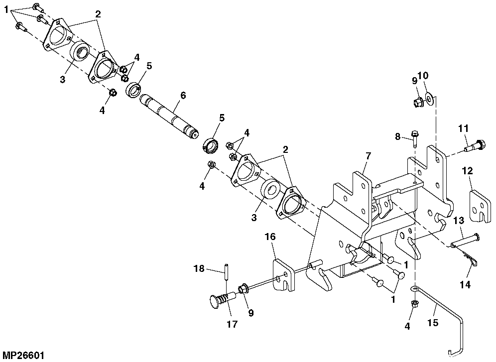

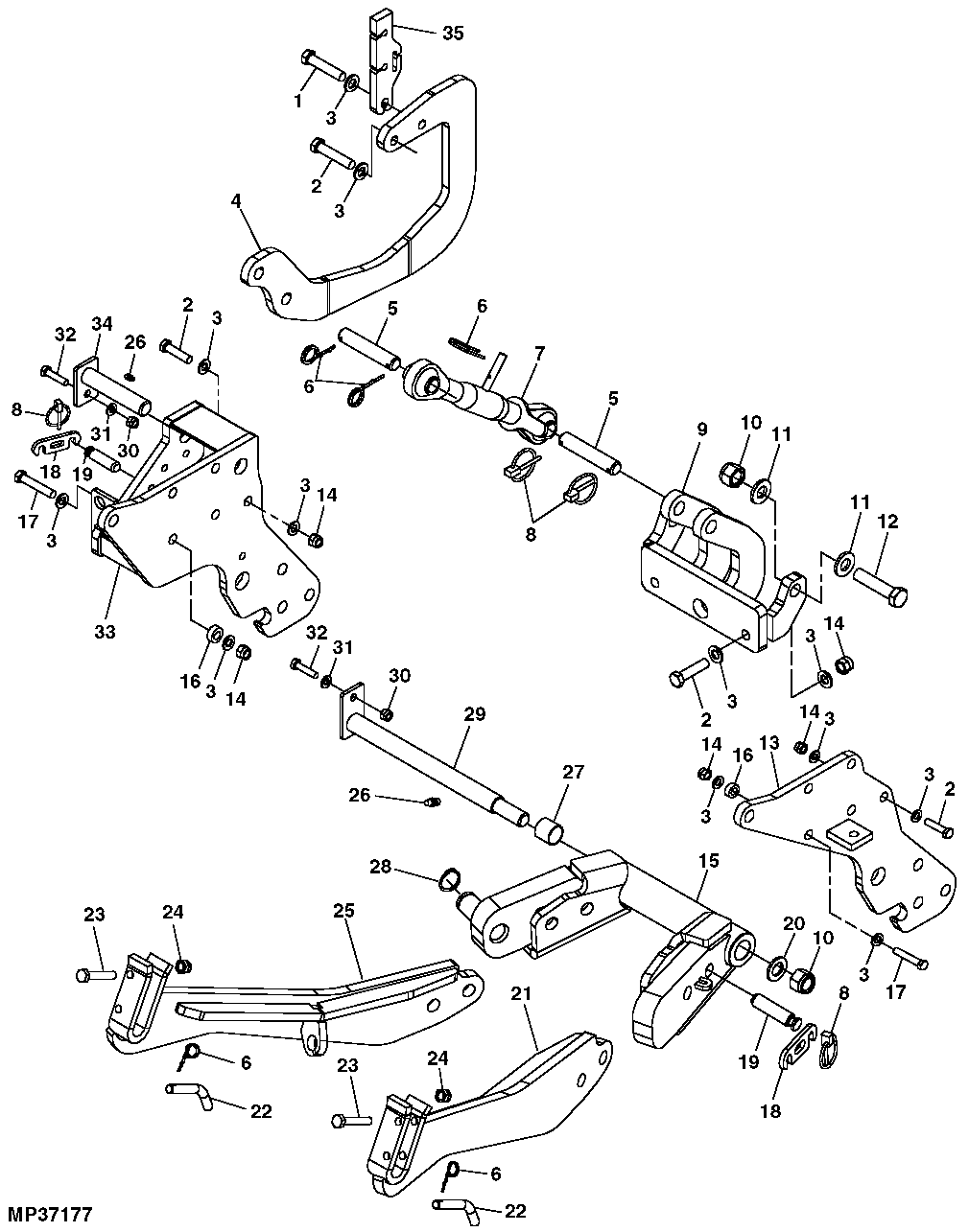

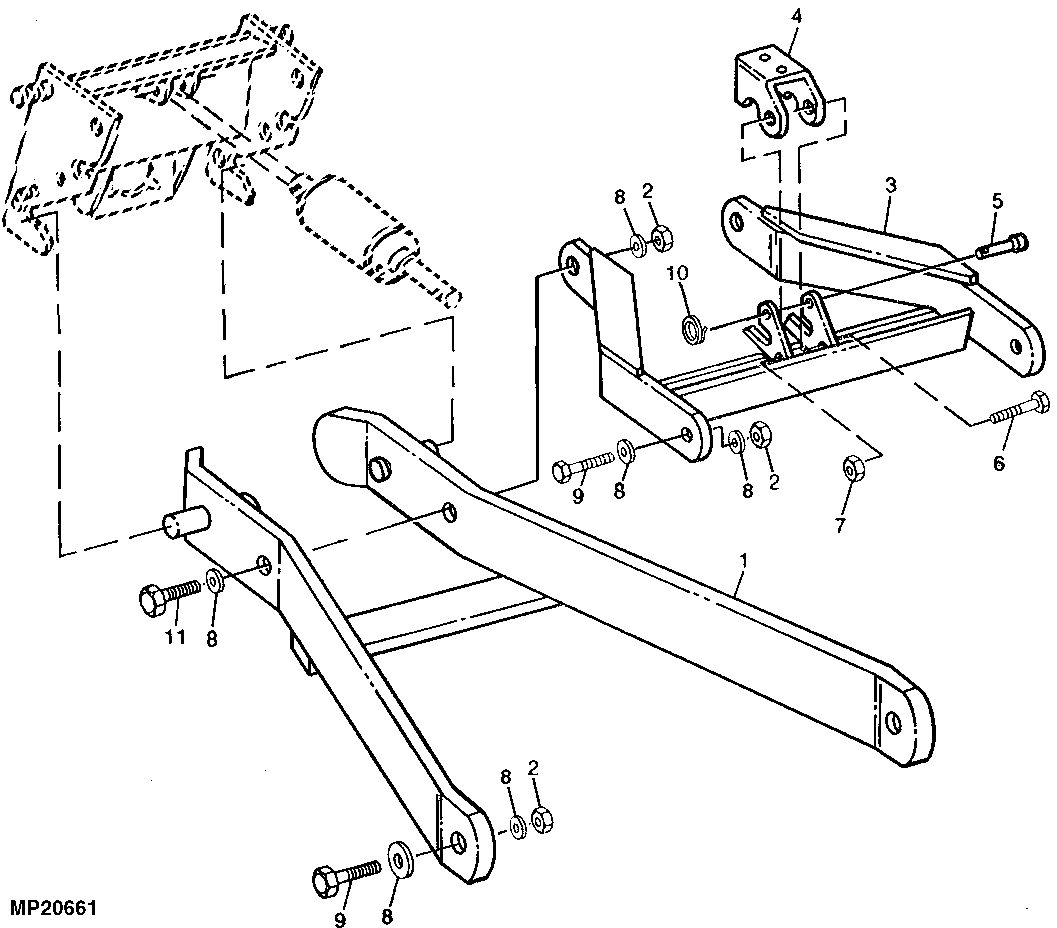

Try this guys. I think this is the old system.
(The last illustration on the right is the NEW system)
Rob

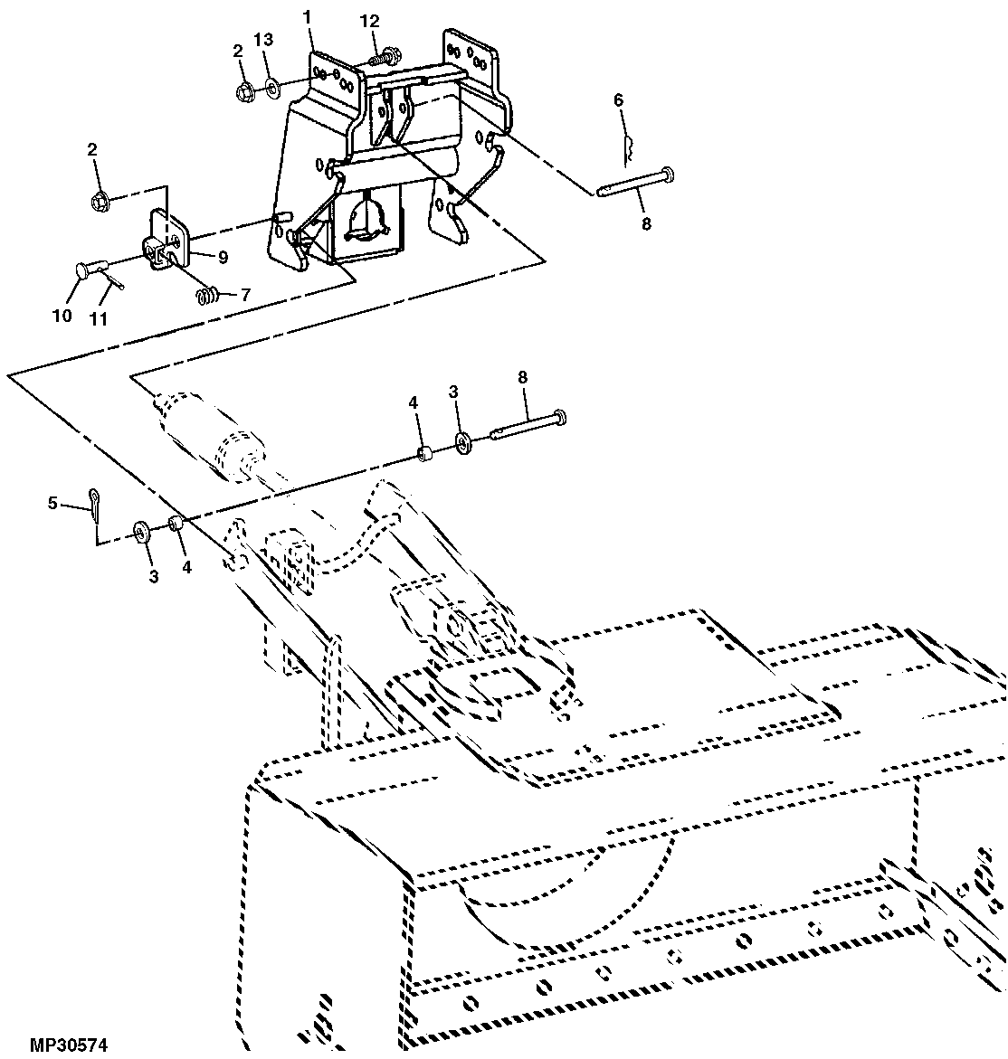

Here's one more for the 42/43/4400.

#17
Rob-D
The pic on the left and the center pic is exactly what I have. Even the hanger(15) in the middle diagram stands out. Where did you find diagrams of the old system. I would like to find manuals for it but everything I found had the new three point system for the 3x20 series.

#19
When I go to JD parts that center picture you posted of the hitch is listed as FRONT HITCH KIT (4210/4310/4410)傳R>FRONT HITCH KIT (210/4310/4410) (CONTINUED). If you move your cursor over the pic you posted it is mp26601____un23nov01.gif. If you put your cursor over the pic on JD parts for the FRONT HITCH KIT (4210/4310/4410)傳R>FRONT HITCH KIT (210/4310/4410) (CONTINUED) it is the same as the one you posted. The only one I saw for the 3x20 series was the three point. I have worked on aircraft for twenty one years and I know how parts diagrams and the books they are in (mostly digital now) can sometimes show different parts for the same job. I just have not been able to find that specific hitch with 3x20 any where on JD parts just for the 4210/4310/4410. It may just be the same and compatible with the 3x20. It works and I didn't have to modify anything. I was just trying to verify that it does fit both tractors so other owners would know if they came acrossed a used one for sale that came off of a 4x10.
