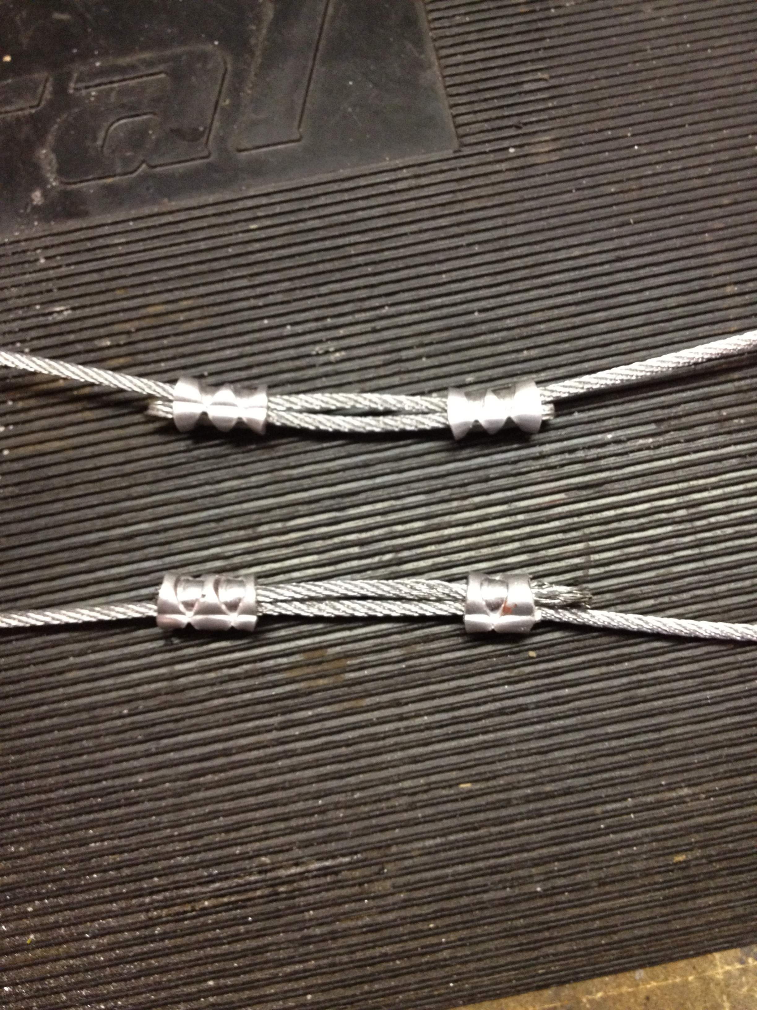

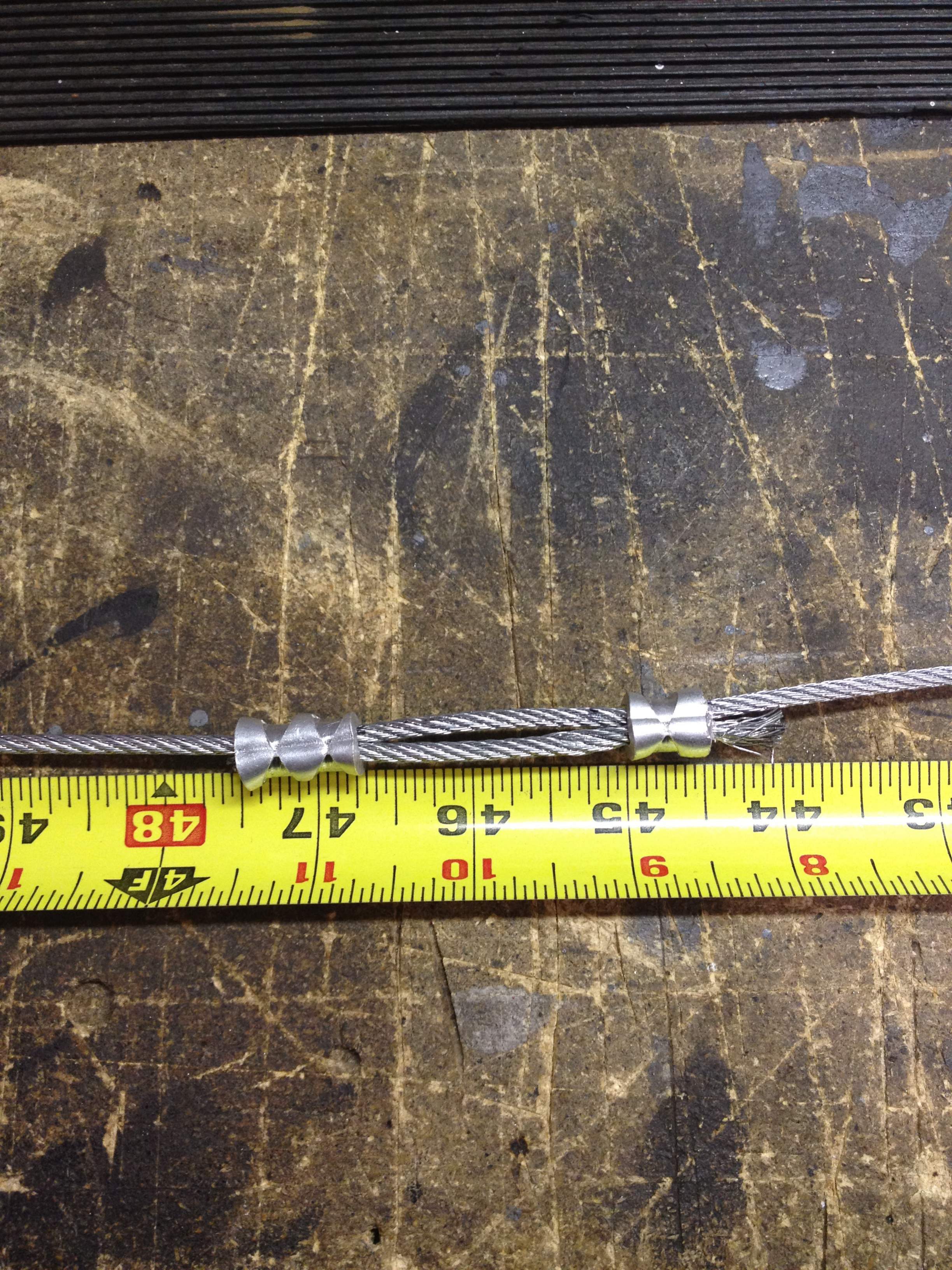

Handy little info here to save ya some $$....
Couple days ago I snapped the chute control cable on my blower. Still not sure what happened. Might have been a rock or ice chunk in between the blower and the chute. Anyhow.... I ordered a new cable, (part #M84556), from Deere. $27.28. Got it today and what a rip off:mad: Original one came off in 3 pieces so couldn't get a real measure on it to make my own replacement.)
All it is is an 1/8" cable with a couple furrals crimped on.
So.... from the parts house to the hardware store I went. Grabbed 20' of cable and 4 furrals for a grand total of ........$5.29. And get this.... with that I made 2 spare replacements to have on hand.
Here are some measures and material to save you folks $25.00 if you happen to need new cable.
1 pc. 1/8" cable x 88"
1 pc. 1/8" cable x 3.5"
2- furrals
Pics show where to crimp the short pc of cable to the main long one.
Once I figured out the routing of the cable over the 3 pullies and adjusted things it works slick as snot!!!
Should have shot some pics of replacing the cable and such but didn't think about it. Can get cable routing pics if you need em.
Hope this helps!!!!

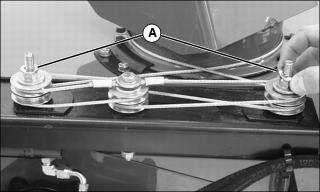

/ 59" Blower cables #6
Do you have pictures of how to route the cables around the pulley's? I am having a terrible time getting it put back together. Thanks, Allen Livermore

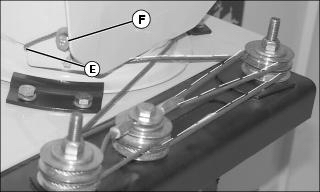

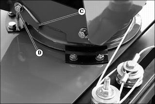

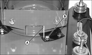

Here ya go'
