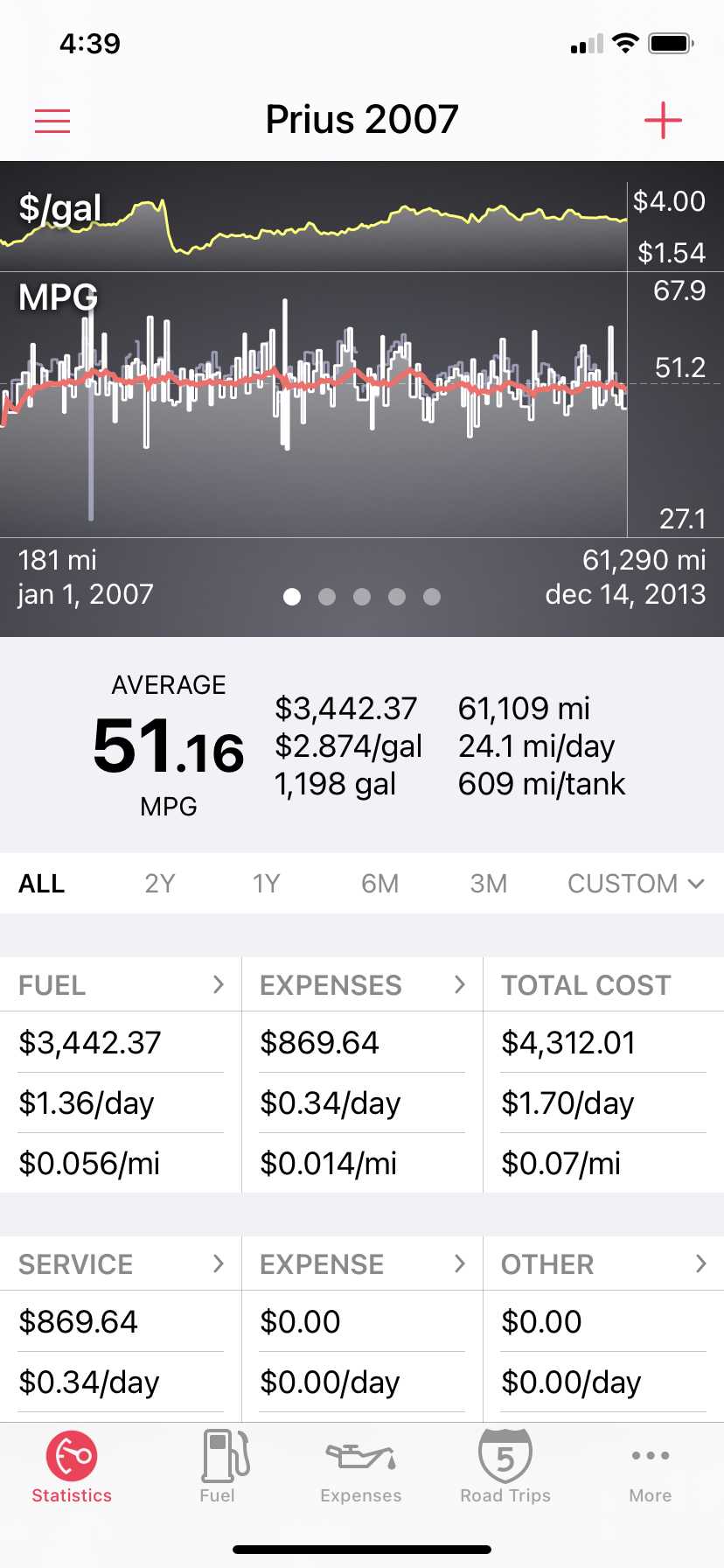

So what happens if "everyone" drove diesel automobiles (even if they were as clean as gasoline)? Where would we get the diesel from? Diesel and gasoline are symbiotic. Production of one depends on the other, and vice versa. A barrel of crude can not be made into either gasoline or diesel, you can get some of each and rubber the ratio a bit but when you deviate from the natural split costs soar. This is why decades ago when gasoline was in high demand diesel was dirt cheap. It was being given away as a byproduct of producing gasoline.
Today there is a high demand for diesel driving it's price to something much greater than gasoline. I bought 87 AKI today for $3.269 at a pump that offered ULSD for $4.079.
At these prices and 54 MPG ULSD one only has to get 43 MPG on 87 AKI gasoline to be equal. My lifetime actual miles divided by actual gallons in 2007 Prius was 51.16.

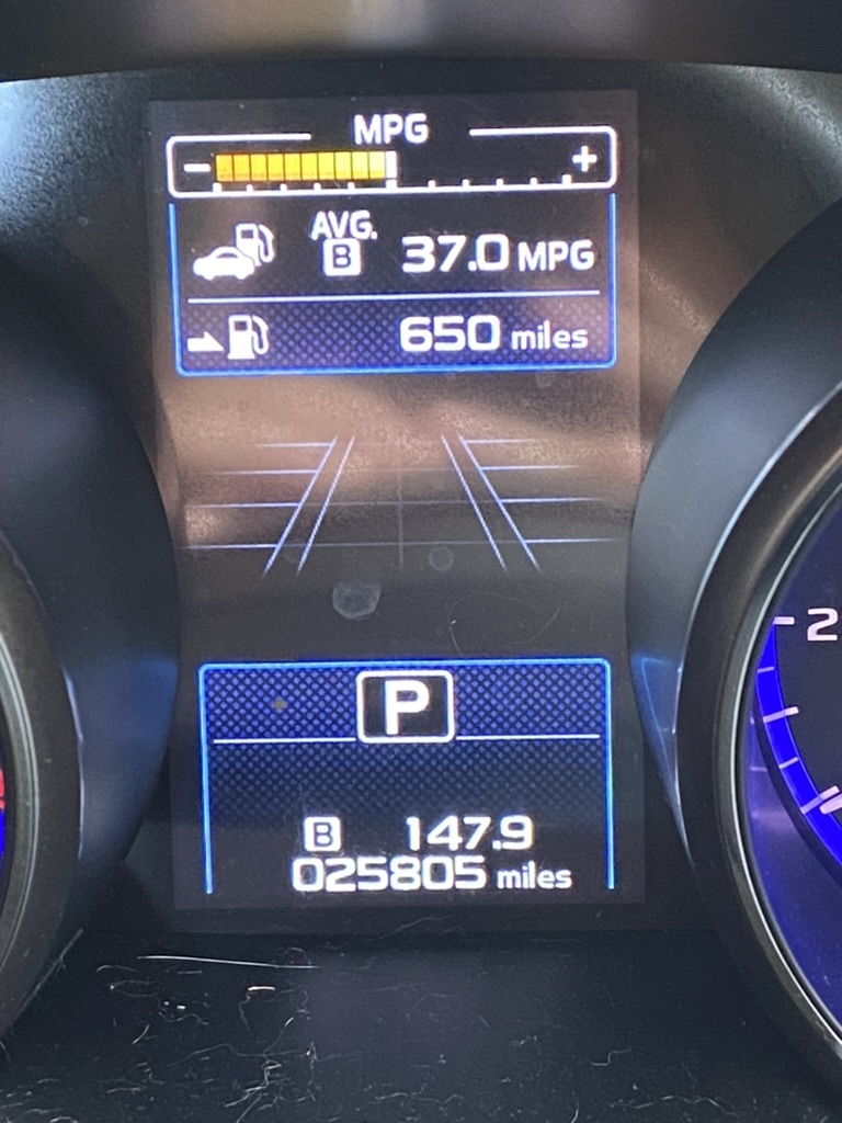

That‘s how one achieves those astronomical MPG. Of course they average things out. 35 mph on 2 lane highway and 75-80 on 4 lane highways.
Not necessarily. Peak MPG is somewhere higher in speed. Apparently you have never tried.
This is what I did this morning in the Subaru Outback. This is what the Fool Computer says.

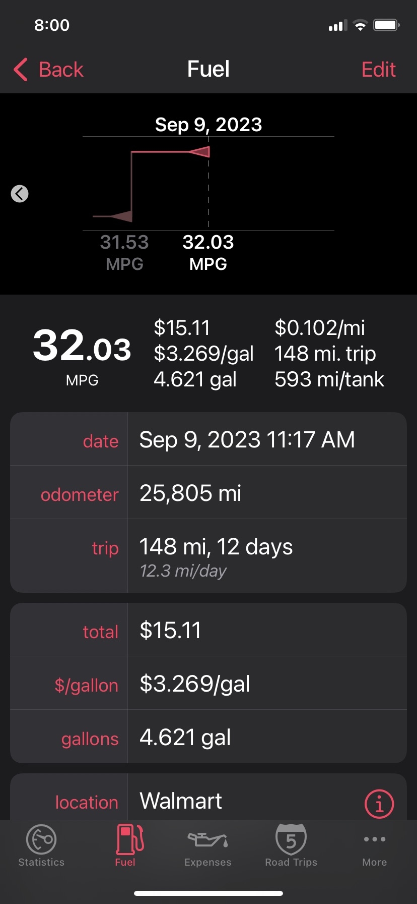

This is what the gas pump says. Previously filled same station 2 weeks ago. Parked 2 weeks. This is lower than I would have expected based on previous Lie O'Meter results. Expected 34-ish. Possible I filled different, they changed the nozzles.
