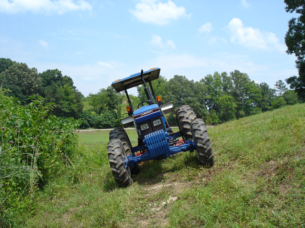

Dginter, 20 degrees doesn't sound bad till you get on it. How are your wheels spaced? Here's a picture of mine on an 18 degree slope. I'm spaced out all the way and have about 800lbs on the front. It feels worse than it looks in the picture. Not too mention there are several depressions on the low side and rocks on the high side that can alter the slope very quickly. There's not many places I feel nervous, but 20 with no spacing would have me nervous.

Just moved the wheels (moved left to right, right to left) last night, think I went from 60" center to center to 64" (think that's 3 positions from widest). Also moved front out to track with the back (inside of both sets the same)... what a pain, 1 stud on the right and 2 on the left spun so we tack welded them to hold em to get the lug nuts off, other than that it wasnt bad... took 'er for a spin n put her on 19 deg's and it felt better than before that's for sure. Had it on a 20 with the original spacing n I was way nervous... runnin' with FEL on

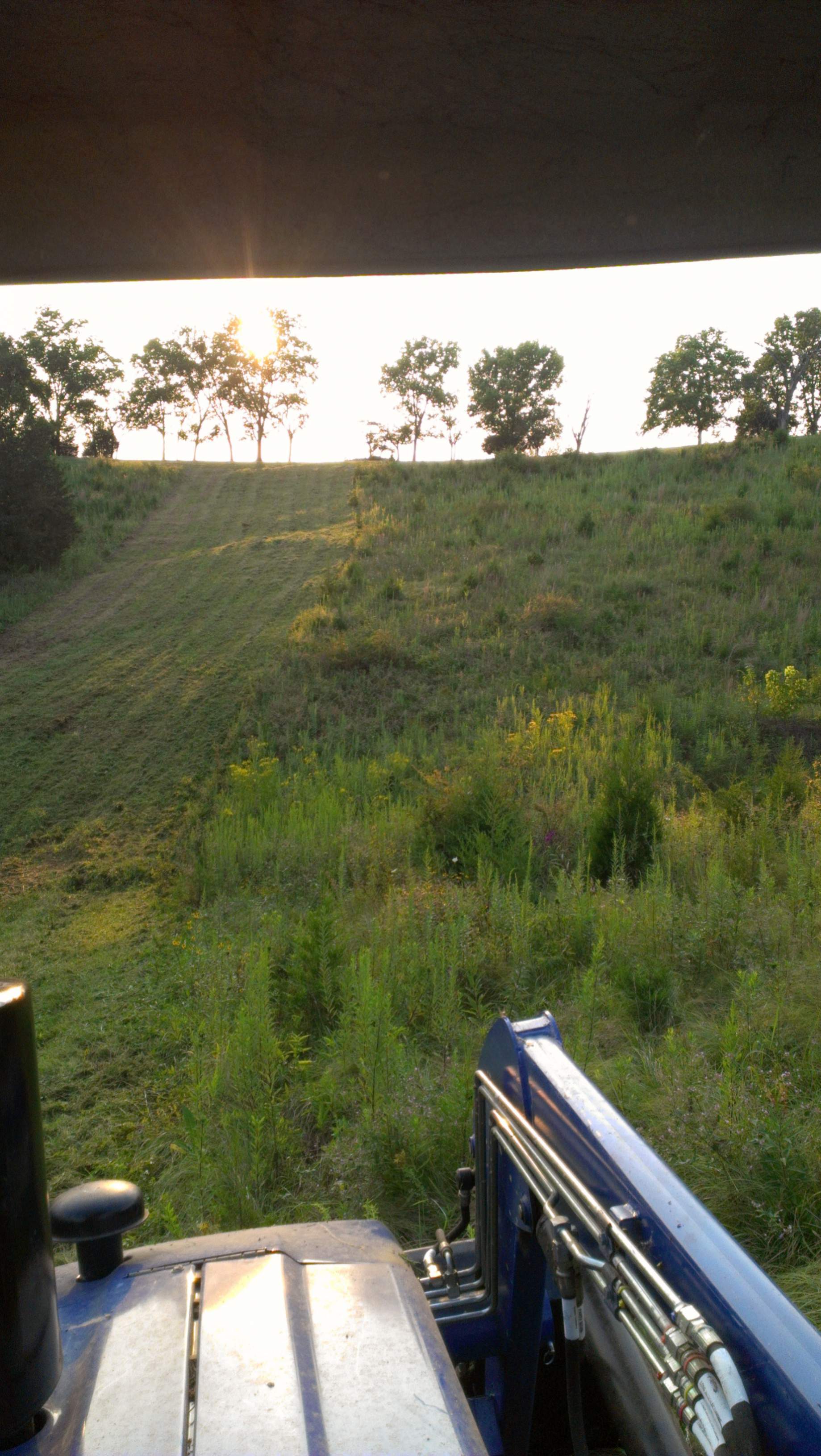

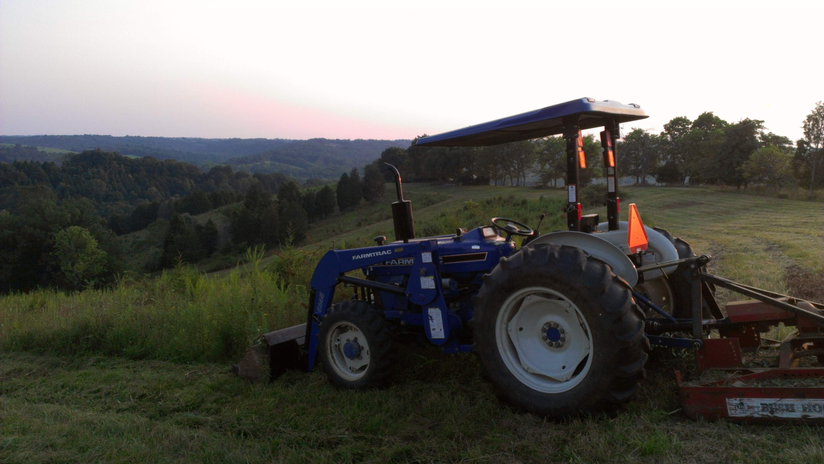

#9
figurin' out how to conquer the slopes, ha ha
/ 555 DTC on slopes #10
Nothing like some nice scenery while you cut. Looks great.
/ 555 DTC on slopes
#11
yeah, its beautiful up on the ridge, can see for miles when you're up on top... n mowin' only makes it nicer
