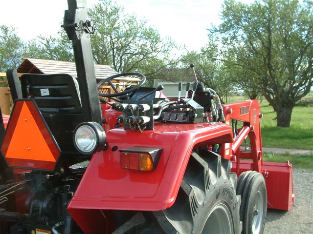

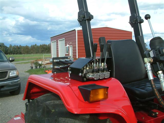

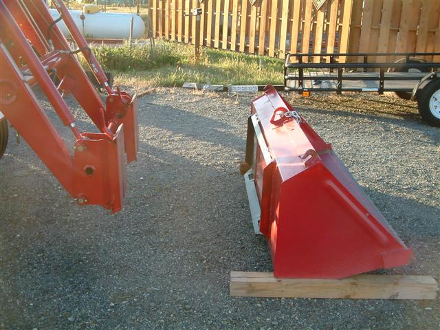

Get as much hp as you can afford--200 acres is a lot of land.
Be sure you get the skid steer quick attach option for your FEL.
Get double rear hydraulic remotes--triple is better. Mine is a dealer-designed rig that cost $700 (part of the deal when I bought the tractor new in 2008).
Ag tires for sure.
I added an expanded metal screen to the ROPS (use hose clamps to secure it--no drilling or welding on the ROPS, it's a safety feature that shouldn't be altered). Protects my backside when mowing with the brush hog.
Good luck.
