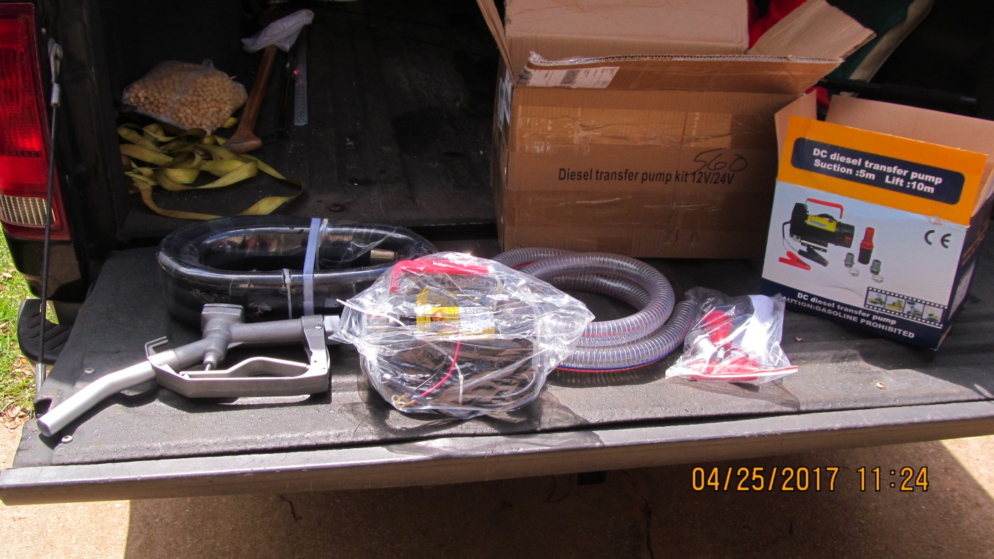

I bought an inexpensive pump off eBay for $65 in April 2017 and it hasn't missed a lick. I keep two drums under the shed my diesel generator is under and use one of the generator batteries to power the pump. I have a local fuel company deliver the fuel so I don't have to transport or move the drums. I pull whatever I need to fuel up in range of the hose and fill.
In hindsight I may have chosen one of the pump kits without a nozzle and bought an auto shut off nozzle for it but it's not much trouble to just look in the tanks as I fill. Filling my 28 gallon backhoe tank takes less than 2 minutes.

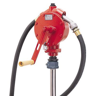

I have a FillRite FR112 hand crank pump in a 50 gallon barrel in my shop. When I need to pump more than I feel like cranking I just take my Dewalt cordless drill and stick a socket on the nut holding on the crank. Let the drill do the work. Works like a charm and one battery will easily pump a whole 55gal barrel.
