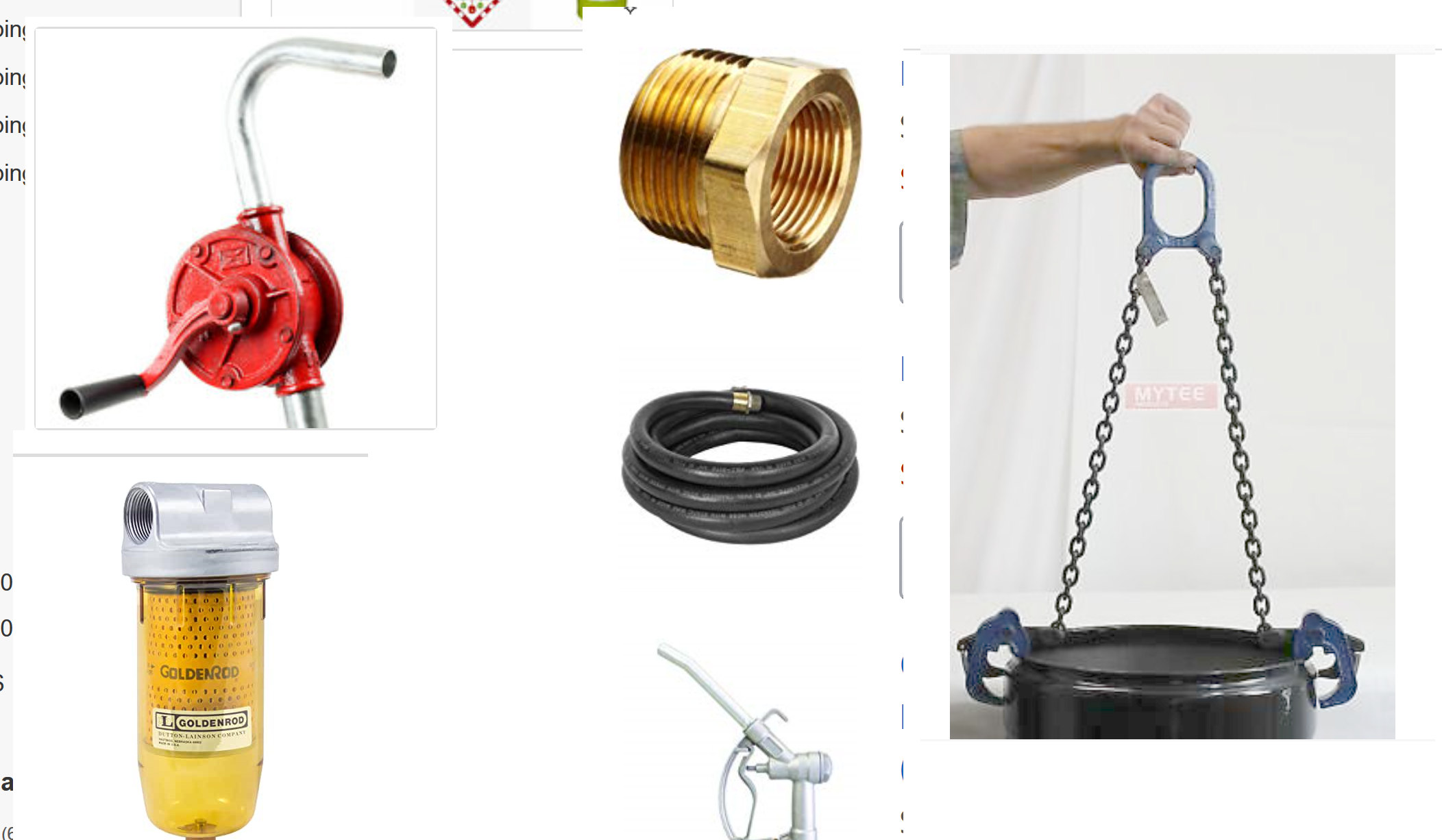

So here is what I've got a harbor freight hand pump, golden rod fuel filter 1", 20' of fuel hose, Goez 3/4' locking fuel nozzle. chain fall drum lifter. The output tube from pump is 1" od thin wall tube. Planning on a 1" male npt to 3/4 pvc glue with a piece of 1 inch heater hose and clamps to make the connection between pump and filter. What I want to do have drum, pump, filter hose nozzle all sort hung together so it can sit under the pole barn for easy fillups, but also use chain and forks to be moved to whatever needs to be filled, Ideas please

I might rethink your whole setup though. The tractor shows a 20 gallon fuel tank and the go cart shows 8 gallons. Those hand crank pumps are about 16 turns per gallon, so that's like 400 cranks to fill both vehicle tanks. And you'd only get 2 fills out of a full barrel.
How much fuel do you expect to use per year? I'd be seriously considering getting a bulk supplier to bring a tank out and fill it once a year or so. At the very least, consider a larger transfer tank with an electric pump, but those setups can cost a few hundred dollars for a 100 gallon unit.

I use a drum also as my fuel needs are not that great, but I have a 12v transfer pump that stays on the drum. Added a longer wire with alligator clips to reach the battery on the tractor. It seems like the first idea you had would be prone to leaking eventually especially with pvc and hose clamps. I like the pallet stand and plan to make one for my fueling drum.:2cents:

Ok here is my logic, don't use enough fuel to have a large local filled tank. However when it looks like Hurricane is coming I want to get several drums filled with off road diesel and off loading them from the back of my F350 is easier with chain hoist. A 12vdc pump is good idea but quality one from fillrite is expensive and I nagging feeling a cheap one will fail when I need it most. Hopefully my arm won't I already have several 110v transfer pumps that I could use and 12vdc to 110ac converter rigged in my F350 to deliver limited 110vac at work sites for hand tools. I have pallets laying around. In normal year I may only use one drum, so if I fill three for storm, the other two will sit sealed until I use them up. A large open tank vented in Florida is inviting problems. For a normal year my Rtv will use the most diesel with the tractor and mep802a gen eating small amounts. The diesel f350 sits full and gets little use. Twice I went through weeks on gasoline generator and finding fuel was dangerous at times. So when power goes down I be placing the genset and drums next to it. I have bung hole adapter that will let the genset refill itself from the drums without intervention. Other wise the stuff is in the barn or under the pole barn. I was hoping somebody might have used a hand pump setup and come up with better idea than my plan. If things are real bad I'll be driving around using my transfer pumps to suck diesel out tanks at stations with no power ie mad max

OK, that all makes sense, but I'd still attach pallets to the barrels and use forks if you have them. If not, you can still rig a sling system to each pallet for the chainfall.
And I have used the hand crank pump. That's what I have and why I know the 16 crank per gallon bit.

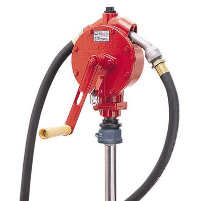

I have a FillRite FR112 hand crank pump in a 50 gallon barrel in my shop. When I need to pump more than I feel like cranking I just take my Dewalt cordless drill and stick a socket on the nut holding on the crank. Let the drill do the work. Works like a charm and one battery will easily pump a whole 55gal barrel.
