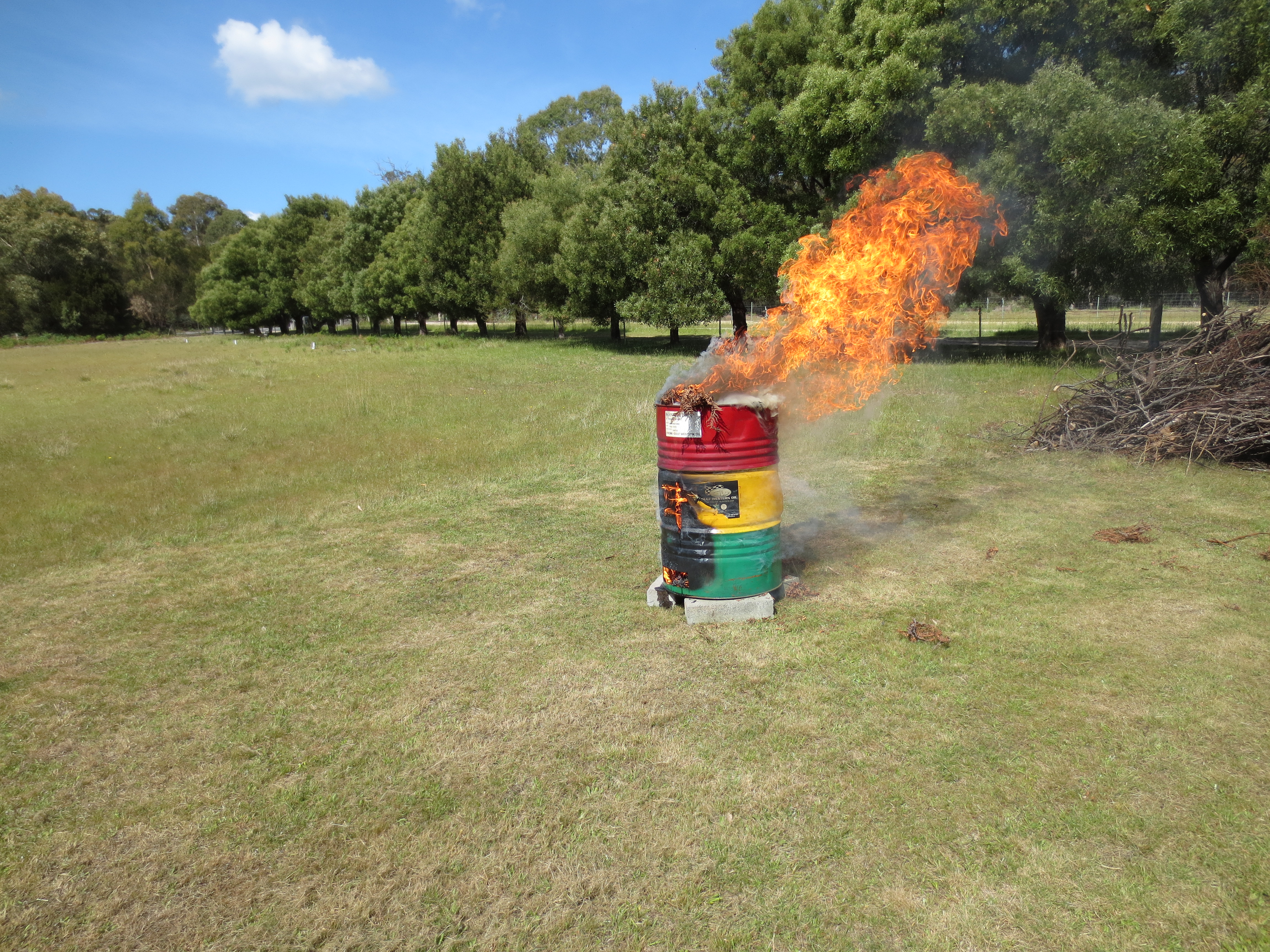

Just so you know, barrel burning is illegal in many states. It produces dioxins which are the most toxic chemicals known to science (remember Love Canal?). Burning plastic bottles, paper and cardboard produces these dioxins in dangerous levels. Take your trash to a waste facility equipped to deal with it safely. Your neighbors will thank you.
/ 55 gallon drum ideas #22
Piloon---Do you cut the bottoms out?
No. just the tops, but do drill a few small holes for water drainage.
I always try to have crushed stone under the burn barrel as some soils tend to catch fire and or smolder.
While at first I simply used a small axe and carefully chopped my way around (actually worked well) I later used my jigsaw with fine toothed blades, much neater.

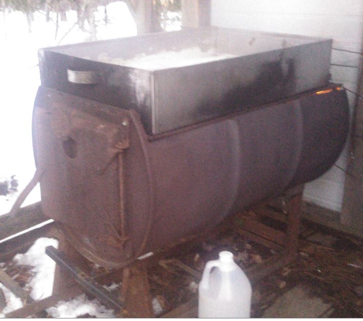

This is the best thing I've used one for; an evaporator for the spring maple syrup season. :licking:

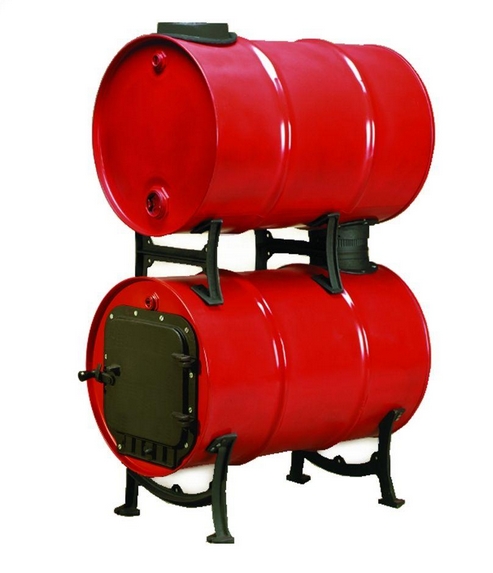

They make dandy shop heaters with a double drum kit.
/ 55 gallon drum ideas #33
What exactly are you getting for 39 bucks?
Just the 'add on' or top barrel kit (barrel & heat resistant paint not included)
The bottom kit is US$50 (barrel & heat resistant paint not included)
Neither includes a flue from what I can see. Still, it looks like a spiffy project for a well ventilated space.
/ 55 gallon drum ideas #34
You also can get them at Northern Tool. I've never seen the two barrel stove work, but regular barrel stoves used to be popular. They are very inefficient heaters and the barrels don't tend to last very long; but if you have a lot of junk wood and want to heat your work area cheaply they are a good way to go.
Drum Kits
Double Barrel Adaptor Kits Note: These often picture the main drum kit but are just the legs and flange adapters to stack a second drum.
Built one and used it in my shop for years then donated it to a hunting camp. At the camp we bent a piece of expanded metal to make a flat surface on the top. We would place a venison roast on top in a baking bag in a pot in the morning and it would be just right by lunch.
Edit: Just saw the Walmart link MossRoad posted and it looks to be better pricing. His link is for the stack kit but the drum kit also came up in the suggestions at top. You need BOTH pieces to make a stacked drum heater. Drum + Stack Kit
