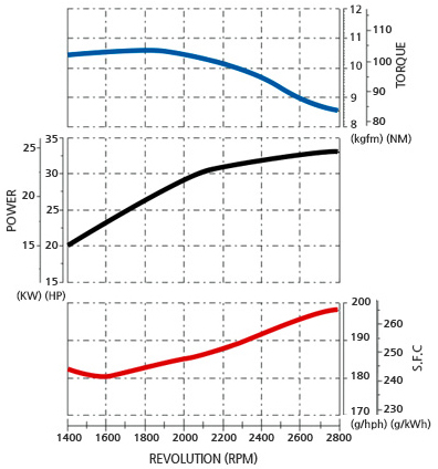

One drawback of running at 1900 rpm is that you don't get "torque rise". That's where torque increases as rpm decreases from normal operating rpm, as long as rpm does not get too low. Most tractor engines including ours are set up that way. For example here's power curves for the A1700:
Note the torque peaks at about 1800 rpm, but HP is highest at peak rpm. (The bottom SFC chart is specific fuel consumption or fuel used per HP. Running in 540E would result in lower fuel use).
But the 540E does work at the engine peak torque, give or take a couple RPMs. The charts from Cummins vs Kukje for the A1700, doesn't quite match exactly, which is fine.
On the fuel consumption, the difference is quite substantial.

I guess I did not explain torque rise sufficiently. Here's a much better explanation: Perkins | Torque backup
Excellent article. Thanks for sharing. I understand now what you're trying to explain. It does make sense but the 540E is supposedly to be used with light to medium duty applications, so I guess the engineers focus on the peak torque because they don't expect it to be very loaded anyway.
