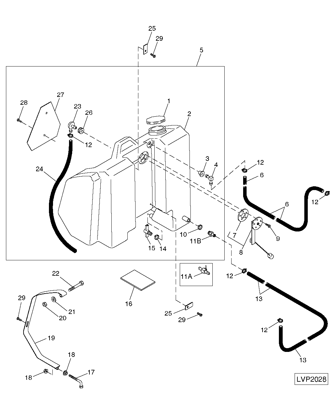

My dad has a 5400 in which the gas tank has imploded. I'm guessing a bad vent or clogged vent line? Or does the vent only expel excess pressure? What would cause a vacuum so bad that it would implode the entire tank? Looking to replace the tank right now, but need to find the root cause first.

As far as I know the vent on the cap is a one-way valve to allow air into the tank to equalise the pressure and allow the fuel to flow. One of the common suggestions for an engine being starved of fuel is to loosen the fuel cap.

Take the fuel cap off and blow/suck on the center of the outside of the cap. If you can't get air to flow either way it's the fuel cap. Either try to fix it with washing it or pounding on it or have your dealer order you a new fuel cap. <~~~~~best idea really, diesel tastes awful............
/ 5400 gas tank imploded #7
The 5400 does not use a vented fuel cap. There is a vent on the rear of the tank behind the SMV sign(triangle). Remove the 2 screws holding the sign to access it. It is a plastic fitting pushed through a rubber grommet in the tank with a hose attached to it. The hose could be pinched shut or clogged with dirt. Parts 23, 24, and 26

Update to all: I worked on my dads machine and after taking the rear reflector off, the vent tube (#24 in jd110's pic) was missing. He had grass all caked up around the vent (#23). I cleaned the vent out and installed a new hose. So we're good for now. But the tank itself is ruined. I'm not sure whether to try to take the tank off and set it in the hot sun for a day to see if it will expand back into shape. Or just buy a new/used one off ebay. Do you guys think it would 'pop' back into shape if I drain the diesel out just enough and seal the tank up in the sun?
/ 5400 gas tank imploded #11
Might be worth a try to set it empty in the hot sun.. and plug the outlet and vent to enable putting a small amount of air pressure to pop it back out.
But a replacement may be less work in the long run if the "fix" doesn't work.
