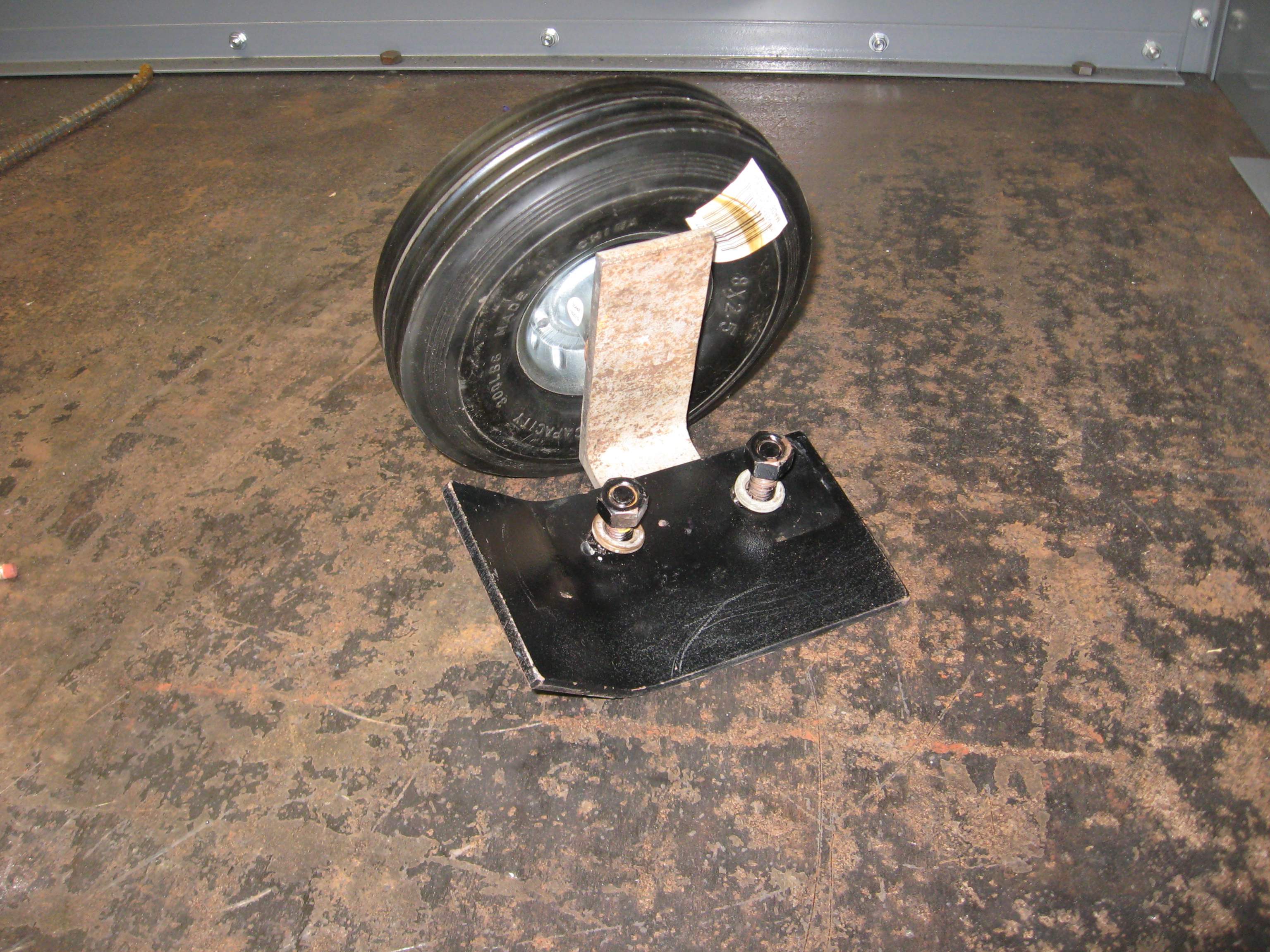

"BTW, does anyone know why JD put the two holes in the original skids?"
No, I don't, but I used them to accept the bolts that hold my oversized shoes/wheels. IMG_3176.jpg
I have used them to mount extra sacrificial wear plates in the past. Replacing the shoes gets expensive, but you can bolt a piece of 1/2 inch plate under there, and it will last a long time.
   / 54 " Blower fan observation? #32
I know what you mean. JD wants $50+ for each shoe. But the shoes are super easy to make. If you are able to cut off the old skid a new chunk of 2 1/4 x 1/2 x 8" steel is only like $5.00 and it would last a long time. The hardest part for me was bending the ends. I can't imagine it costing more than $15.00 to make a whole shoe from scratch - that's materials cost of course assuming you are doing the cutting and welding yourself.
   / 54 " Blower fan observation? #33
No, I don't, but I used them to accept the bolts that hold my oversized shoes/wheels.View attachment 298731
My guess,
To bolt on wider and or longer optional shoes, might have been an option.

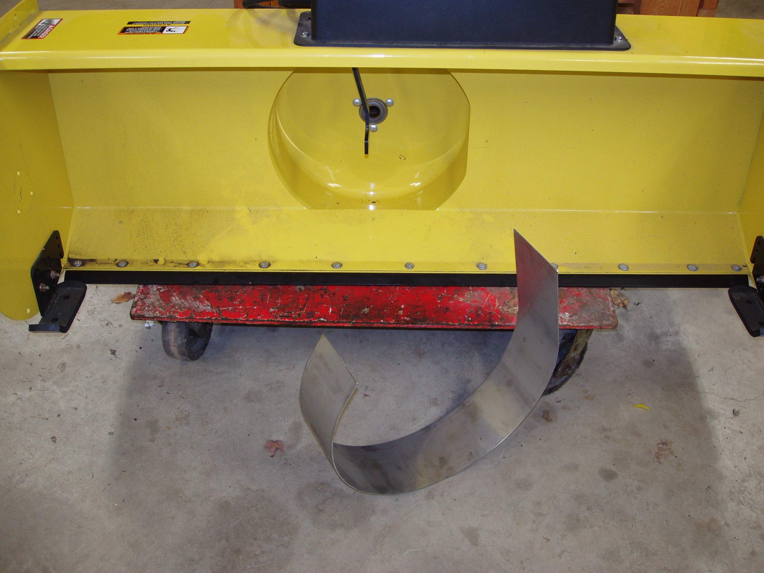

I know this is a very old thread but has anyone tried the stainless steel liner that was mentioned in this thread. Seems like it would be an excellent addition to a blower.
   / 54 " Blower fan observation? #37
Sorry. first page of thread, post #9
