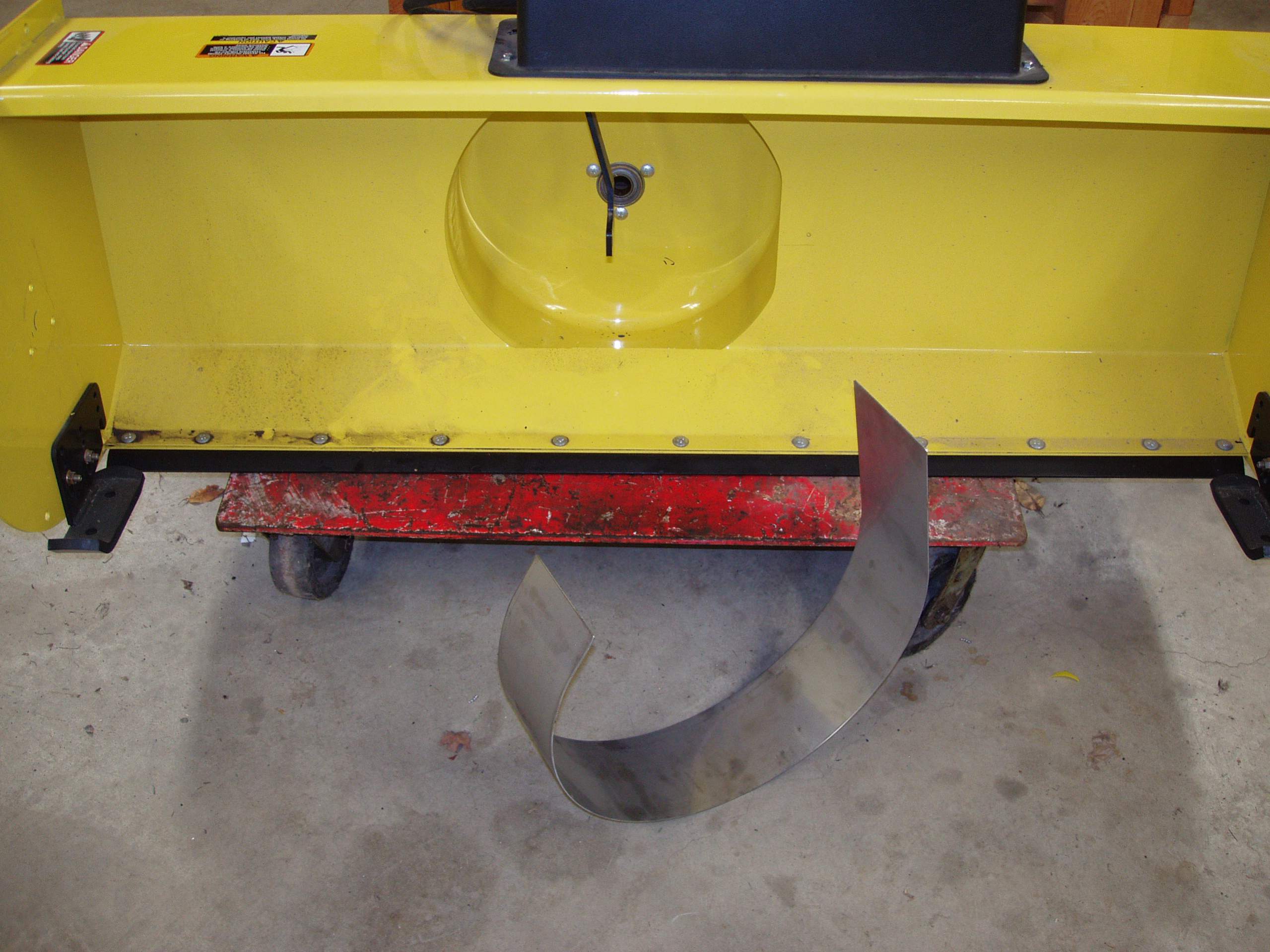

jgayman, I have a 47" blower on my JD 445 that I have been running for around 16 yrs. That blower has seen a lot of snow over the years and the impeller housing sure shows the use!! I have about 500' of gravel driveway. About 3 yrs ago, an open slit developed in the chamber. I welded a "patch" on the outside. When I bought my 2520 with 54" blower in 2011 I wanted to come up with something to combat this wear. I had 14 gauge stainless steel rolled to fit snug into the chamber and fastened it with 10-32 ss truss head screws and ss nylon locknuts. I figure periodically I will have to replace the screws and after a few years replace the ss liner. I think it was around $30 to have liner made. I also installed one in my old 47". Another thing I did was remove the cutting edges on both blowers. I replaced them with a length of 1 1/4" schedule 40 steel pipe. The pipe has 3 tabs welded to it. A tab at each end with 2 holes and a tab in the center with 3 holes. It bolts right up using the bolts from the cutting edge. I only used the blowers a couple of times last season and 3 times this winter so far but I really love them pipes!! Here is a pic of the liner. EricP2020019.jpg

Wow... that is a great idea! I like the idea of the replacable impeller liner. Do you have a photo of the pipes that you installed in place of the cutting edge? Do you find that it allows you to run the blower shoes down closer to the gravel? The one change I am actively working on is increasing the size of the shoe pads. Unless the ground is frozen they seem to really dig in. I saw a post from another owner who had much better results once they increased the skid pads to around 4x6".
