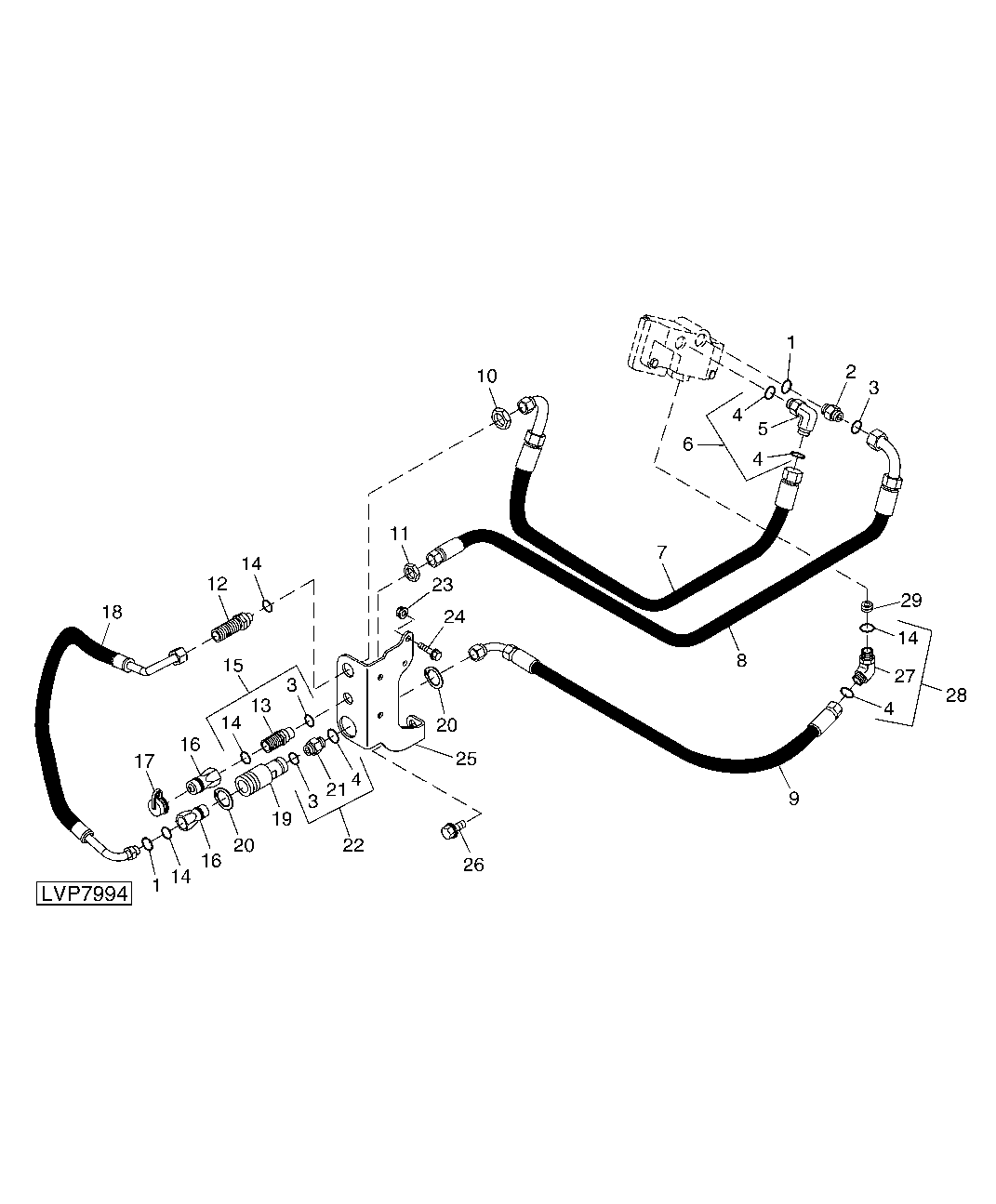

I just bough a 5310 JD with front end loader.
I wan to use my backhoe behind this one, what is the best (most cost effective way) to install power beyond on the 5310?

Yes, you need Power Beyond. It's not a "valve", just a set of lines that provide continuous flow whenever the tractor is running. If you look in JDParts, look under "P" for power beyond, there are several listed depending on which SCV configuration you have. The one below is for 0 or 1 rear SCV's.
There is a quick tutorial linked in my signature if you need help with JDParts.

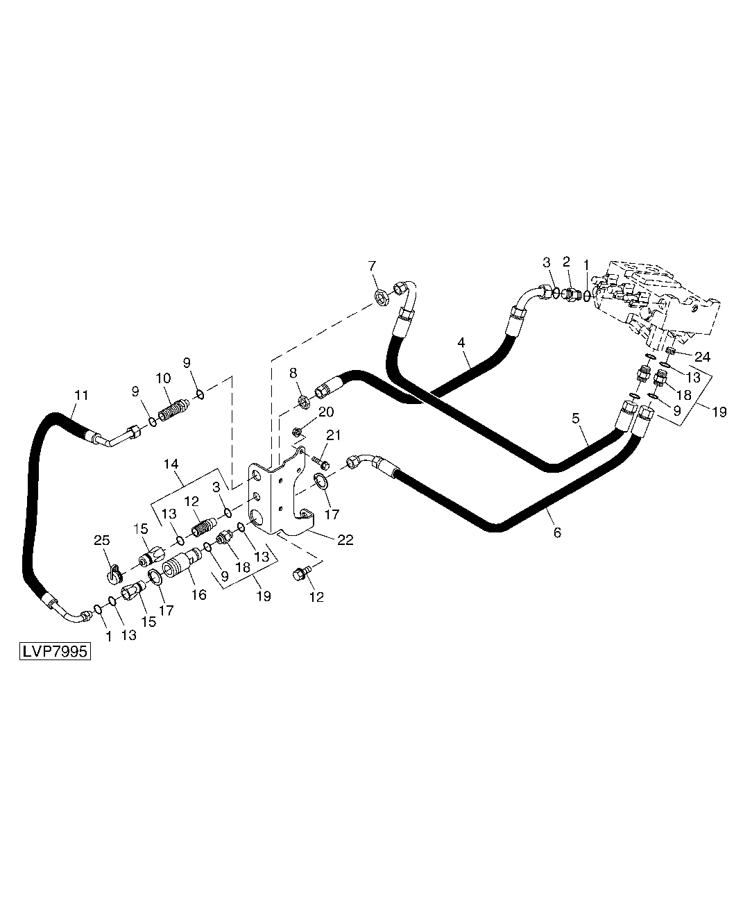

thanks for the in info,
finally got the tracor shipped to the house and did some checking.
i have 2 sets of remote scv on the back connected to my front end loader, the valve block has 3 extra connections capped off on right side (wheel side).
if i look up the power beyond coupler kit ( with 2 or 3 scv) the kit has hoses for 3 couplers:
one to male quick connect.
one from bottom of block to hose to male quick connect
and then one that is going from bottom of block to a female quick connect. these are looped together.
the last one from top back of block to male quick connect where do i use that one for? eaxtra return leak oil line? see attachment.

The "extra" line should be a direct return to the sump/tank, bypassing the 3PH since you don't want it active while the backhoe is mounted.
   / 5310 backhoe
ok thanks,
i do have an overflow /pressure relief valve and line coming from my backhoe block which right now blows the oil to the ground, so i can connect it to this one.
