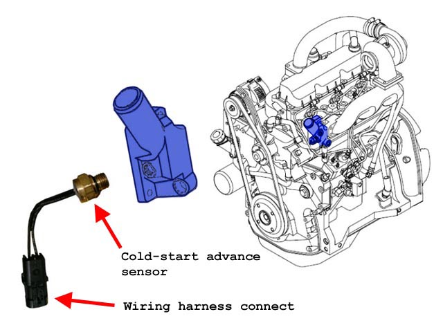

Hi all,
The 5205 has been a great tractor thus far. All of a sudden, it will not start - I have not had this problem before. The tractor cranks well. There is fuel in the tank and in the final filter but it will not start. Is this a possible electric problem or a bad injection pump? I looked at part diagrams but could not find a booster pump on this tractor. Where do I start and what is the most likely cause of the problem? Thank you for your help.
Marcin

Are you blowing any fuses? And does the fuse blow as soon as you turn the key?

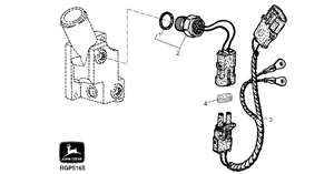

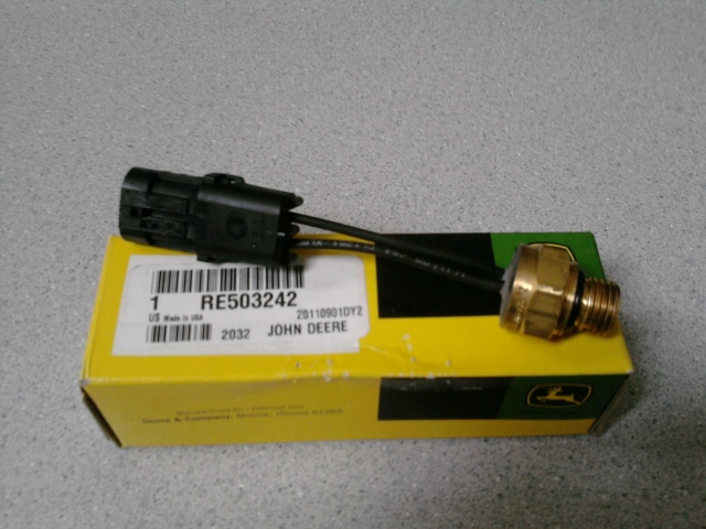

If yes, to both questions, I believe the problem is the thermistor sensor (thermistors are temperature variable resistors used as sensors.). On the thermostat housing there is a sensor that is connected to a two wire harness that goes to the injection pump; this is the "cold start advance" portion of the system so it starts easier when cold by advancing the timing.
When the sensor on the thermostat housing fails it shorts out and blows the fuse. Try unplugging it, replace fuse and see if it starts and runs. The part # is RE503242, if you are quick changing it, you don't have to drain the coolant, just make sure it's not hot at the time. You will want a pan under the tractor to catch the coolant, so as not too have to clean it up.
To comply with the exhaust emissions regulation, the timing of injection pump should be around 6 to 9 degrees before TDC. These timing values do not allow proper start-up operations when engine is cold. To ease engine start-up, a cold advance system gives to the injection pump a temporary over-timing.
When coolant temperature is below 50 C (122 F), the solenoid valve is activated and opens the cold advance circuit.

Yes, a fuse in location 2 behind the ignition switch panel was blown. I changed it and tried starting - it blew immediately. I am not sure if this is the fuel shut off solenoid or not - or is that fuse in a different location? I will try disconnecting the harness tomorrow and seeing. Thank you for the valuable info.
/ 5205 will not start #6
As JD5210 stated, unhook thermistor & change fuse, it should start if that's the cause.

It was definitely the sensor. I disconnected it and replaced the fuse and the tractor started. I bought the new sensor today and plan on installing it, if it fails again, I probably will not bother. Thank you all for ur help.

When you install the thermostat end, when it feels tight, stop turning, i found out the hard way that the brass fitting will not accept "just a little more" & had to buy another one.
