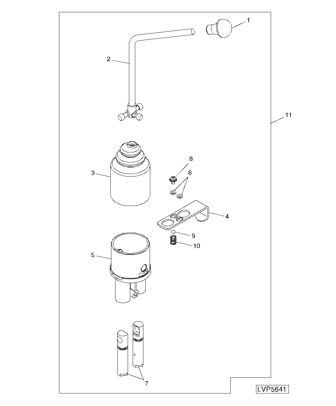

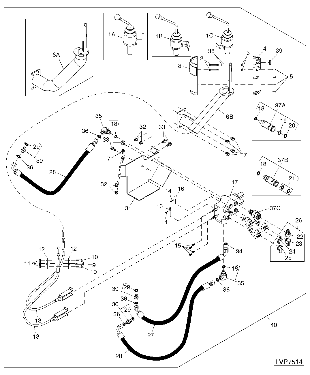

jd 5105 mfwd
What is the adjustment procedure for the joystick. Help
/ 5105 joystick #2
Welcome to TBN:D
I assume you mean a John Deere 5105?
What exactly is the problem and why do you need to adjust it?
/ 5105 joystick
joystk slowly got worse to impossible lately. Took all slack out ofboth cables yesterday. Lots better but not predictable. Dangerous in tight situations.
A part may have fell out because I get that valve feel in 3 directions
but it just flops to the 4 th direction. (About 45 degrees forward and to the
right ! )
Help. DYI Poor boy here.
And yess JD 5105 mfwd will have to get the loader # later. About 2004 ?
45 hp at pto I think.
/ 5105 joystick
right ! )
/ 5105 joystick #5
Frank, here are some picturse from www.jdparts.com that may help (You can register for free there also).
