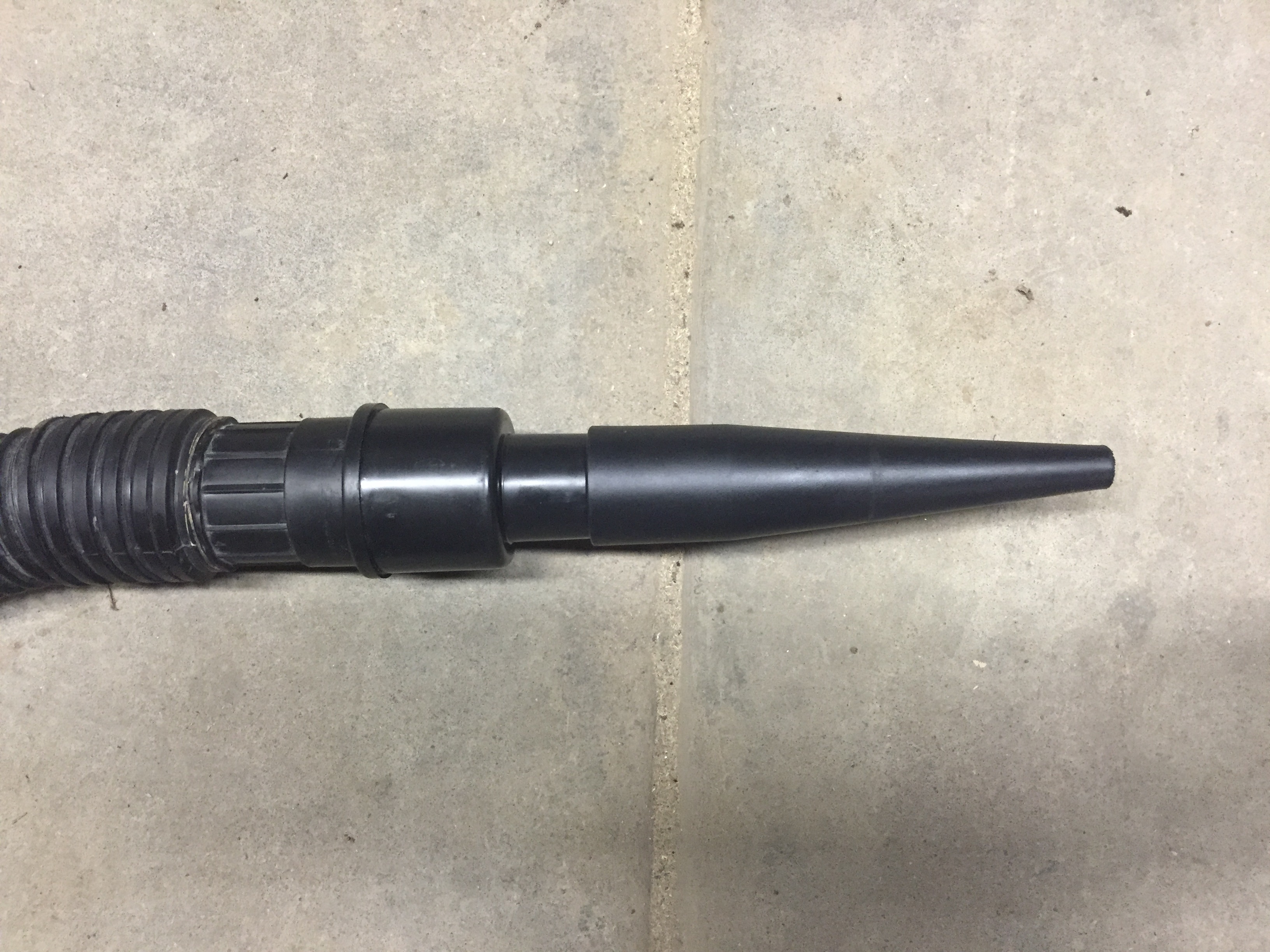

The shop-vac method works great for the hydraulic filter, I tried it today!!! The only oil I lost was what was in the filter. Much better than the last time (I lost about a gallon of oil and had a big mess).
I was skeptical but now I'm a believer!
I ordered a cone shaped adapter for the shop-vac, worked perfectly.
   / 50hr. service #29
Where did you get that?
