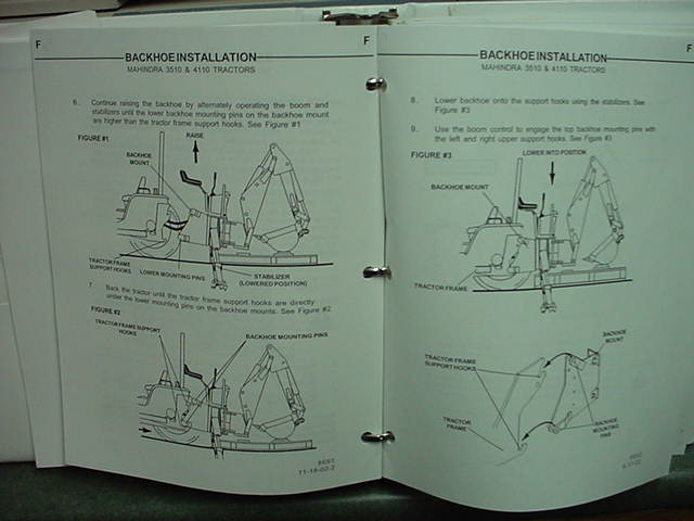

Ok, I managed to remove the 509 BH (no problems) and reinstall (frustrating)
I have the 509/511 operators manual and parts manual but nowhere does it have any instructions for removeing or installing.
The FEL manual gives great instructions for that.
Im I missing somthing in the manual dept. or isnt there anything printed by Mahindra?
(My dealer did give some verbal instructions on delevery last year.)
/ 509 & 511 Backhoe install question #2
There is a third manual called the 3510 & 4110 tractors mounting instructions for Mahindra Backhoes. That manual is the complete installation of the hoe to the tractor, including backing the tractor up to the hoe and hitching it up.
I have all the Dayco Mahindra hoe manuals from the 3265 to the 511, and the mounting instructions for all the 10 and 00 series.
I found them on Ebay.
Check with your dealer to see if you can get that one , and If not let me know and I will photo copy the pages that cover what you want and send them to you.
Dave in NH

/ 509 & 511 Backhoe install question #5
The manual I am referring to is a complete install manual including the subframes and hydraulics . It looks like a manual for the dealer and is about the same size as the operators manual. It shows installing the Hoe off a shipping pallet and goes step by step, but it would apply to any time you install or remove a hoe.
I didn't get one when I bought my BH either. I got the operators and parts manual like you did. It looks like Mahindra has it in the wrong manual, or at least needs to duplicate it in the operators manual.
Or there expecting the dealer will pass that manual on to the owner and some are not.
Good Luck ,
Dave in NH
