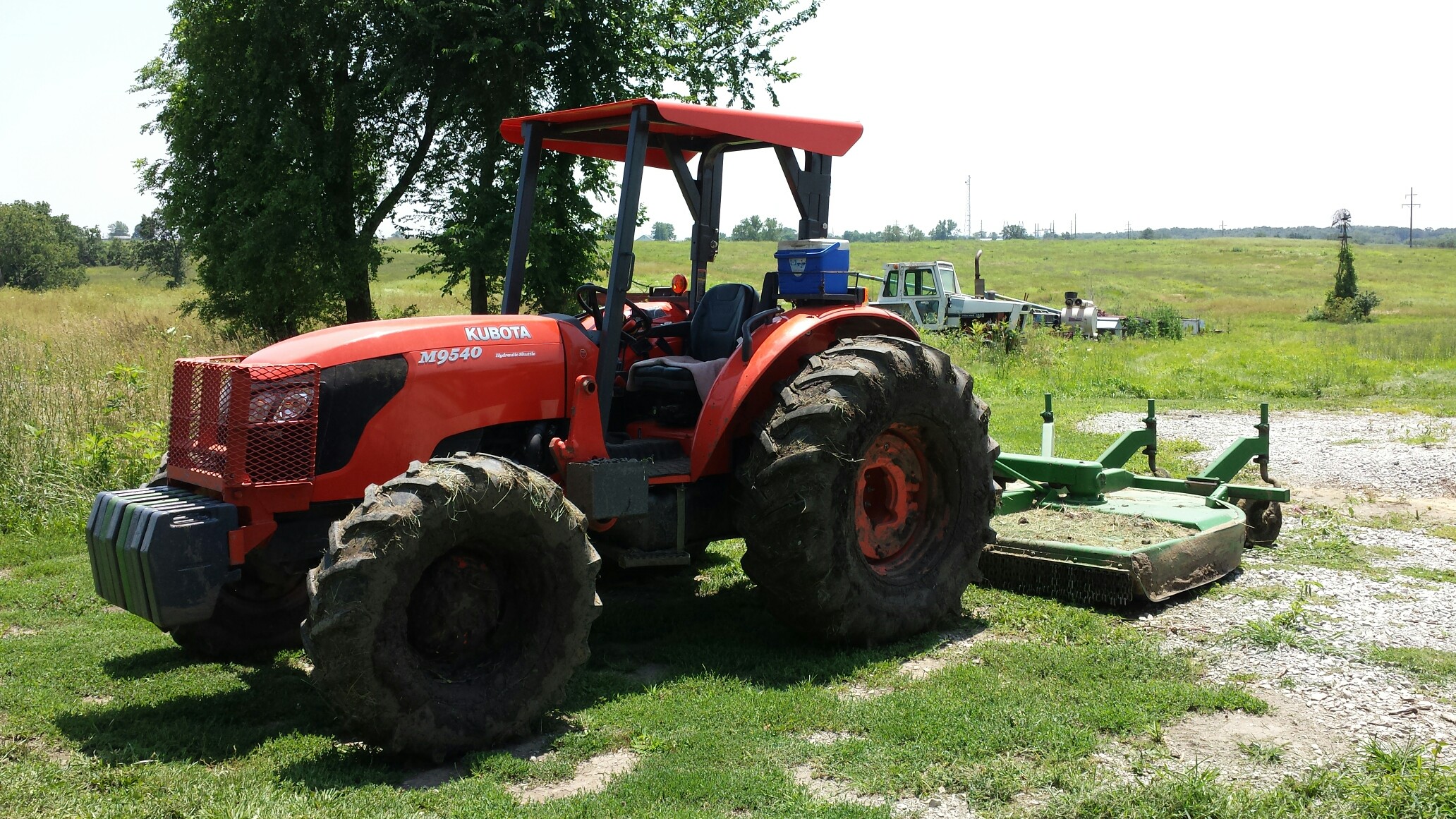

What cutter is that you are carrying when you add that weight?
Also worth noting.....the 5055e is basically the same size/weight as your M9540, just less power.
/ 5055e with MX7? #28
It's a JD M1008, 10ft, 3pt. Not sure what it weighs.
/ 5055e with MX7? #29
No idea what a 1008 weighs, but I am sure it's alot more than the average 8' twin.
My woods is 1620# per spec. I don't need weights to mow, but cannot load forward on a deck-over. I am sure the extra ton of tractor weight plus length, that either you m9540 or the op's 5055e have would make it a non issue.
