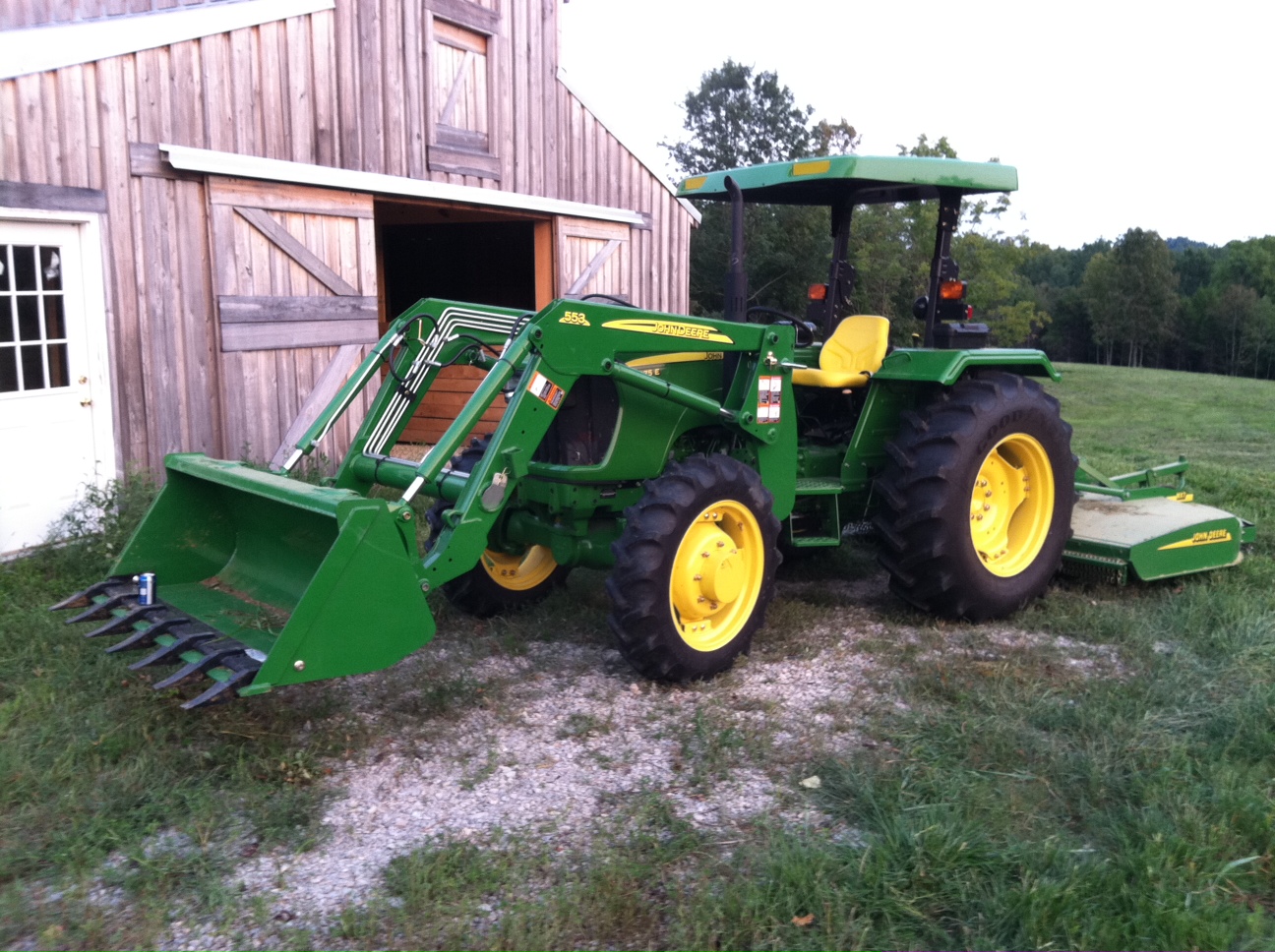

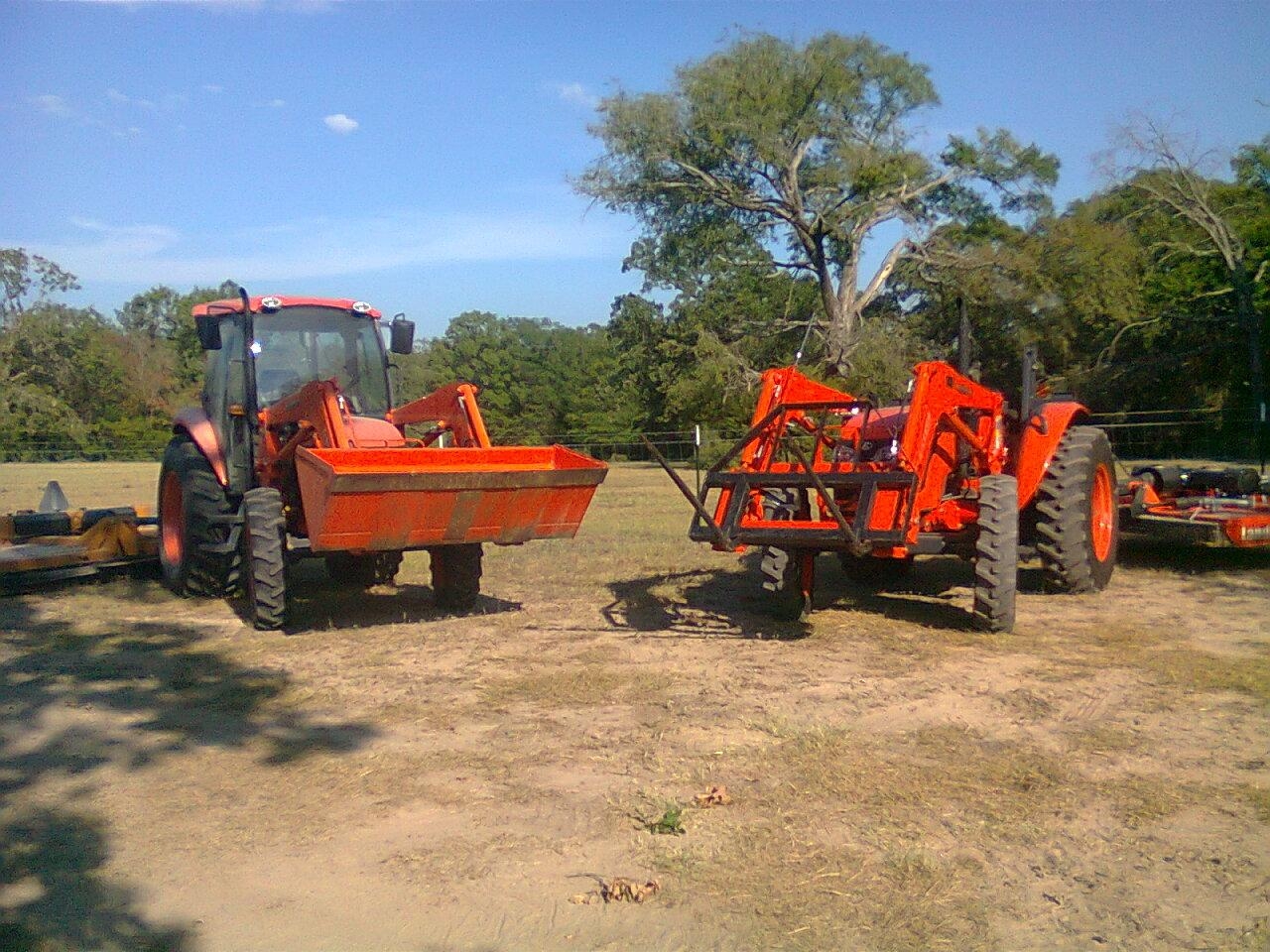

I finally did it!!! I purchased the 5075E, and yes I know if there is no picture it didn't happen, so here it is:
/ 5055e vs 5075e #20
I like the first load u got in the bucket:thumbsup: Not my flavor but it'll due:D
Nice tractor!!!
