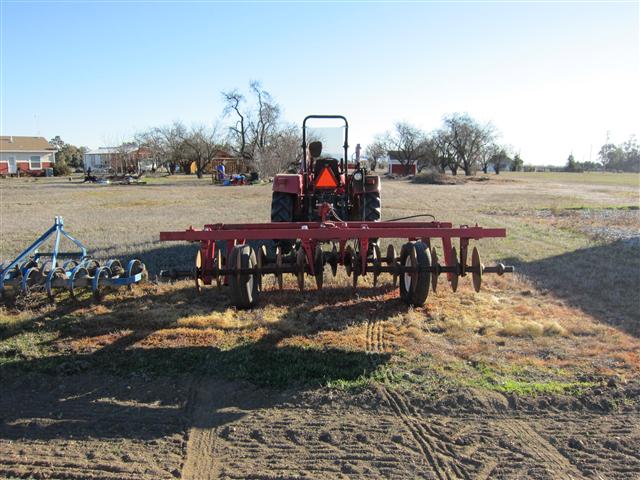

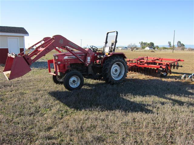

I modified an old Minneapolis-Moline KS-1300 (made by Krause) wheel disc recently ($600 for the disc). It came 13-ft wide with 44 pans on four axles (tandem disc arrangement). It was too big and heavy for my 2008 Mahindra 5525 (55 hp engine, 2WD, gear tranny 8F/2R) so I removed the 4 outer pans from each axle, cut the axles and the axle support beams to length.
In dry soil I can pull it in 4L gear at 1500 rpm on the engine which gives about 5 mph ground speed, which is recommended for this type of disc. I used it last week on my 6-acre hayfield that had been plowed a few days earlier with my 7-ft Towner offset disc.
Good luck
