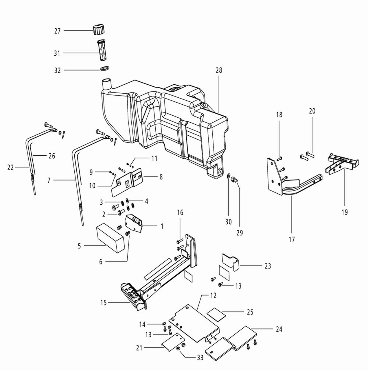

this is the best I can come up with for a parts breakdown of the 5035's fuel tank, although this view is for a 4035, which I believe are somewhat the same except for the extra cylinder for the 5035. Can I assume item 29 is a drain valve?
This image, IMO, is not very helpfull as far as fuel lines used or location of the tank shutoff valve location but it's the best I can find.
Note item 31. That is the screen filter for adding fuel to the tank.
It is in place and has no tears or damage.
Appreciate the input.

Good input Svendawg. I believe I will have to remove the protective sheet metal that is covering the bottom of the tank before I will see that fuel shutoff valve. I'll remove the plate and report back.
The image I posted shows what may be the drain plug as item 21. I did not see it but may not have gone far enough along the tank to see that low-hanging section.
Or it may be covered by more protective sheet metal.
