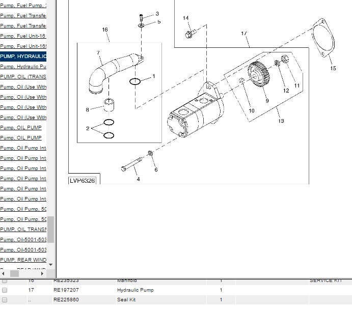

Hey guys i posted in hydraulics and not much luck yet. Loader stops halfway up cycle and goes dead until tractor rests and same thing, fire it up and dies after half a cycle. Ive done this several times and only once did it go up and slowly fall down on its own.
So far tracotor has one yr old hydraulic pump, when it went bad last yr power steering quit. I have power steering when bucket quits.
Ive changed hydraulic control box for loader, checked joystick and cables, checked main filter, and fluid level. Havent checked pickup screen as im getting power steering. Any ideas? Had new fluid last yr
Could a check valve in cylinders be messed up?

These tractors have a tandem pumps, two pumps, one for steering, one for implements. It's possible the steering pump failed the first time and now the implement pump failed.
I not saying just replace the implement pump, but I would text/check it.

So the 5025 has a steering pump? Last time hydro pump went i lost loader and steering. Pump that was replaced was on rh side and is the main pump. Thanks again guys
/ 5025 loader issue #5
This must be a 5225 model, right?

Shes fixed! Took it out brush hogging, that's when it quit last time out in a bit of a bumpy field. Checked loader now and than brush hogging, when i hit a big bump it jarred tractor hard and now it works. I have no idea what could jar lose and i only hope it stays running. Please dont say i didnt plug hoses in right 😁
