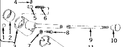

Did some more work on the 5020 over the past few days. I replaced the old leaking steering valve with a rebuilt one and rebuilt the throttle mechanism. I run into some problems with adjustment of the latter and was hoping I could get some help from the forum users.
I have not done any adjustments on the injection pump itself, as I am afraid to mess anything up. Otherwise, I have followed the instructions as written in the service manual. The problem I run into is that when I set the working range and fast idle speed to work correctly (i.e. within the correct positions on the hand throttle), I run out of space on the hand throttle to turn the tractor off (by cutting the gas). If I adjust the screws on the speed control rod to be able to cut the gas off completely, I cannot reach the correct working or fast speeds on the hand throttle. Is the problem with the injection pump adjustment or should I be working on the connection under the steering valve?

My 1st thought is are you pulling out spring(key 6) loaded knob on the end of throttle handle to access stop &/or transport speed positions?

Yes, I rebuilt the entire mechanism and the pull out knob works correctly now. When I pull it out and turn the lever counter-clockwise I cannot slow the RPMs low enough to turn the tractor off (if the linkage on the rod next to injection pump is adjusted so that the RPMs are in the working range [800-2200] when the knob is in the "in position").

I have tried working some on it this weekend and maybe I have some further clues. I noticed some play between parts #33 and #37 on rod #36. I took this apart and found that the hole for spring pin securing rod #36 to arm #37 was over-sized. I found a newer rod and re-installed - no more play. The problem is not solved or much better, however. I noticed that the issue is likely at the injection pump. The arm on the injection pump(connecting to rod #40) has to move a lot to get between low RPMs and shutting down - this is where I am losing a lot of my hand throttle movement. Is this normal? If not, how do I correct it? Please help:anyone:

If speed control linkage has slack removed & one can't control speed to stopping engine then I'll guess inj pump linkage is worn. How many hours are on tractor speed-hour meter?

Yes, there is a lot of movement on the injection pump linkage between RPMs being below 600 and the tractor stopping, without the RPMs changing at all. It is pretty much as much movement in the injection linkage as is required to bring the engine throughout its entire working range. Can this be corrected without rebuilding the pump? I do not have 2K for a remanufactured one? thanks.

I was finally able to repair the throttle mechanism, the problem was found in linkage play. First, the speed tube grooves pushed by the hand throttle were stretched. Second, the bellcrank and the swivel it rotated on were worn, allowing for more than rotary motion. Third, one of the holes in shaft #36 was stretched. I replaced the 3 mentioned parts as well as the foot pedal and its lever and adjusted the mechanism according to the procedure in the manual and it all seems to be working great. Thank you all for help.
