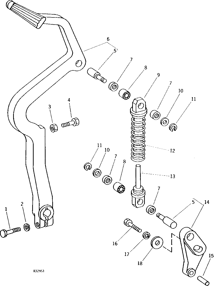

I recently purchased a 1968 John Deere 5020. The tractor appears to start and run very well. I cannot change gears when the RPMs are high (>5000, i.e.: when tractor is not idling). I can hear and feel grinding and the gear will not engage. I imagine this is likely related to a used (up) clutch? Can any adjustment be made before it needs to be replaced? If so, is it through the cover plate underneath - I do not have a tool that is described to use here. Can the stop screw adjustment on the clutch pedal help with this also? I would appreciate any help. Thank you.

My knowledge of 5020's is very limited as dealership where I was employed only sold one that I can remember. Plus the clutch pedal is different from 3020/4020's. From viewing parts catalog I think bolt(part key 16) is the pedal free travel adjusting bolt. Hard shifting could be caused by a "dry pilot brg" on the end off trans input shaft. I agree with jenkinsph on hoping you changed fluids as milky hyd oil rings a death toll for brake pads & pto brake.

I was thinking of bolt#4 to be able to depress the pedal further? Could that help? How can I correct the "dry pilot brg" on the end off trans input shaft? Do I need the special tool to adjust the clutch?

To correct dry pilot brg would require a tractor split. Although I've heard of adjusting PP bolts from underneath of tractor I'm not a big fan of that procedure.
I just thought of something else that might be the non-release problem and that is possible broken pressure plate operating bolt.
As I stated my experience with 5020's is limited and I have no clue if changing adjustment on bolt(parts key 4) will or will not accomplish

I removed bolt #4 in the diagram to allow the clutch pedal to travel further. This has allowed me to shift at higher rams without difficulty. Is this OK? Can I be possibly creating more difficulty for down the line? Thanks again.
/ 5020 gear shifting issue #9
I think you'll be alright as long as when depressing pedal you don't hear any unusual noises or feel the pedal pulsing.
