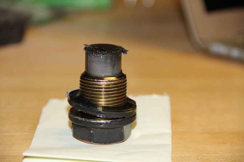

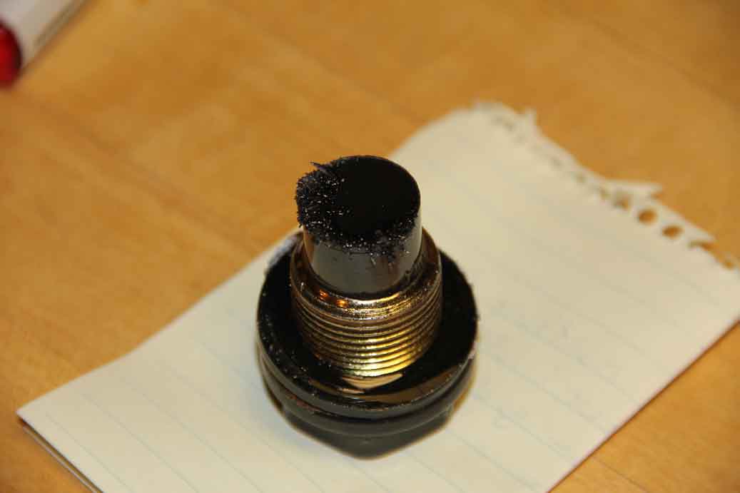

I ended up changing all fluids today for the 50 hour service. The drain plug on the transmission had some flakes stuck to the magnet. How much is normal? Does this usually stop after break in fluid change? I attached a few pics of the plug.
Checking the bolts all around the tractor I found the lug nuts a little loose, not too bad.
All and all it checked out good.

Those pics show what I would call normal.
If your tractor is making metal there will be more shiny pieces of metal stuck to the drain plug and filter magnets, and you will also see the metal in the bottom of your drain pains. Thankfully I don't have picture of what bad looks like to post.
/ 50 hour service #32
That is what the magnet is for, to catch most of that breakin debris but it also shows why the 50 hr. oil change is so critical to get that fluid and crap flushed out of the system.
