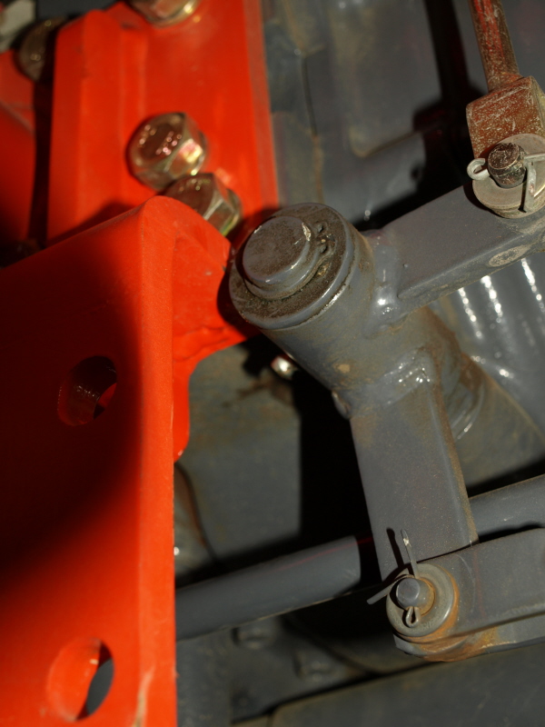

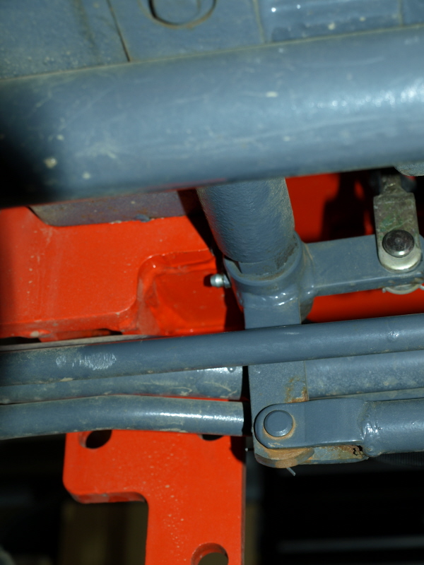

I greased all the fittings I could get to (stupid brake levers, see pics) and drained the engine oil, replaced the oil filter and filled it back up with Rotella 5W-40 Synthetic.
There are 3 zerks that are near impossible to get to with my tools. The zerk on the hydrostat treadle was one. That one I was able to remove the linkage and get the gun on it. The other two (one on each of the brake linkage pivots) I couldn't get my gun into. Take a look at the pictures.
The loader mount bracket is less than 3/4" away from the zerks on both sides. I have a flexible hose on my gun but the end has a steel fitting that links to the zerk and it's probably 1-1/2" long. Disassembling the brake linkage didn't look near as simple as the hydrostat treadle linkage mentioned above. So I left them ungreased but I am not going to leave them that way. Is there a 90 degree fitting for grease guns or should I just take the straight zerk out and replace it with a 45 or 90 degree one?

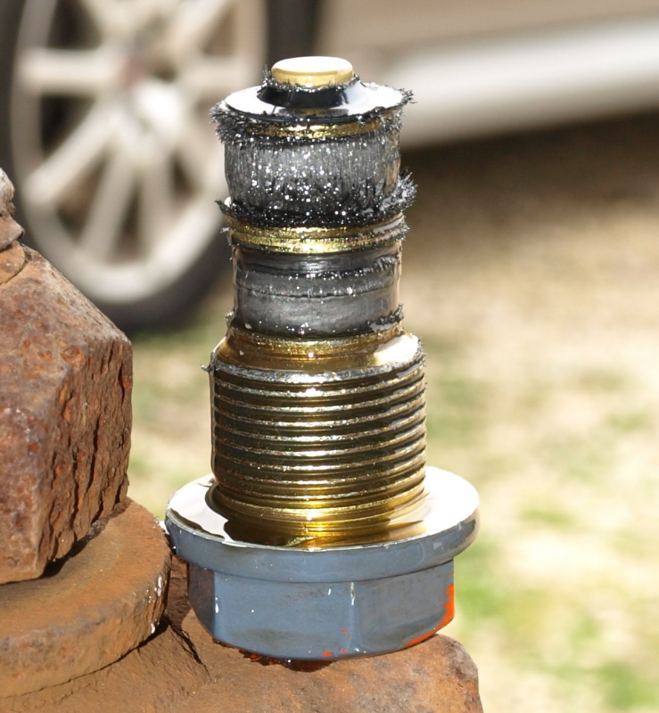

And for those of you (myself included) who have never seen how much metal comes out of a new hydro system check out the pic of the main hydro drain plug. WOW!

I'm actually surprised by how little metal you had on the magnets of your hydro pump. I think I must have had twice that much.
I gave up on the fittings for my grease gun and finally replaced the zerks with 90 degree fittings. I have a 90 degree swivel for my grease gun, but I still couldn't get at two of them.
