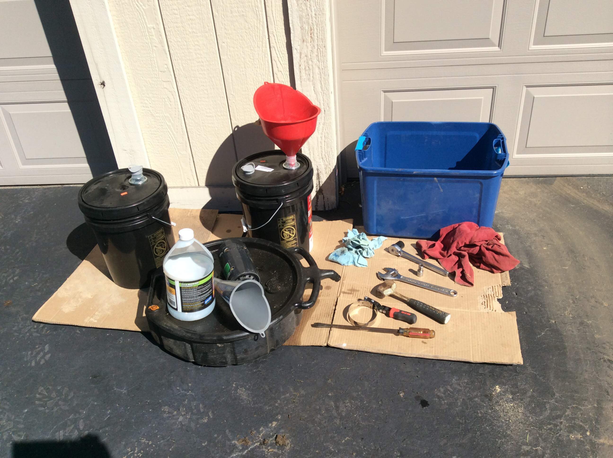

I finished my fifty hour fluid and filter change and it went fairly smoothly. The hydraulic filter was a challenge (see photo) but nothing that a big screw driver and a hammer couldn't fix . If you haven't done this yet be sure to grab the rubber washer under the drain plugs, on a humorous note I replaced a plug without the washer and the drain leaked. I found the washer in the large blue oil container so I thought ok I'll just remove the plug stick my finger in the hole put the washer on and replace it. Well my right finger is in the hole and I drop the plug and it rolls to my right out of reach. So now I have to stick my left finger in the drain hole so I can reach the plug with my right hand all the while laying on my back under the tractor, it's a good thing nobody was around as it would have made a sailer blush what can out of my mouth. I grab the plug and washer all the while trans fluid is pouring out with the finger exchange. Replaced and mission accomplished.

Note the blue plastic storage bin in the photo, this is what I drained my oil in (15 gal container I believe) then I used the red funnel and the cut gallon jug to put it back into the original containers. My fluid was clear also. I thought about taking the rear wheel off too but opted for the screw driver and hammer method as recommended by Michigan Iron. Most of my spilled fluid was down my arm then dripped to the floor. 😡
