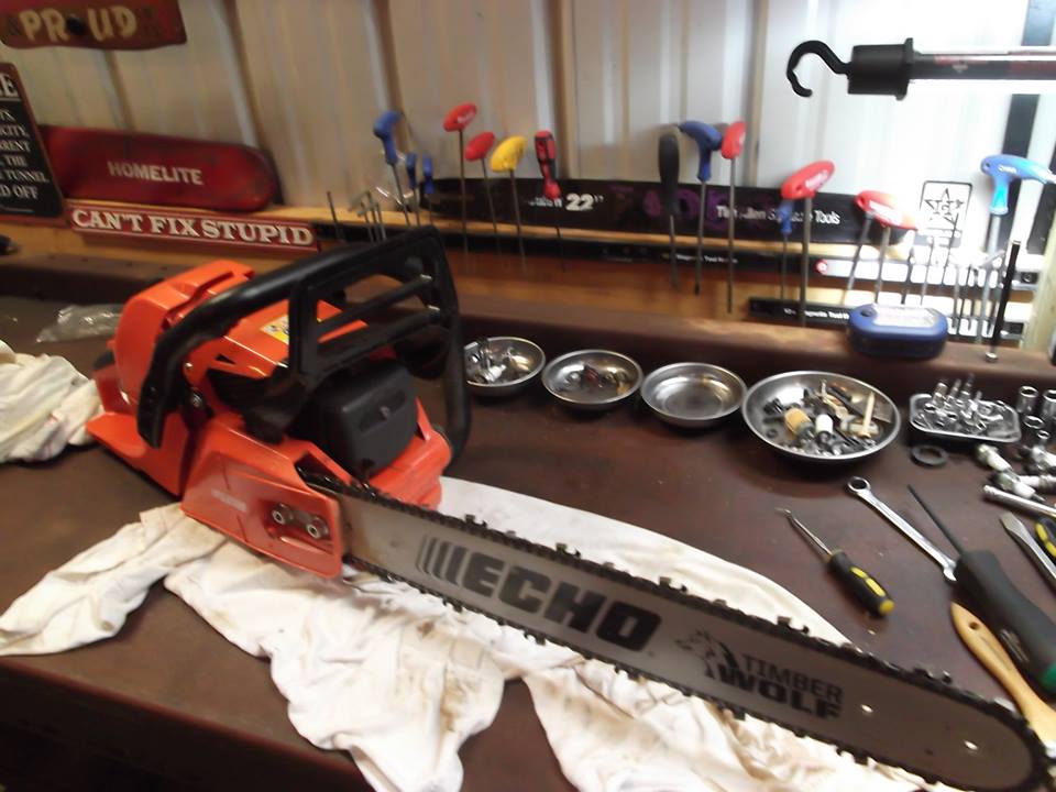

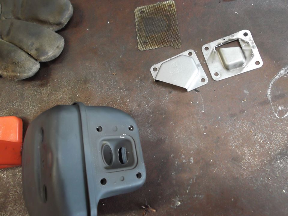

I had a 590 to test out that I bought like new. Check that H setting. They like it rich IMHO 12.1-12.3 was the sweet spot on my stock muffler modded one.
They come to lean.
Back half of thread info on one I got etc. http://chainsawrepair.createaforum.com/echo/cs-590-wolf-review-bone-stock/

Same here on that 590. Against the stop on H and was still to lean. Pulled caps.

The echo CS590 is your best bang for the buck.
   / 50-60cc Saw Recommendation #30
Agree ! Between Timberwolf / MS291 / and Husky 455 (never ran) if I had to choose one Echo would be my pic as far as best bang for $ . MS 291 I got new from managers discount from an" insider" at a Stihl dealership , so I did good on it . All my saws are stock .
BTW I have always been told CS590 is same as a Shindaiwa 591 . I'am just a part time saw home owner user not a pro .
