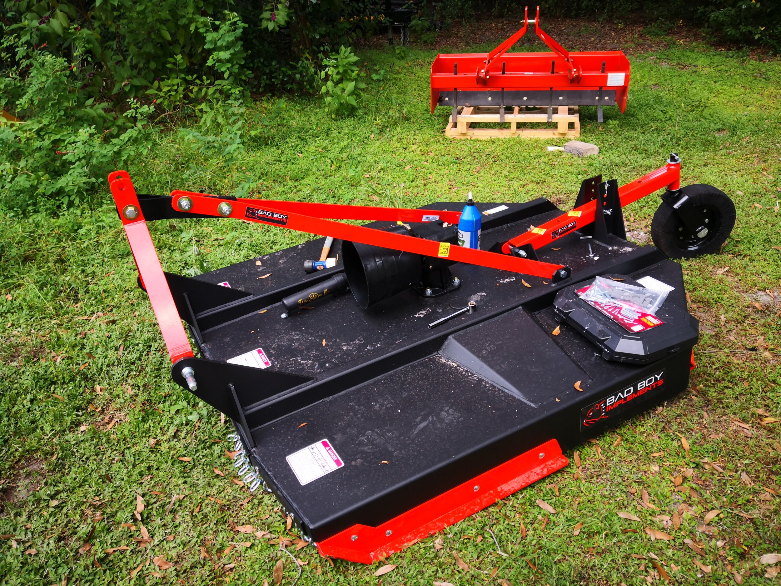

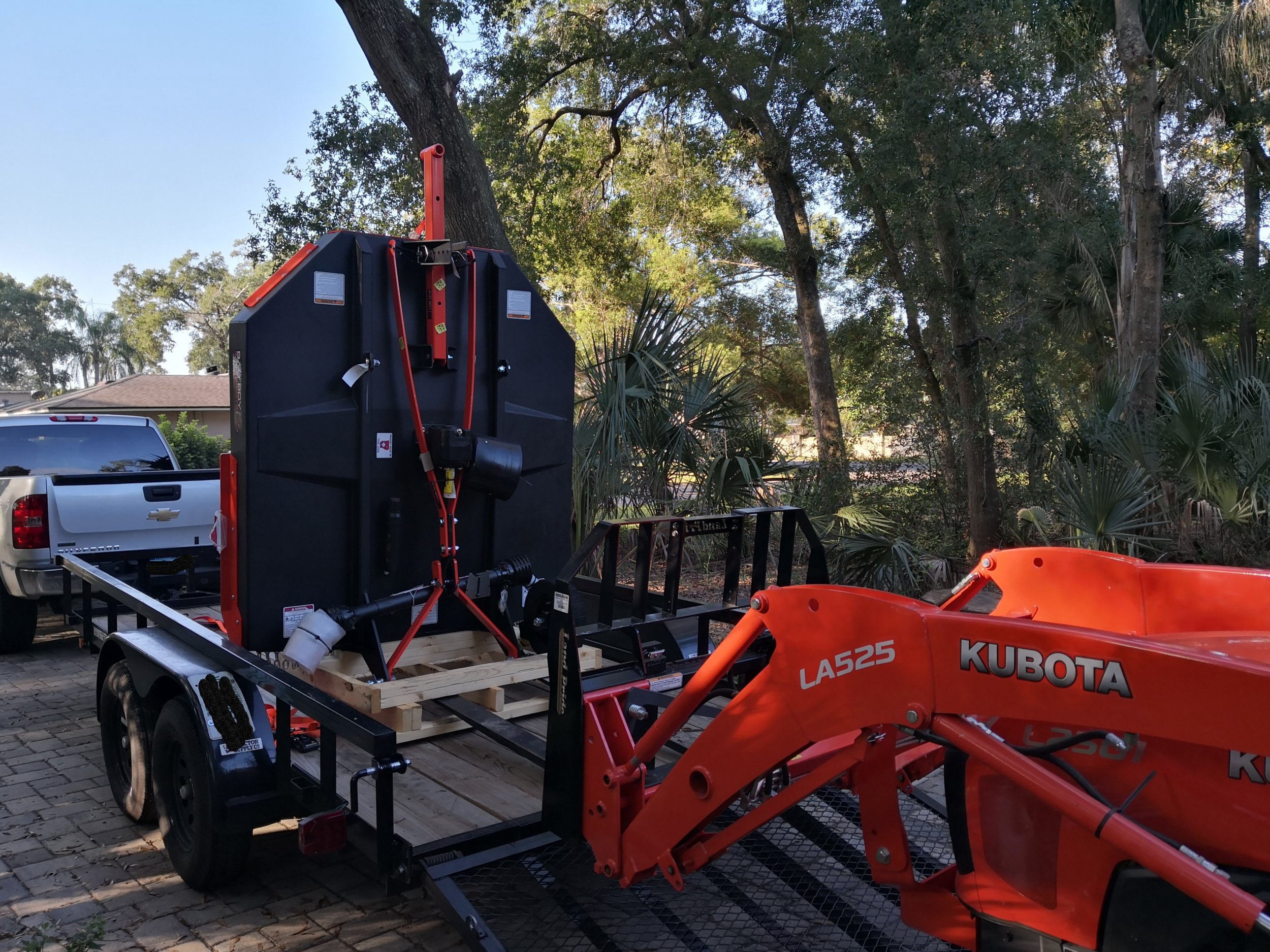

I bought the BadBoy…$1800 all in. Found it at a Tractor Supply over on the coast. It had just arrived.
I had a couple extra straps on the unit and it traveled home just fine. Was able to use the pallet forks to pull it off the trailer, using my box blade as counterweight.
This is a heavy tool and I’m struggling to get it on the 3ph.
For the money, this was the best product.
To address the auction comments, rotary cutters just don't seem to be resold often here in FL. I went to a couple equipment auctions up in GA this past summer - and watched a Frontier, Land Pride, and CountyLine go for 75% of the new prices. There's just not value in buying used right now for this equipment in my location.
Finding dealers with them in stock is harder. Of my original list of 5, two were in Georgia, one was in South Carolina, and I lucked upon the one I bought here 35 miles away from home.
I like the looks of the Bad Boy. It has lift pins instead of shackles for the lift arms. Nothing wrong with them, but they will need attention from time to time. If they get loose, they mess up the threads and must be replaced. Not a big deal, not expensive, but can be a bit aggravating. Good luck with your new cutter.
Take the nuts off the lift pins and pitch the lock washers in the trash. Put red Loctite on the threads and tighten the nuts as tight as you can get them. Put a long punch or tapered bar in the lynch pin hole to keep the pin from turning and use something on the nut with at least 18" of leverage. There's no shame in using a 24" pipe wrench.

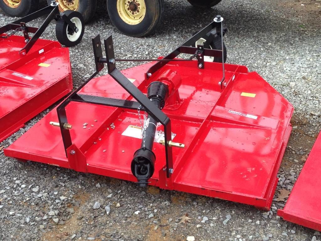

Looks like a Big bee.
I bought a used Big Bee Agri 5 for $150. Busted stump jumper.
Replaced the stump jumper with a heavy duty one and blades from Tractor supply.
$400 total in the thing and it just doesn't quit.
Needs some reinforcing in a few places for the 3 point but otherwise it has done a great job.
If you're under 20-25 PTO HP this is a good option since it is lighter and doesn't suck much HP.

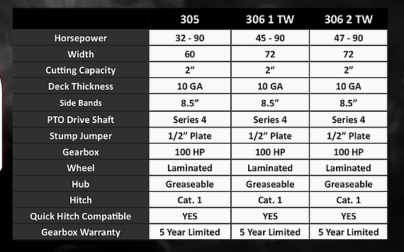

Dont forget the USA made Titan Implements.
The heavy duty smooth top 300 series, model 305 is a 100HPO box, 10G steel, 1/2" stump jumper and is a heavy built and thick walled machine. I like mine a lot, but mine is a 72".
Not a big bee. They (LMC) make their own products Rotary cutters, Disk, and other ground engaging implements at their facility, about 50 miles from my home.
I have this cutter behind my MX5100 and have had no issues with it.
You can get them with ha higher HP gear box but I have seen no need to do so.
I have run this small unit behind my CX105 a time or two. It did great, just looks funny.
   / 5' Rotary Cutter Options #33
IS that a 5' cutter?
RC, what is the difference between '306-1-TW' and '306-2-TW'?
Not seeing anything in the documentation. Thanks!
