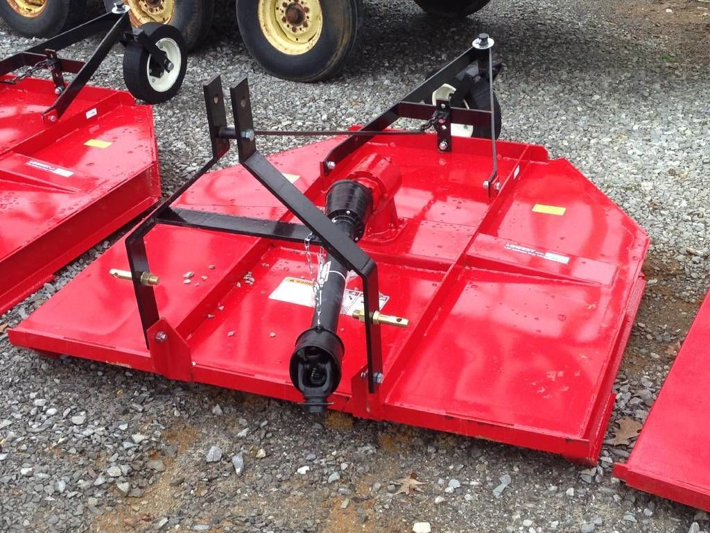

I have a 5 ft LMC andy 500. This has been the toughest cutter I have. The sides are channel not just bent around thin steel.
If you hit something with these cutters with thin steel sides, they will just bend. This 6'' channel doesn't bend.
1,150.00
In the pic I posted, you can see the sides are made with 6'' channel
