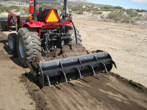

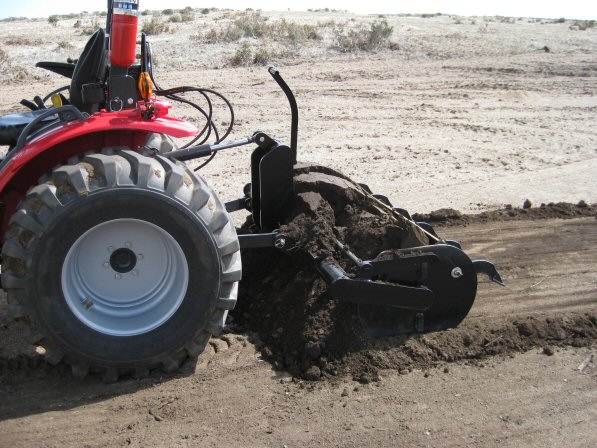

This is overrated IMO. I have a Frontier BB1284, which is made by Gannon Industrial. The blade weighs 1250lbs and is built like a tank, but no supports to the rear. Hydraulic rippers so you don't even have to leave the seat for adjustment. See the pictures, and no, it doesn't get pulled with the tractor in the picture.

60"-66" max. Any bigger and you will be hating life. With the tractor not being ballasted, it is just to light to make good use of anything bigger. If you can find yourself something in the 600lb and up range you would be better served. You should be able to load your box and pull it as shown in the picture under almost all conditions (meaning uphill).
