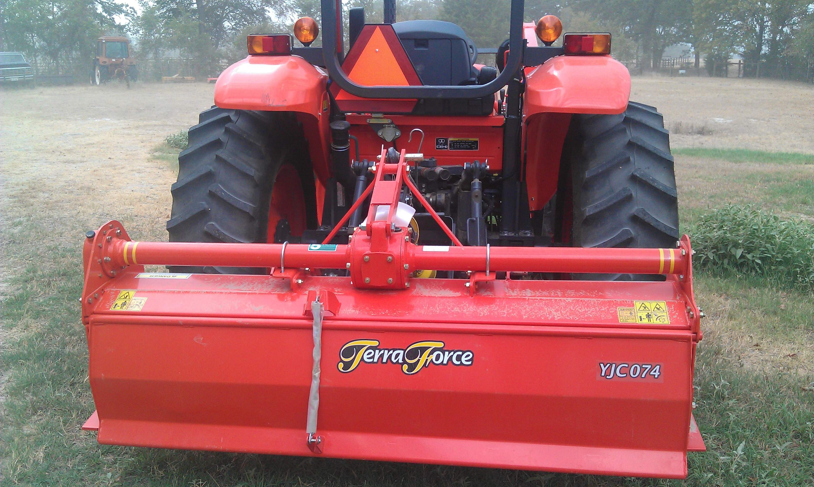

The YJR is there gear driven,mine is the YJC chain driven model and yeah tilling width is 74". I'll have to look what I paid dont remember but its made by "Ansung"...tractorhouse has a YJR 62" listed for $2195
