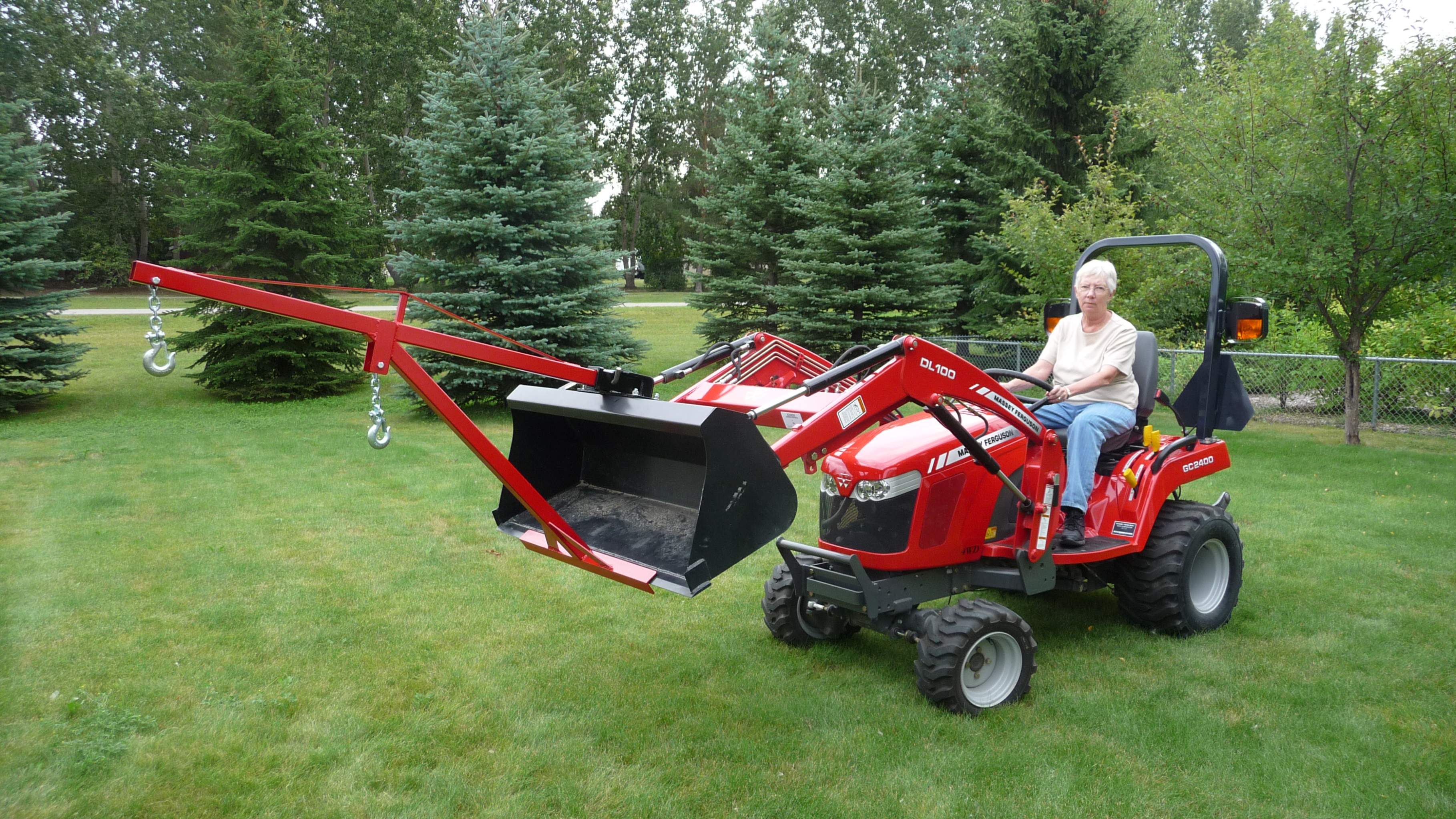

Got around to building a little boom for my GC2400. One pin in the receiver and I can carry it in one hand.
Saves my creaky back.

Please allow me to caution you........
The "EXTENDED" arm that you now have with this boom is a problem. First it GREATLY increases the lift "moment" thus greatly REDUCING the weight that can be lifted.....(Try extending your arm with a phone book in your hand) AND....
More importantly, if you hook up to something heavy it will likely RAPIDLY lift the rear end (rear wheels) of your tractor...THROWING YOU FORWARD, POSSIBLY INJURING YOU........
I have chained small, 3" sapling stumps directly to my bucket (no arm or extension) raised the bucket only to almost LAUNCH myself out of the seat as the rear of my Kabota came rapidly off the ground.
Nuff said..........:confused3:
/ 5 ft. Boom - Cheap and easy
The extended arm is not a problem as you have no idea what it will be used for.
250 lbs into the back of my F-150 would be max. I weigh that much so testing was easy.
Keep your seat belt fastened to prevent injuring yourself when exceeding the capablities of your tractor.

My thought would be feather the hydraulic don't just lay into it and when the rear end starts to lift you know it is to heavy ,don't add rear weight you could bend the front axle ,I've seen that happen.That looks like a light duty tractor do a light duty job and save your back and there should be no problem .Most problems happen when the nut on the steering wheel is too loose.
/ 5 ft. Boom - Cheap and easy #9
I built one for my 1026r that extends to 8 ft. I calculated the Max load to be 250 lbs with caution and backhoe for counterweight. I haven't broken anything but I keep it very low and go about 1 Mph

Trying to pick up a load that is too heavy in the extended boom is NO different than trying to lift a load in the bucket that is too heavy. The hydraulic pressure will raise until either the hi limit lets go or the pump peaks out. Either way the loads on the front axle will be the same and so will the tendancy to lift the rear axle.
Things can get touchy however if you get the load higher or farther out front than normal and then have it start to swing.......
/ 5 ft. Boom - Cheap and easy #12
And adding weight to the 3pt will remove weight from the front axle. Imagine 5000 lbs on the 3pt, where would the front axle be.. In the air of course. This is a gross exaggeration to help prove a point. But the point being if you add weight to the 3pt it will lever up the front of the tractor around the fulcrum of the rear axle. So add weight to the 3pt.

Thanks for all the comments and info. This thing is for very light duty such as, rear mount grader blade, 80 lb. generator etc.
Note there is another lift point 1/2 way on the boom which could lift a little more and is handy to tie the load to stop it swinging around.
I use it slow and carefully so I don't expect any problems. ( My 73 year old back is quite happy about it too.)
Harvey

I think the key is your last sentence. Geometry makes a huge difference. The hydraulics and weight distribution on my 2320 are such that I can't get in much trouble lifting from the ground with the loader if I have my box blade on for ballast. However, I once tried to pull a bush out of an elevated landscape terrace so the lift started about 5 or 6 feet above the ground. Things got real exciting real quick and I learned a lot about lifting geometry. I'm going to get some serious ballast before I try anything like that again.
/ 5 ft. Boom - Cheap and easy #17
That's a very good design.
I did something similar and used it to lift heavy I beam posts for my new house. But your's is made a lot better.
When you get to your limit on lift just curl the bucket to get the boom more vertical before the load is lifted. Curling the bucket will not lift as much as raising the bucket.
