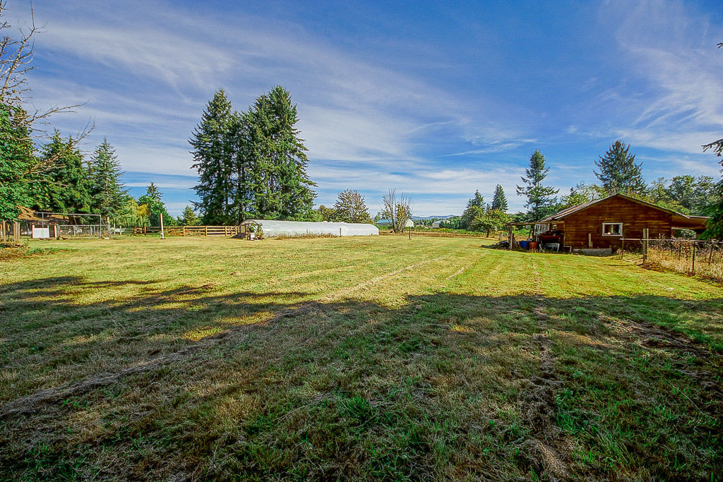

This is what I'm trying to avoid - I know owning land of any sort of size will mean more time spend taking care of it, but I really don't want to spend an entire weekend mowing. I'm sort of leaning towards a tow-behind mower of some sort - finish mower or brush hog or something in that line for the back 2.5 acres - its basically a large slightly downhill rectangle of broad-leaf grasses and other more brush-like plants. When Last we were out there it looked mostly grass, but in pictures you can see there is other brush that grows also. I've included some pictures - not massively helpful I'm sure.

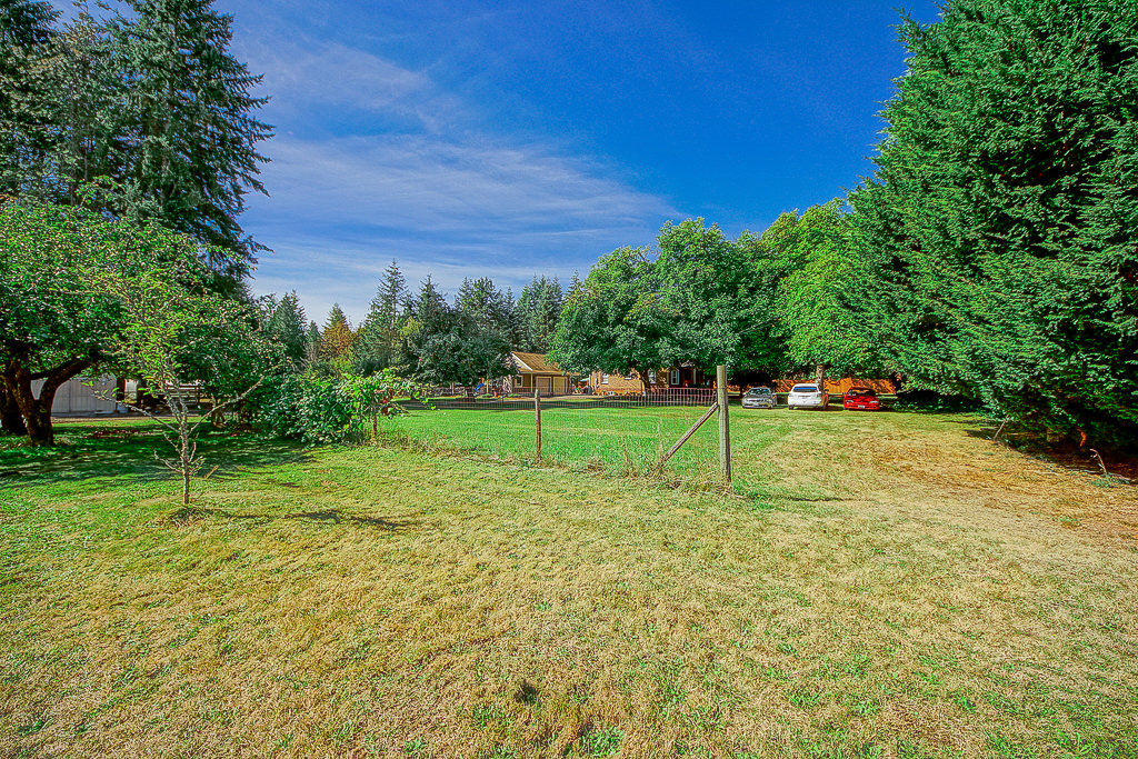

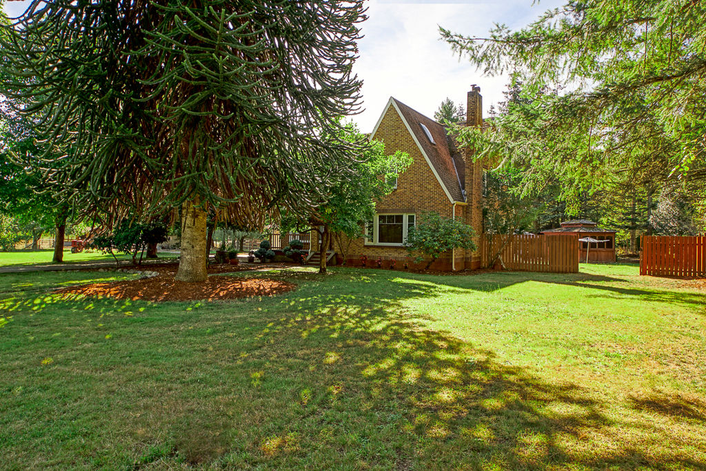

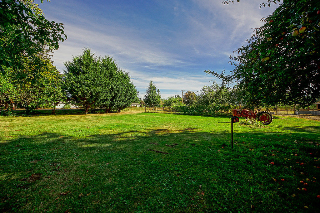

Front 'lawn" areas

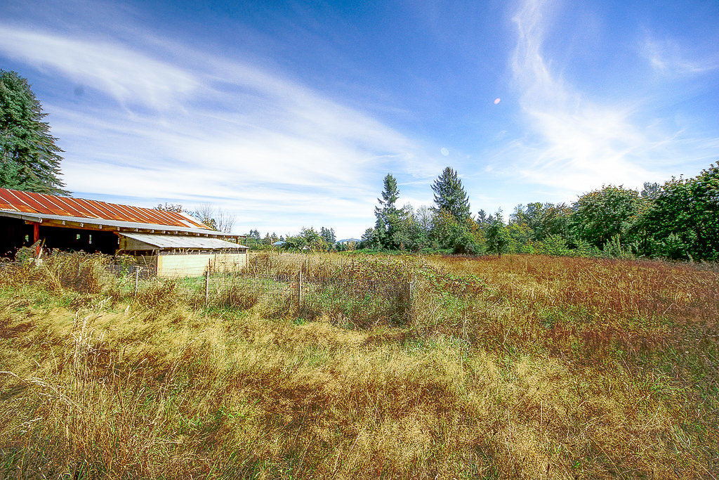

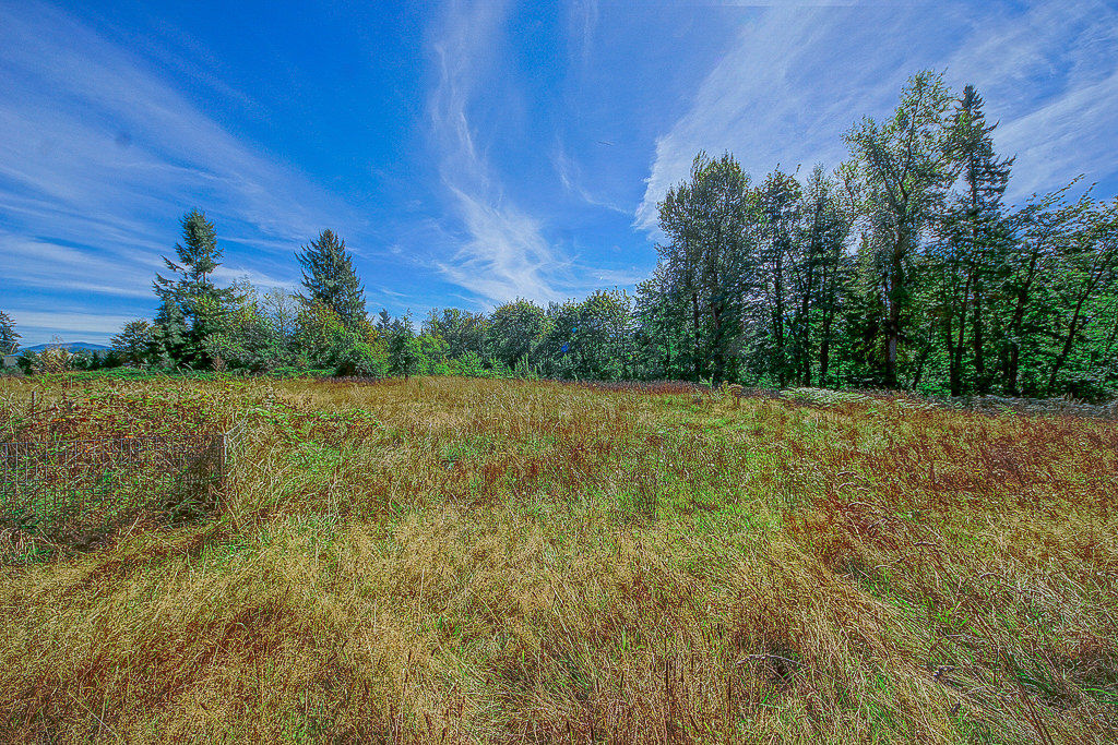

Back "pasture" - hard to get a shot of this ....

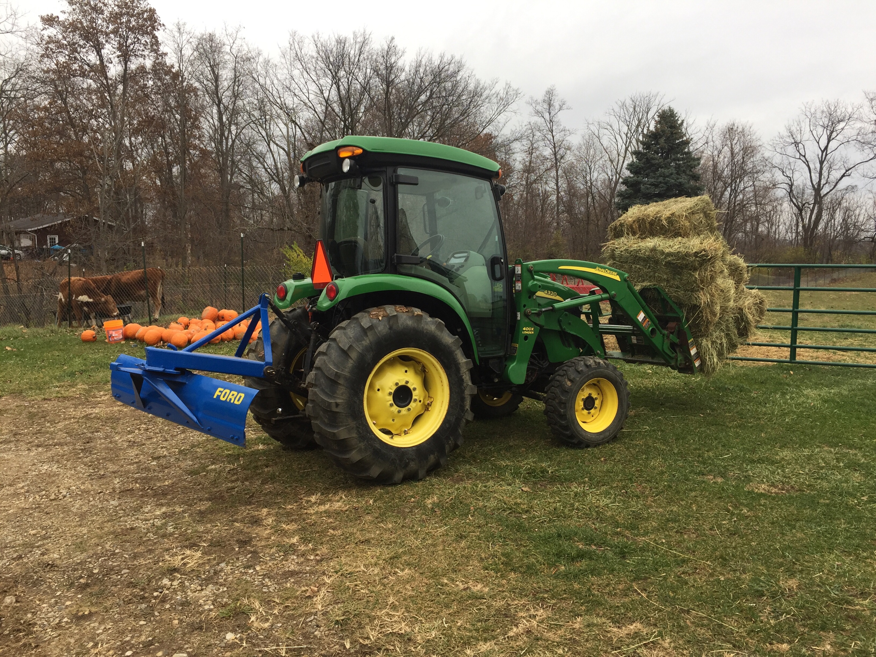

Ok - so I figure the heaviest lift would be a pallet of 4 3-tie hay bales. A 3-tie bale is, give or take, 140lbs, so we're looking at 560lbs, and that would be forward of the bucket because obviously we'd need forks for the pallet. Now that's maximum "we want to kill ourselves today" sort of weight. If we were to be more generous to ourselves, we might do 4 X 2-tie, which is more like 400lbs. Or we just do three bales at a time, 420/300 Lbs respectively. The lift capacity of the GC1720 and its bigger brother, the 1726E for example differs by 250lbs @ 580lbs and 830lbs 19" forward of the pin on both models. The MSRP differs by $8000 - so while I know the 1726E has several significant upgrades over the GC1720, looking only at lift capacity, that's $3,200 per extra 100 pounds of capacity, or $4000 per additional 3-tie bale. What I don't know is how much lift capacity is reduced when using forks versus the bucket, but my guess is an extra trip with the GC1720 is a better deal than paying $8000 to carry two extra bales. I need to check out alternatives to the Massey products and look at used tractors as well, but I figure I need at least 450lbs FEL capacity if using forks and a PTO than can run a 60" brush hog or finish mower - so 20HP at the PTO?

Go by the lift to full height figures, that will give you a better idea of what the machine will lift, you will have at least that number on forks I would guess.
Also what your not thinking about is how much Real estate these bales will take up on the loader, on my 4320, 5-6 small square bales 40-60lb bales is all I can stack without losing bales on transport. IMG_6634.JPG
So you might be limited on bales based off the size of your forks of pallets, my forks are 42in long. Pallets are I believe 48 to length.

After seeing your pictures I am still thinking the 2038R along with a push mower would be a good fit. One nice thing about a push mower, just because the mower has to run under bushes and low hanging trees doesn't mean that you have to. Most of your place is wide open from the pictures you posted. A 2038R with the 72" auto connect deck would make quick work of the entire place. The ride would be much smoother with the larger tires and you could mow at a higher ground speed. This would cut your mowing time in half or less compared to the best D series with a 48" deck.
Once you are settled in you will find a lot more uses for a fel than moving hay bales. You may also decide to improve the lawn and pasture areas and get them really smooth with new grasses. This tractor would be a good fit for these jobs with box blade, tiller, rakes and other tools. For your uses I would not fill the rear tires but would use a rear attachment or weight box with the IMatch quick hitch. Dropping all the weight for light mowing would be fast and easy to do.

From the photos, looks like you can easily mow the "lawn" areas with any riding mower. Anything from Deere, Kubota, Husqvarna with a 48" deck would work.
For the "pasture" area, I think that you have a couple options:
- Hire out someone with a tractor and a shredder/bushhog/brushhog and have them do the first mow on it so that you can try and maintain it after the first mow with your riding mower for the rest of the season. Repeat this process as necessary with the growth of the grass.
- Hire out someone and have them mow it as needed. Sit back and enjoy your beautiful pasture while they mow it!
- Purchase a tractor and a shredder/bushhog/brushhog and do it all yourself. Most of us on this forum are this type - we like to do things ourselves even if it involves lots of work and some expense - we enjoy it!

Third option I think, although given that the back pasture looks much more "grassy" now than in the pictures, I wonder if you couldn't maintain it for the season with a riding mower once you've knocked it down once or twice.
Minimum 60" mower deck. Unless you can ride sideways on the slope consider AWD for the lawn tractor, so you get braking ability going down hill. ?You probably will not use the Backhoe very much, but it's handy to have it around when needed. It would probably be less expensive to rent, but way less convenient.
