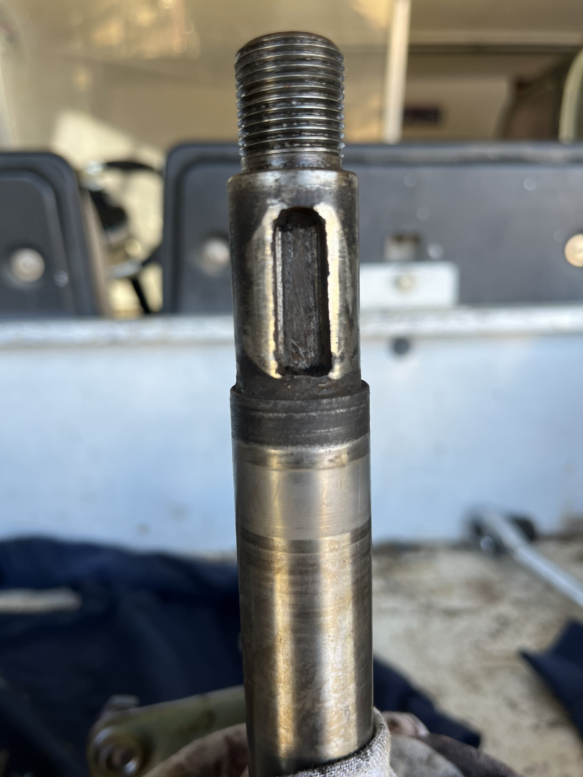

Mar 16, 2023 / 4x4 front axle #1 K Kstan New member Joined Nov 11, 2021 Messages 11 Tractor Yanmar1401D Why does my toe change when going backwards and then when I go forwards ?
Mar 17, 2023 / 4x4 front axle #2 W winston1 Super Member Joined Dec 16, 2009 Messages 5,615 Location gilmer tx Tractor Bobcat CT235 Are you talking about front axle toe in? If so, worn components are likely the cause.
Mar 17, 2023 / 4x4 front axle Thread Starter #3 OP K Kstan New member Joined Nov 11, 2021 Messages 11 Tractor Yanmar1401D Yes talking front axle . What components are we talking about rod ends are tight . I’m saying the toe changes an inch each direction I travel

Mar 17, 2023 / 4x4 front axle #4 Eagle1 Epic Contributor Joined Jul 4, 2003 Messages 28,026 Location Viburnum, MO Tractor Kubota BX2200, LS XG3135H, Grasshopper and Yazoo Zturns Time to jack it up and see where it moves by pushing/pulling the wheels. Got to be something worn, bent or broken.

Mar 17, 2023 / 4x4 front axle #5 R RustyA Platinum Member Joined May 9, 2018 Messages 729 Location Northern WI Tractor New Holland Boomer 40 Cab Pretty much it has to be one of three things... Loose lug nuts Worn inner or outer tie rods Worn or loose bearings

Mar 17, 2023 / 4x4 front axle #6 R repete Veteran Member Joined May 26, 2008 Messages 1,285 Location SW Washington Tractor L2550DT IH584-4WD Or loose steering gear box.
Mar 17, 2023 / 4x4 front axle #7 R RustyA Platinum Member Joined May 9, 2018 Messages 729 Location Northern WI Tractor New Holland Boomer 40 Cab Steering box might cause play in steering wheel but should not affect front wheel toe-in...
Mar 17, 2023 / 4x4 front axle #8 W winston1 Super Member Joined Dec 16, 2009 Messages 5,615 Location gilmer tx Tractor Bobcat CT235 Eagle1 said: Time to jack it up and see where it moves by pushing/pulling the wheels. Got to be something worn, bent or broken. Click to expand... Ditto.

Mar 17, 2023 / 4x4 front axle #9 JasperFrank Elite Member Joined Nov 23, 2018 Messages 3,107 Tractor Ford 1220 Or a broken C-clip that holds the whole lower axial assembly in place.
Mar 18, 2023 / 4x4 front axle Thread Starter #10 OP K Kstan New member Joined Nov 11, 2021 Messages 11 Tractor Yanmar1401D Look like the woodruff key slot at the top of the king pin is worn Attachments 2132FE95-04C6-4AA2-89FB-43056057C9B1.jpeg 1.5 MB · Views: 146
