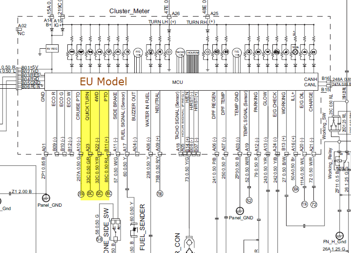

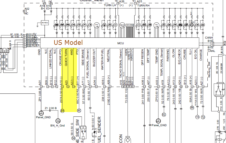

No. Some of the lights are only active on the European models. The lights are in the dash but only light during the initial "test" when you turn on the ignition. Traced out the wiring diagrams and could see the terminals on the MCU on the US drawings have no connections but on EU drawing it shows circuits for 4WD and QT (for example) that are not available here. I looked to confirm whether the wiring harness had anything near the switch location to tie into for adding a micro-switch to the lever but the wiring (for the switches) is not there, also indicated in drawing. The switch would be right above the parking brake. Nothing for QT/4WD but that is where the OBD2 port is. The QT (quick turn) feature uses steering position sensors to bias the hydro to the rear wheels to assist steering.

You said that your DK45 has a switch. My DK4510 has a lever instead of a switch; there is nothing to even tell the MCU to turn the light on, much less to tell the MCU to turn on the 4wd solenoid. The DK10 Series apparently dropped that feature for the US market. The only thing that we get here in the US is a light that momentarily turns on when you turn the key. No switch, no wires, no solenoid, just a lever.
