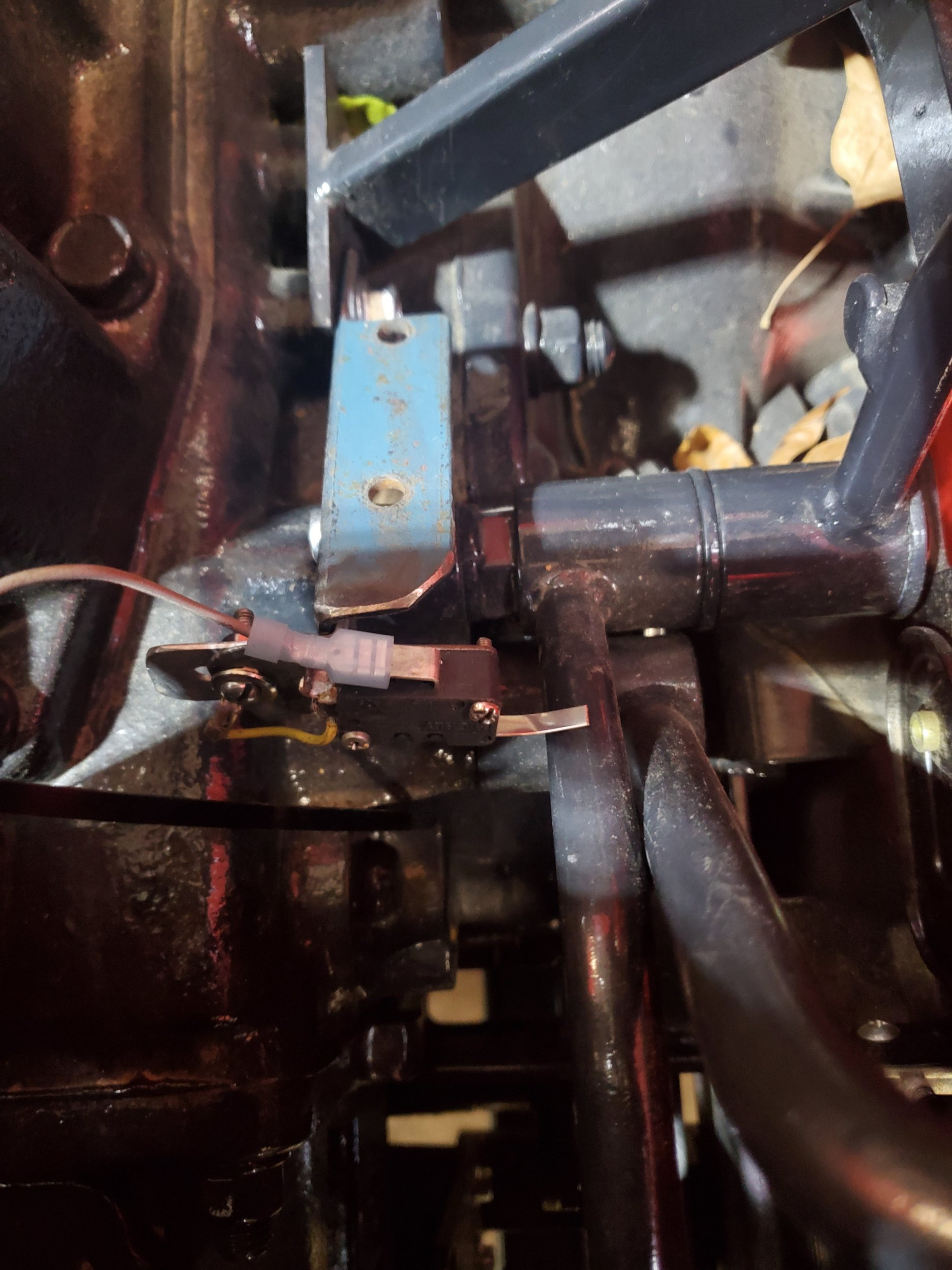

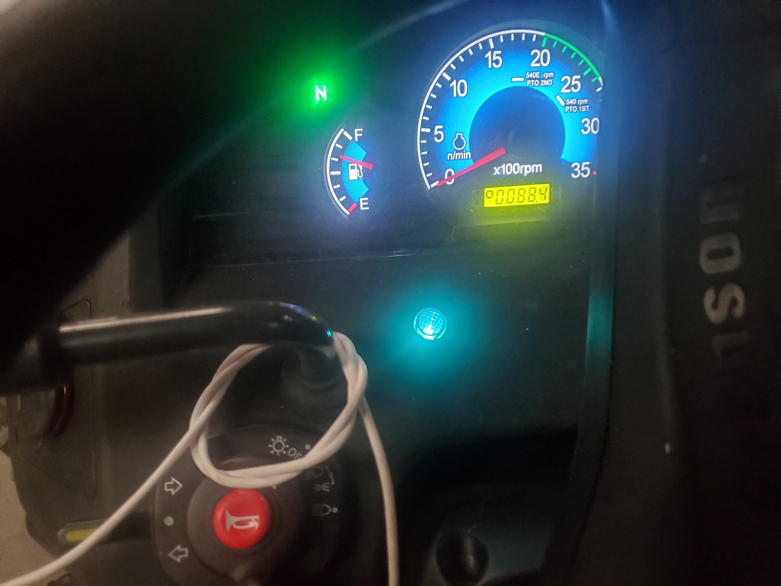

I dont like driving on 4WD when it is not necessary since my property has asphalt roads and i feel it increases front tire wear unnecessary.
It was easier then expected.
/ 4WD indicator light #2
I also added a working 4WD light to mine as well for the same reasons as you. However, I used the 4WD light that comes with the dash and that Branson didn't use. Pretty easy mod to do. I also made the Neutral light work as the older models (2018 and older I think) didn't come with it working.
I made a post explaining the entire process here: Parking Brake Light?

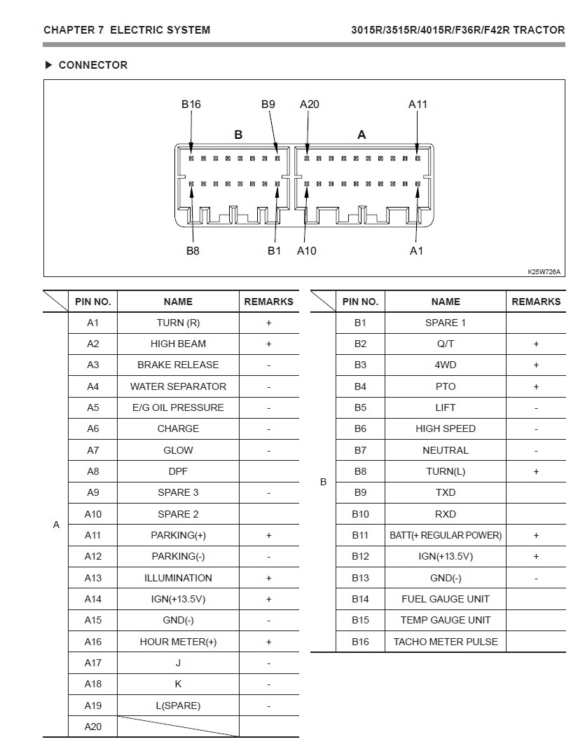

Oh, I was looking on the picture, it shows only pto and 4wd indicators.
Do you remember which wire goes to the 4wd light?
#9
Great, i'll use this to change my design.
Thanks a lot.
Now i need to think how to reuse the hole i made for my light :) Will keep me busy for a while
