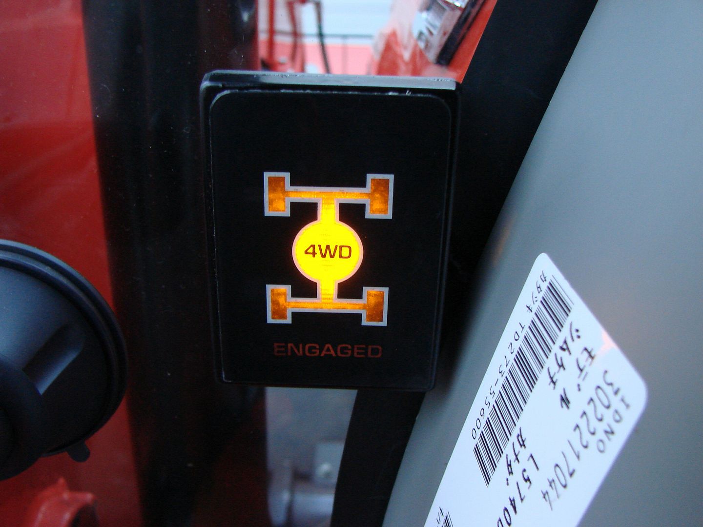

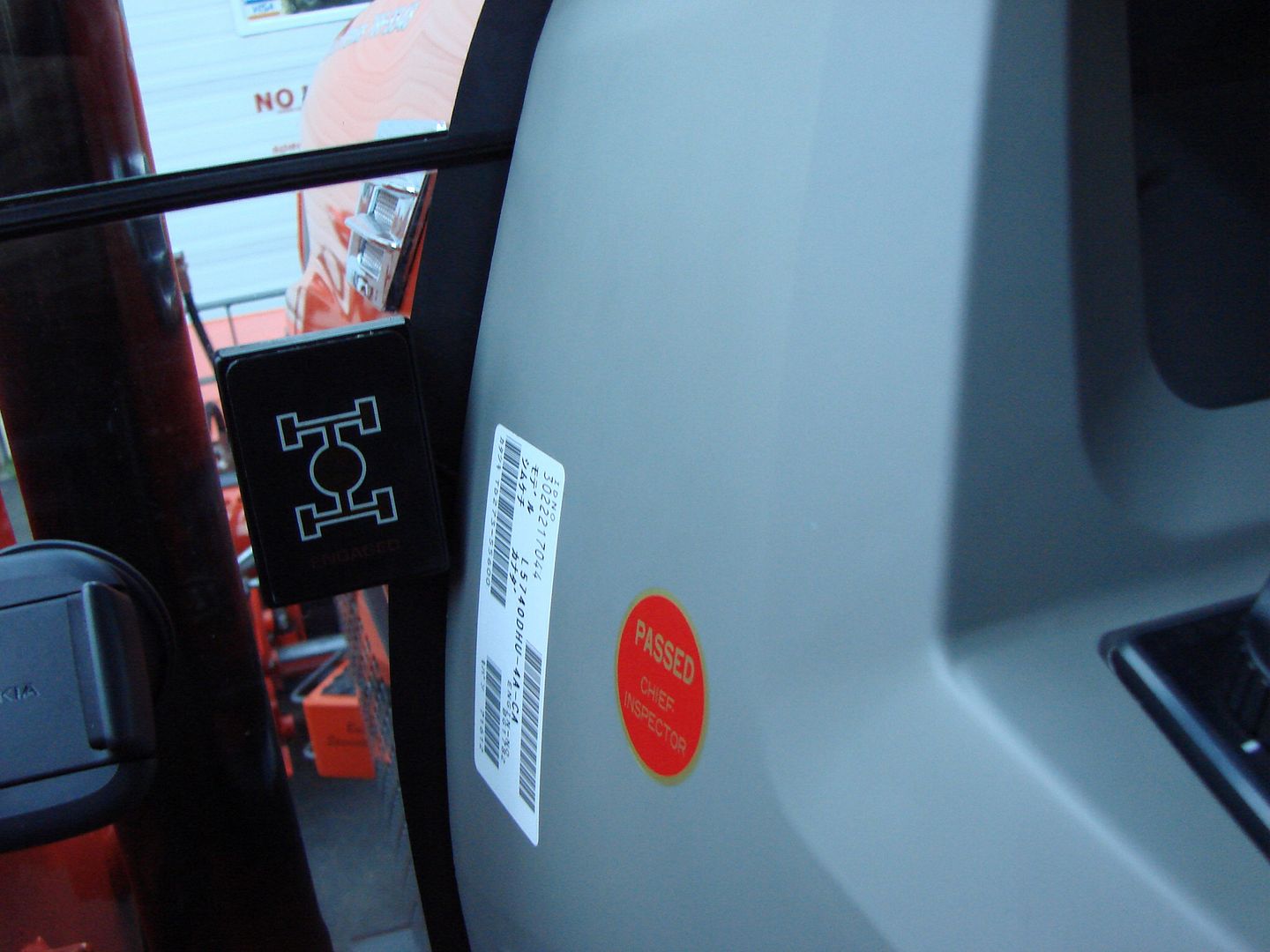

I doubt there's allowances for installing a 4x4 indicator on your machine. There wasn't one for my 5740 so I fabricated one for it.
/ 4wd indicator light? #6

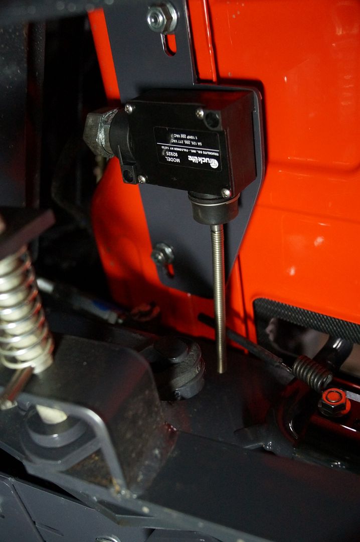

Love the light....where did you mount the sensor and what type of switch is it....???
/ 4wd indicator light? #7
I was going to offer up a suggestion but after seeing this one, that's what I would want on my tractor if it didn't have one.
I used a switch like this. This one is on my BX but it's the same as I used on our 5740. It's mounted under the cab by the 4x4 lever.
/ 4wd indicator light? #9

I found a photo of how I hooked up the switch to the 4X4 linkage below the floor just in case someone was interested.

Thanks 4Shorts, I really didn't think there would be a prevision but though it was worth asking, the way you did your switch is what I figured I would do if I had to make something. Not sure what I'm going to do for a light just yet.

Your more than welcome. For an indicator light I got an old 4X4 display out of an old Dodge Power wagon. I took the face off the display and mounted to a LED clearance light that you can practically buy anywhere. Worked out great. :thumbsup:

I like this! The thing I am not sure of is where to find the switch? Want to give a clue? Just an indicator lamp when in 4WD would be a great start.
/ 4wd indicator light? #17
Varmint you wouldn't make a good private detective :laughing:
If you Googled the part number on it you'd find it for sure. It's actually a fork lift back up alarm switch but I use them for other things such as this. I bought this one at my local truck center. :thumbsup:
It's made by trucklite 92925
