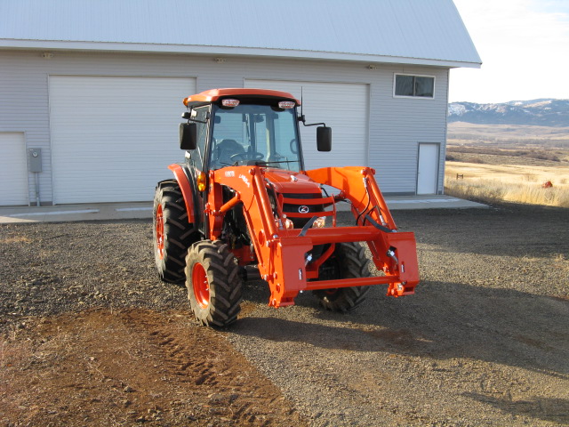

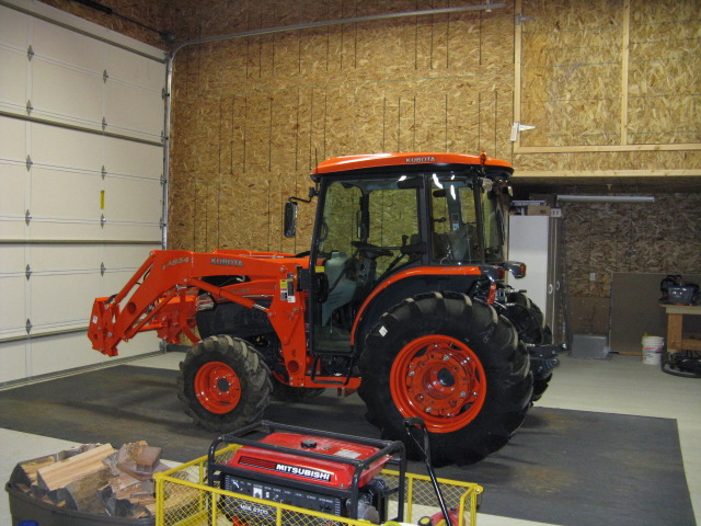

And so are many of the other here who have posted regarding the L5740.
Wow!
I took delivery of a new L5740HSTC yesterday, with the LA854 FEL, block heater, 2 rear remotes, front FEL third function remote, work lights all around, Fit Rite top link, 1000lbs of rear wheel weights, rear R1's filled with Rim-Guard, and hard-mount QA power-beyond ports for my BH, attached next to the rear remote outlets.
I upgraded out of my 2005 L5030HSTC. I kept my fairly new Michelin front tires and toothbar/grapple equipped front bucket from the 5030.
I must say that even though they sort of share the same platform, the difference is considerable.
The power, the HST plus features, the interior layout, seating, all much better...even the size seems beefier but maybe that's an illusion.
I bought this sight unseen but based upon considerable research with lots of information from you gentlemen. I am not disappointed.
Thanks to all who contribute here.
P.S. Household Six also added to the logistics with a B3000. Her name for her new tractor: Honey Badger.

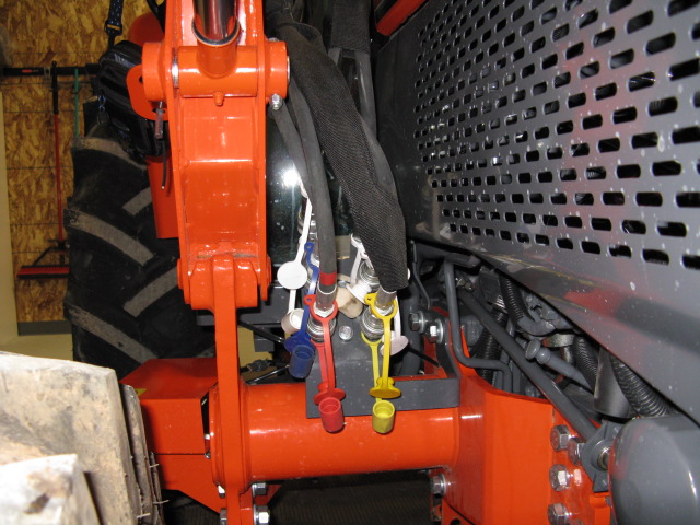

The FEL and hydro QA's are much different....larger QA's, different location giving more visibility through the cab window.

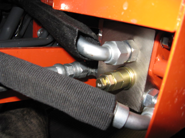

I added (dealer added) a hard mount power beyond with a jumper hose when not in use for the BH (Rhino 85 bought with the 5030). The dealer said that he had to remove the starboard cab step for the block shown in the photo.

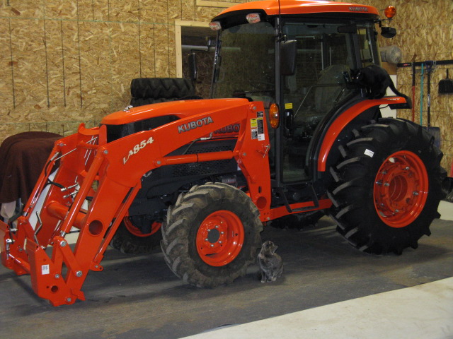

The FEL now has all the lines routed internally, exept for the 3rd function as shown.
And the night watch is ensuring all is safe and mouseproof.

The PB was by my request, and I do not know if it is OEM or a custom job by the wrench at the dealer.
(I had the BH from my 5030, a Rhino 85)
The first photo is the PB QA's and the jumper hose
The next photos show the block the dealer installed (also removing the starboard step)

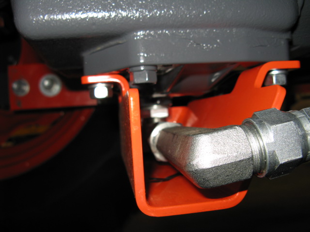

The next show one of the lines going from the block to a connection in the center rear of the tractor, a location guarded by a skid plate of some sort. (in the blue rectangle).
The next photo is looking down into that skid plate to where the line terminates.
This is all new to me and unlike anything I had on my 5030.
