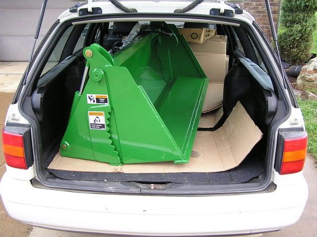

A couple of things I don't like on my 4 in 1 are: 1) No bolt on cutting edge on the bucket edge. 2) No bolt on cutting edge on the dozer edge.3) Needs a guard on the the back of the bucket where the hoses attach to the back of the bucket to protect the fittings. 4) Needs beefed up with some extra metal in a few areas.
I do like the jaws because they bypass each other and have nice serrations on them. Overall its a nice bucket. Just needs a few custom tweeks.
Here's the only good pic of the 4 in 1 I have. Not sure what changes they have made on the newer style.
Sincerely, Dirt
/ 4in1 size advice #5
Whoa... Dirt. Did you throw that into the car yourself?!? I'd like to see a pic of the guys that were on the front end of that.. :D
AKfish
/ 4in1 size advice #6
Folklift and a careful operator.
Sincerely, Dirt
