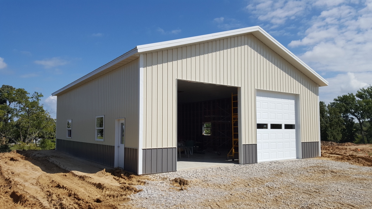

I'm so far behind on posting progress that I had to read back to my last pic..... Sorry.....
Here's a pic of the outside finished. I'll try to take more. For some strange reason I only have one....

Nice combination of colors. I might have forgotten, but what size is your garage doors? I don't seen an opener for them on the ceiling, is that coming or are you using something different? I'm kind of curious how you are doing that.

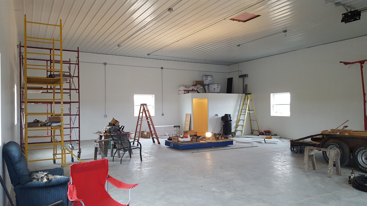

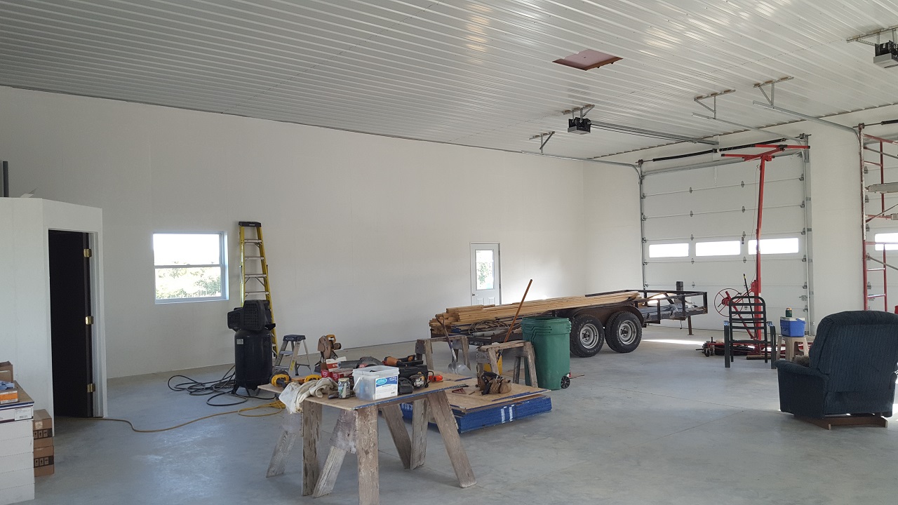

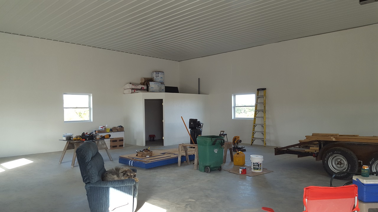

My best Buddy Don, who's like a Brother to me, pulled his camper trailer onsite and stayed for a month. He was invaluable help. He stayed thru the process of finishing the inside.
After we had hung the 1/2" OSB wall sheathing we caulked all of the splices that weren't tight. We had elevated the OSB 1/4" off the concrete floor for moisture protection and caulked that crack as well. Then we rolled on two coats of paint. Very time consuming but was worth it. Really brightened up the place.

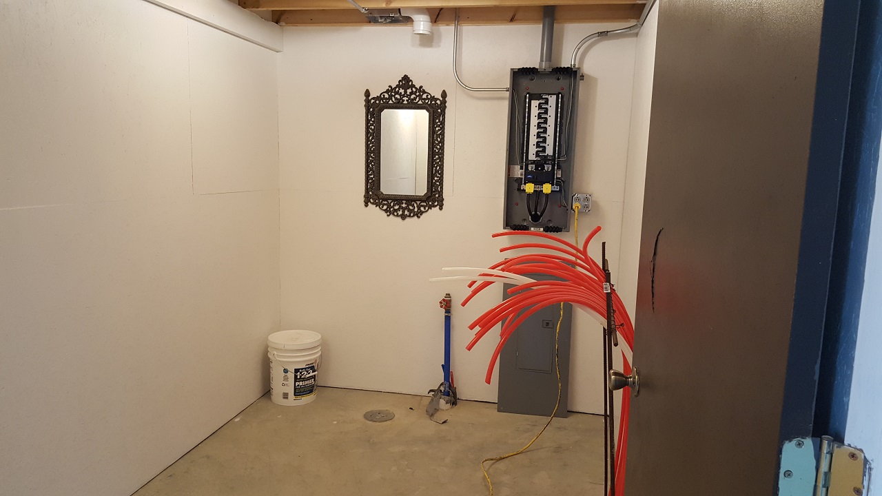

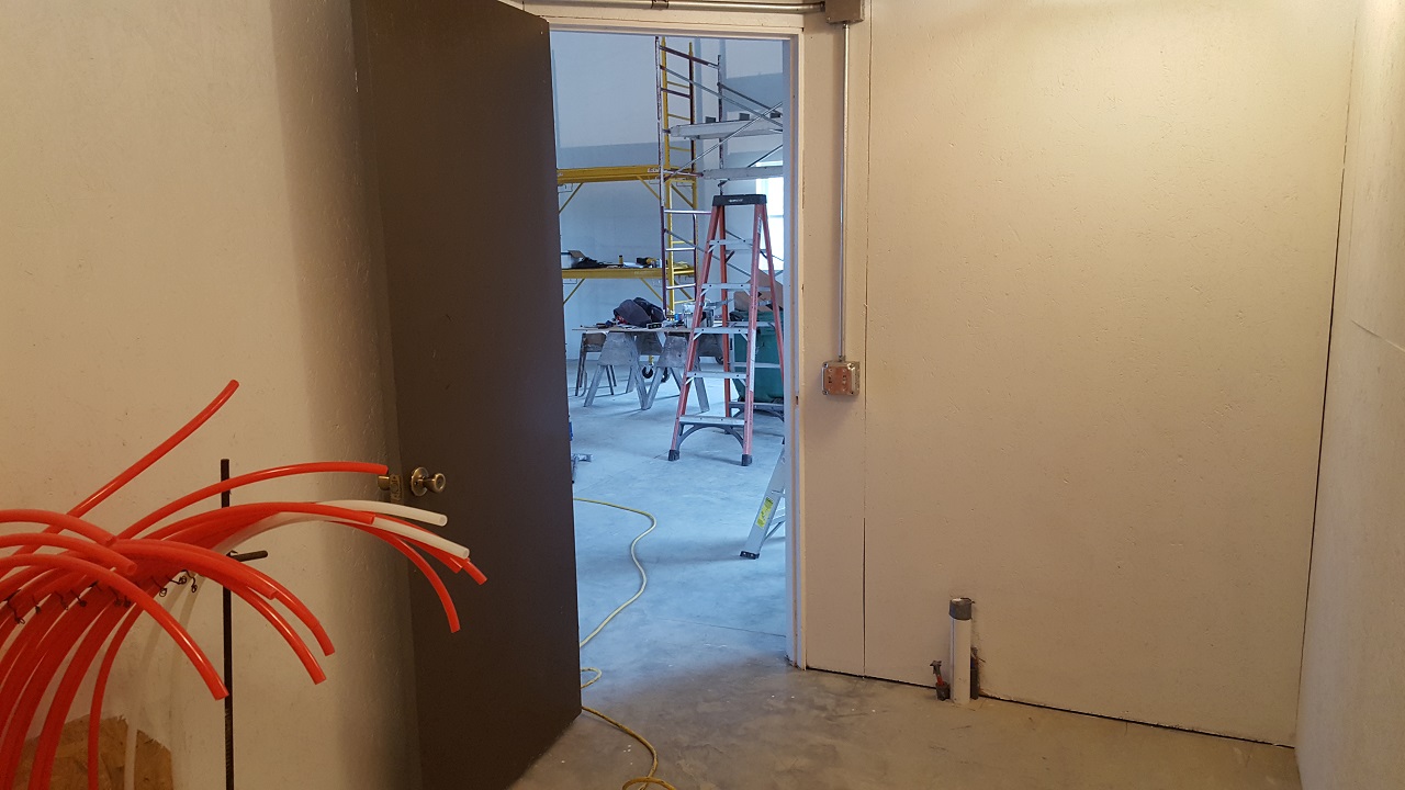

We built a 12'x7' bathroom in the corner. Built the ceiling at 7'. This left 7' of overhead room. Set the door at a 45 degree angle in the inward corner. Makes it easier to access and frees up wall space. Inside will be the normal stool, sink as well as the electrical panel, floor heat system and Air Compressor. I'll use an electrical small tankless heater for hot water at the sink. They fit under the sink taking up no space and provide an endless supply of hot water for hand washing etc. The bathroom is a bit cramped but I didn't want to lose anymore shop floor space than I had to. Built the room "bull" strong with studs on 16" centers. Ceiling joists are 2x6 also on 16" centers. I'll build storage shelves on the walls above the room with a retractable ladder access.
These pics are early on and I've not made much progress. I'll update them when I get it finished inside.

Then we started hanging conduit and running electrical. Used 1/2" for all the 110V stuff. 3/4" for the 220V stuff such as Welder plugs. Also used a wire trough above the bathroom with a 2" conduit going down thru the ceiling into the top of the panel. Then came out of the trough with conduit. I've added more since these pics were taken. I'll try to get some updated shots.
I'm not an electrician. I have a basic understanding of it all. Running conduit is also something I'm not experienced at.
Don and I spent a lot of time making drawings and trying to not miss anything. Had to run a circuit to the overhead doors. A circuit for the lights with 3 way switches at the two walk in doors. Additionally I added a 220V contactor at the Air Compressor plug in. This contactor is tripped by the overhead light circuit. Dusk/Dawn security light. Outside light over each walk in. A
Also ran 1 1/4" conduit with 2-2-4 wire from the trough to the opposite side of the building, LB box going thru the wall to another LB on the outside of the building, then down the exterior wall to buried conduit over to the machine shed next to the shop. This allows me to have adequate power in that building without needing a separate meter. My electric coop charges $30 per month just to have a meter. I currently have four. When the dust settles on this build and we move I'll be down to one.
Eddie, the doors are 12x12. The doors are insulated and lined with steel.
They each have Liftmaster trolley openers. I wanted torsion spring openers. Even went so far as to call Hormann about it. They discouraged it. Said they have had a lot of problems with the cables momentarily getting slack and tangling.
I have remotes for both openers. They too are Liftmaster. The range is completely unacceptable. If outside you actually have to walk up to the door and place the remote on the glass before they'll signal the doors to open. Went back to the distributor and they are sending an antenna extender kit. They claim the range will be measured in yards then. They said if it doesn't work satisfactorily I don't have to pay for the kit. If it fixes the problem I'll get a second one.
