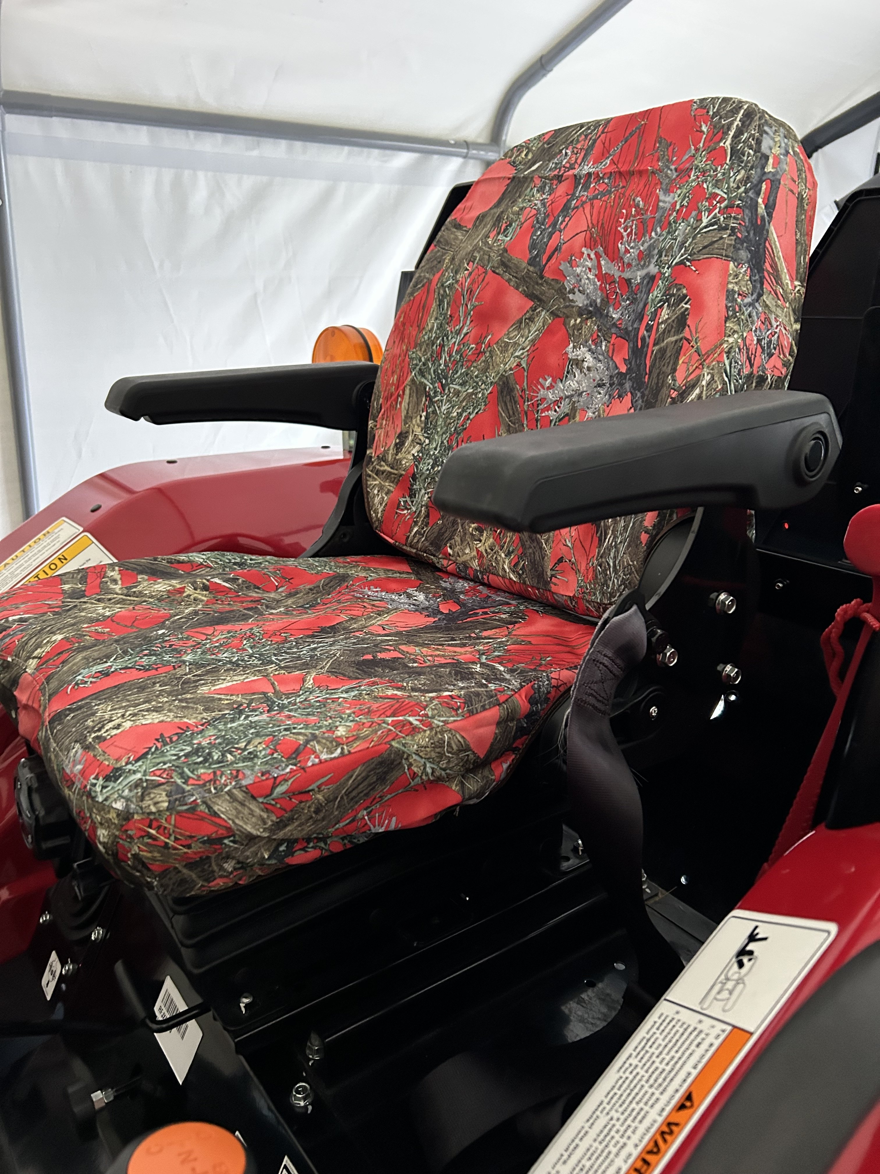

Anyone know if there is an armrest kit I can buy for a TYM 4820R? I checked tractor seat.com. Thanks
True, surely there is an armrest kit out there lol.I'm not sure if the seats are interchangeable. My 574 is a legacy TYM model, the 4820 is a legacy Branson model.
It would be handy if they are.

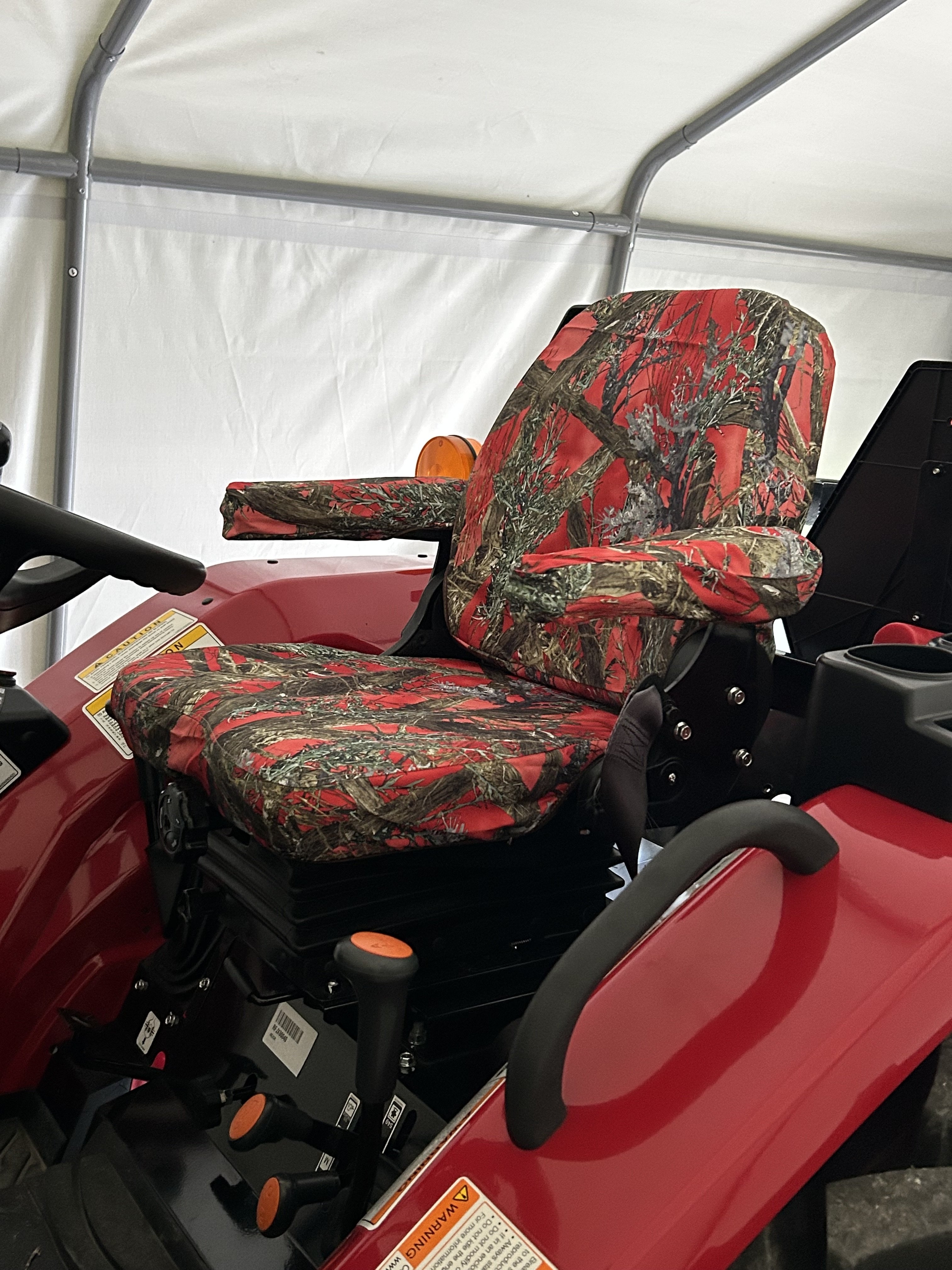

Thanks, I got it it from that durafit seat covers. It’s actually better than I thought it’d beVery cool, and the seat cover is snazzy!

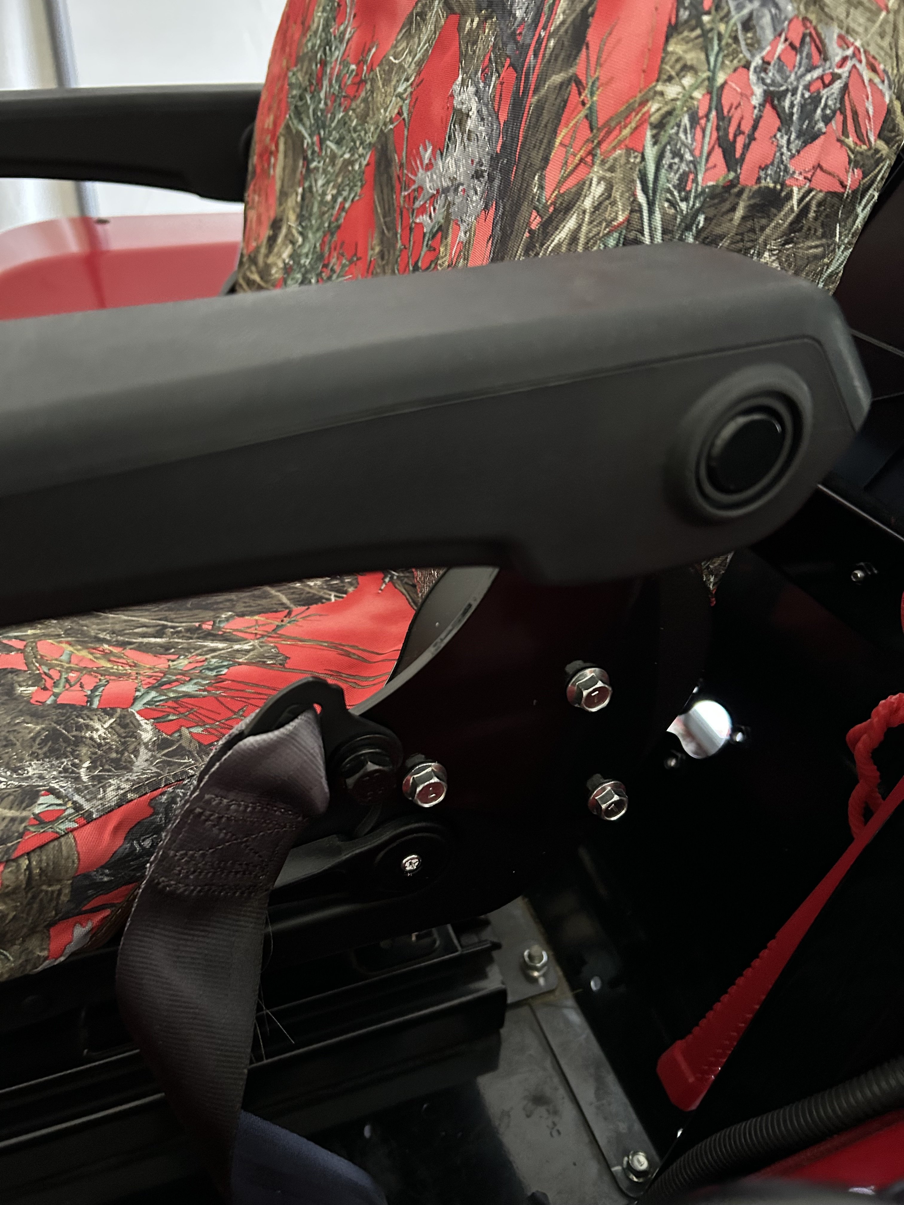

Just an update if anyone is ever interested and has a 4820R and wants armrests. The ones from an LS MT357 will fit perfectly. They have the same seat. Part number 40294820 and 40294821. They aren’t the cheapest and it was gambleThey fit perfect though.
They weren’t cheap, but worth every penny to me…lol. You use the same bolts that’s holding that plate/seatbelt on. Those bolts right in place. I can send you the parts manager’s email if you like. I did it buy email with him. It was an LS dealer in Iowa. The guy was great and easy to deal with. I’ll shoot you a message with it. It’s Koops Equipment is the name.Hey, those look great. Was all of the necessary mounting hardware included (so just those two part numbers were needed)?
Thanks for posting!
ps: if you have a good source to purchase these online, I'd appreciate a link...
gokoop.com
Awesome! I can’t begin to tell you how much research I didArmrests came in, and as promised, they were a perfect fit and a very easy install.
Thanks again Bootlegger. I don't know how you found that match, but it was a home run.![]()
