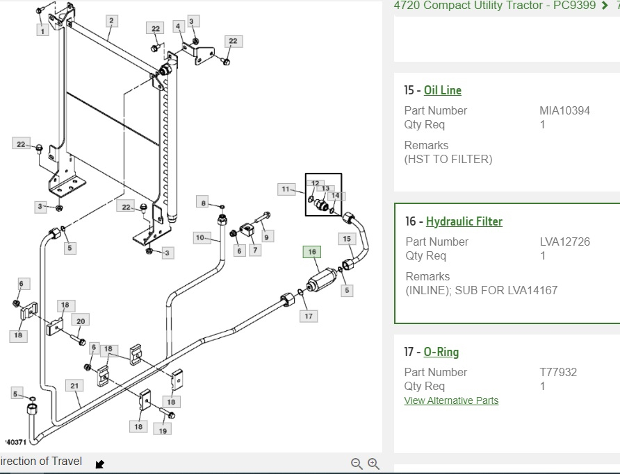

Is this the inline filter you are referring to here?
key # 16.
/ 4720 steering is jerky
That’s the one!

I didn’t have a chance to run the tractor long enough to really get it hot today. But, I’m sure I have improvement or maybe even complete success. I removed the screen from the filter housing and it didn’t have any gunk in it that I could see. However, the screen appeared to be sucked flat and collapsed. I opened it up carefully with a small screwdriver and punch. Cleaned everything and put it back together. The few minutes I was able to run it, there was no more jerkiness. The proof will come next time I give it a good workout. Thanks for the helpful tips!
/ 4720 steering is jerky #12
That’s great! There was another guy I remember had his collapse also. I don’t know how that happens, but I think I would replace it. The last thing you want is for that screen to start disintegrating. That would send fragments right into the hydrostatic transmission.
Just theorizing as to a possible reason for collapse…Since that line supplies charge flow to the eHydro system, I wonder if there are times when the hydro pulls a vacuum and the power steering pump can’t keep up with the charge flow. Maybe that causes that filter to collapse. Do you drive around at (or close to) idle sometimes? Maybe bumping the throttle up a bit would help. I like to have the engine running at around 1500rpm minimum.
