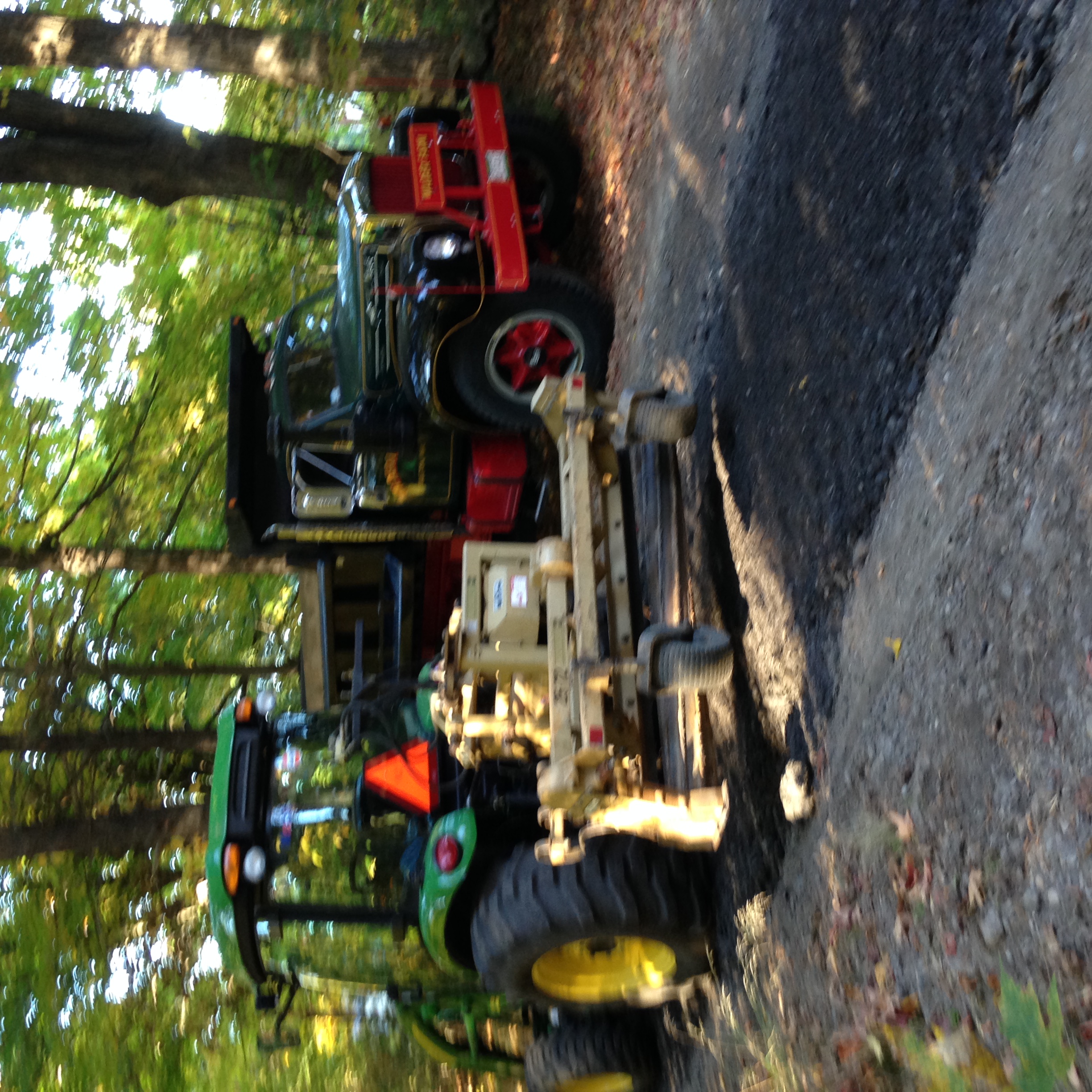

In any case, I have a 2007 4720 Cab, HYdro. As for its 58HP I have no complaints. Nor do I have anything to compare it to-other than my first compact was a 755, then I bought a 3320 whichI think was 35 HP so by comparison the 4720 is a beast. I have a 400X loader, a 48" Wildkat grapple, forks, and I plow snow with 6.5' Fisher with power angle. I also have a 72" Landpride Power Rake that I use to maintain a couple of neighborhood gravel driveways and a Valby PTO Chipper that does a gooe job on stuff up to 3". Tires are loaded R4's and I have a concrete weight block that I figure goes around 500 lbs.

/ 4720 HP #16
I have nothing to add about the tractor, but that dump truck sure is nice looking in that last picture Red Horse...
/ 4720 HP #17
/ 4720 HP #18
Thx- shows her years well- 1956
