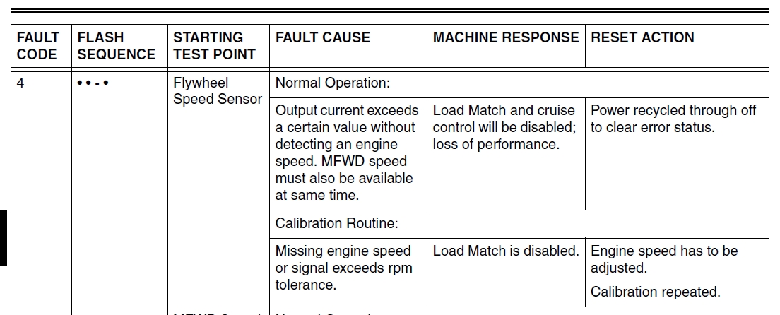

I have a 4710 Compact Utility tractor that has been flashing the following "Indicator Lamp Code" recently: Short, Short, Long, pause, Short.
Can anyone help me decipher what this code means?
It is not always on. Today it started after about 45 mins. of mowing. I had the Cruise Control on when it started and the Cruise Control stopped working.
Any help is greatly appreciated.

The fault codes work differently between the E-Hydro and Power Reverser. Your code description sounds like you have the E-Hydro. Shows as flywheel sensor problem, and sounds like it agrees with your stated problems.
